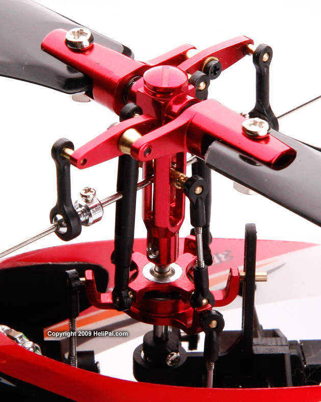

My bet would be that's the root of the vibration. I had similar problems with my AXE CPV3 after a good wreck. I had to remove and reset all the pitch links. Not sure how the head is on the Novus but it looks like something needs to be re adjusted.

All my linkage was a little off out the box but that one is way out just tighten it in to equal and check tracking and you should be fine also for a more in detail manual download the walkera 4g3 manual from walkera.com the china based sight it tells all there is to know about this heli good luck after a little fine tuning mine flys great

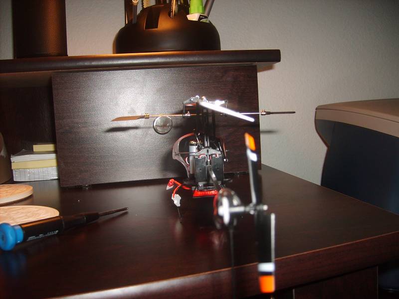

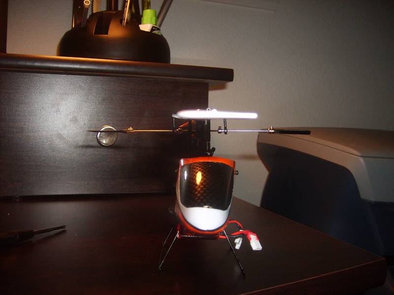

As far as your vibration is concerned, my first bet is that the Feathering Spindle is BENT since it is the weakest componet on the heli, or you need to track the blades! If the feathering spindle is bent, you can check it by removing the blades, insert a #0 phillips screwdriver into the blade grip and turn it, if you see that blade grip or the other move up & down or side to side, then the FS is bent (replace it).
To check/adjust blade tracking, first we need to know which blade is HIGH. If you have the stock foamies, they should have colored tape on the tips of the blades, carefully hold the heli by the battery tray & spin up the rotors, you should be able to see one blade tracking higher than the other (red or blue), whichever blade is HIGH is the one were after. We adjust the linkage that goes from the swashplate to the Bell-Hiller mixing arm, to adjust tracking. If the blade is high, shorten the likage. Then recheck your work!

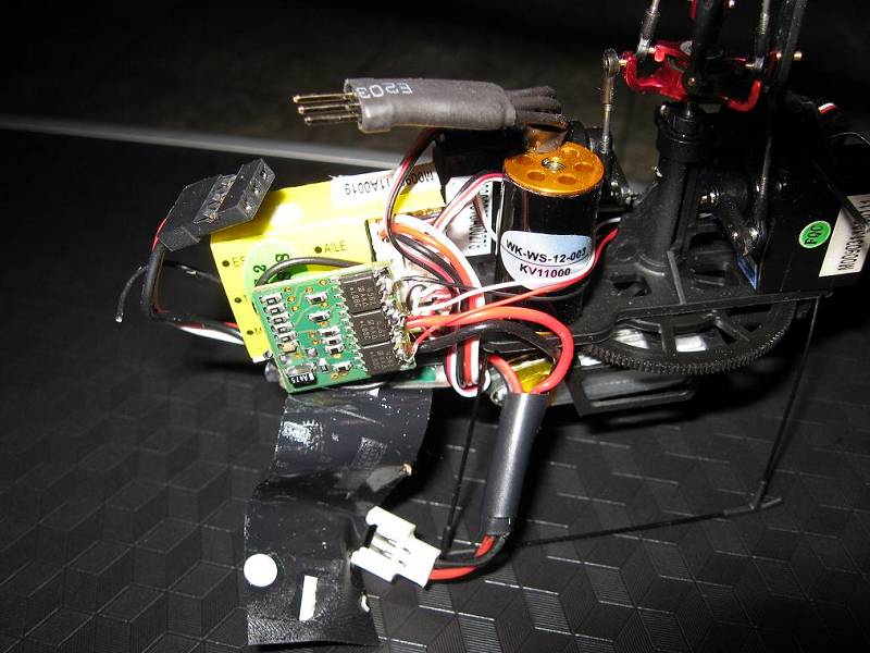

OK, well my is far from stock, but lets see...
I don't use the foamy stock blades (I run cut-down Gaui EP200 plastic blades & CF), but general rule with micro & nano sized helis states: they should be snug enough in the blade grips not to move freely, but not so loose that they fall. I set them so when I hold the heli 90 degrees to the side they stay, if I shake the heli they both slip about the same amount without colapsing in.
Also I'm running double BL motors, so my wiring will differ. The plug that goes into the battery will be a walkera 2 pole male micro connector, I believe it comes out of the 4in1 in the lower righthand side. On mine you'll notice 2 sets of wires wrapped with electrical tape (that the BL ESC & Flea BL tail ESC tied together). First pic is of stock 4in1 with BL main, second is of DBL BL set-up.
Shadow

Ok so I'm not plugging it directly into the RX box but the cord that comes out the bottom right. And also in the first picture it shows a wire to the ESC but i dont have a wire going there. And in my instrution book it tells me to plug the battery in and then turn on the radio do u think it will matter and if not I guess I will try it both ways.
And if that is it I guess i'll go try it out today.

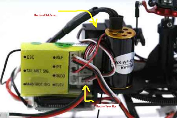

I recently went out and followed the binding proccess and after it i noticed that only 1 of the servos was twitching. It was the 1 toward the front of the heli. Other than this one sevo everything else "seems" to be working. I think i should just see about replacing the servo. Do you agree?

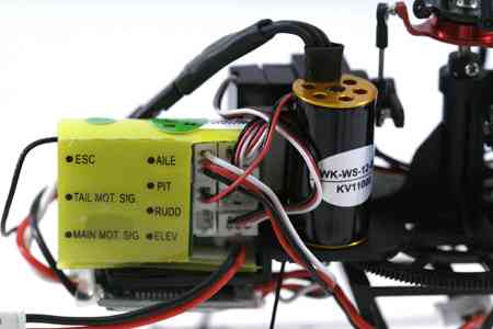

That would be the Elevator servo, it also controls the pitch of the blades too. Could be a bad connection at the RX, carefully unplug the servo lead from the RX & then plug it back in. If it still twitches, it's most likely bad, replace it.
Well if yours doesn't beep, remove the canopy, you should at least notice during the binding process that red LED on the RX flashes, then the servo reset & center themselves & the flashing goes to solid red LED. That says the TX & RX are bound, your good to go!
