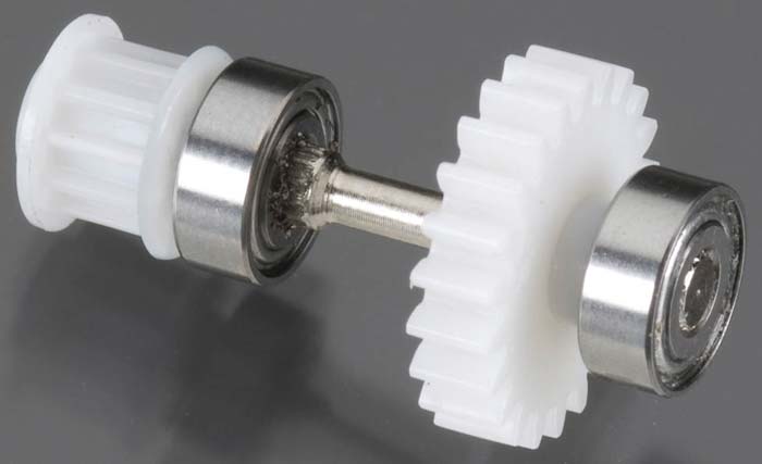

The belt tension seem adequate. Did some more checking and found that the Tail Rotor Belt Drive Gear (TRBDG) seems broken. The motor gear turns the bigger lower gear on the TRBDG. I can see the spindle turning going up to the smaller gear on the TRBDG, but the smaller gear isn't turning. Any thoughts?

The upper pully that has the belt attached is press fit onto the splined shaft. Probably a defective shaft as it is unlikely all molded splines in the pully would break off so cleanly that the shaft would turn smoothly.
Look at the enlarged photo below, you can see the splines just under the bearing. Here is the link to the part on Tower's Web site. Call tech support on Monday and they will fix you up. Or if you bought it at LHS, see if they have the part in stock.
http://www3.towerhobbies.com/cgi-bin...?&I=LXVPG8&P=Z

That sure sounds like a reasonable explanation. I just sent Tower a note I'm sure we'll get it worked out.
