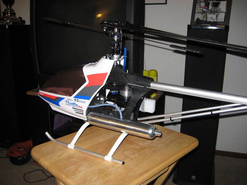

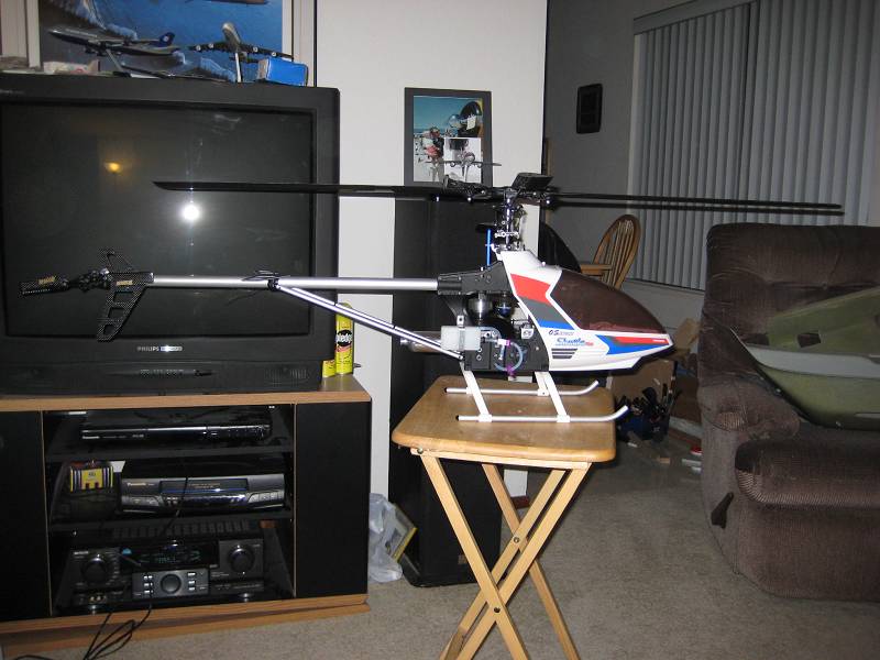

Just finished up my Shuttle Plus with a shiny new OS .37 engine. Heard lots of great things about the engine so I really wanted to give it a shot!
The only real issue I had was the need to cut a relief groove in the frame to clear the needle valve that sits lower in the frame. Its also interesting to note that the Plus cooling duct design is belled out a bit wider so that it fits around the head on the .37 and also the newer .32's. I noted the difference when I pulled the engine out of my ZX recently.
I ran the engine in with a couple of slobbering rich tanks, and could barely hold a hover at those settings but I wanted to make sure it was broken in right. The OS .37 manual says to just open the main needle a bit richer than "normal" then goes on to define "a bit richer" as 1 and one half turns from "normal" which is already one and one half turns. So three turns seemed a bit excessive but I went for it. Leaned progressively from 3 to 2 turns on successive tanks just to get it running a bit better. Never got the head temp above 100 F and the back plate was cool to the touch. Last weekend I started turning in the idle scew from the 1 turn in from flush recommendation. Started to clean up nicely, so this weekend I brought it back to around 1.5 turns on the main a few clicks at a time and 1.5 on the low end checking temps as I went. Still around 145 F and luke warm on the backplate.
During this whole time I noted performance to be slightly better than my finely tuned OS 32 but the fuel consumption was quite a bit higher . Well, the last few flights of the day got my tuning into the outer edge of the Sweet spot and that little beast came alive in about 3 clicks and a tweek on the low needle, still rich( nice smoke trail) but I now have a real good idea of the kind of performance this little gem is capable of. I had to go into my throttle curve and turn it down a couple percentage points from 50% to about 45% on the hover throttle in idle 1 and 2. The power was just amazing and I think there is gonna be a whole lot more where that came from. This is all on 15% Coolpower heli fuel, an A3 plug and Century Quiet power 3037 tuned muffler.
I'm not even up to operating temperature yet but its nice to know that fuel consumption is coming down to a bit more acceptable levels. I'm gonna leave it be for now and just let it break in nice and easy. The extra speed and climb I saw today has surpassed my OS .32 ZX by leaps and bounds. This is gonna be fun!
P.S. I did have a problem with my Carbon Fiber tail fin from Quick UK. Its sold for Shuttles as an upgrade but if you notice from the photo, its a bit short to protect the tail rotor from contacting the runway surface. I busted off an MS composite blade and blade holder during a landing in gusty conditions, as you might imagine the imbalance did not do good things for the rotor shaft and housing. My inquery as to why they sell a fin that is too short to do its job has gone unanswered as of this weekend. I held the same fin up to my ZX with stock tail rotor blades and its too short to protect them also.
