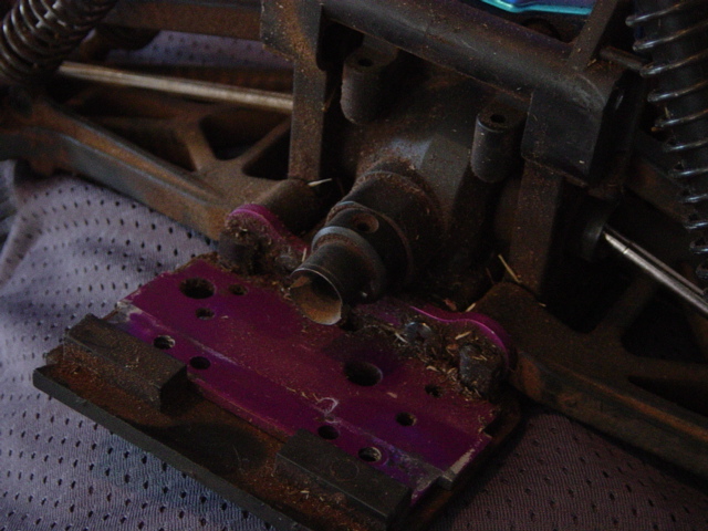

no, i am talking about the drive cups. the dogbones are inbetween them. heres a pic of a drive cup. they take a screw in the side.
Old 04-04-2004 | 01:01 PM
FiReD-uP's Avatar
Joined: Sep 2003
Posts: 204
From: De Pere, WI,
Default RE: Rear Diff Problem
sweet ill check it out and let everyone know whats up for some stupid reason i didnt even think of that.

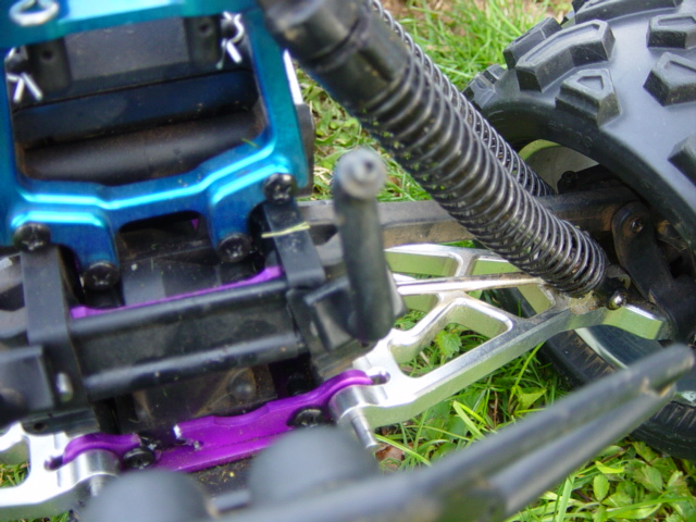

that should fix it. i got my front end apart right now, i wrecked[:@]. look at this thing

viz? did you bend your shock shaft?
i know you broke you bumper mount that sucks just fixed mine.
