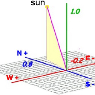

Hi,
to give you an example:
graphic by H.Wonner
0.8 -0.2 1.0 would be
