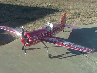

Hey, yes I did get through with it,flown it a couple times now. finally got the right size props in. still waiting for engine to break in a bit more. do most of my flying at half throttle. It would appear to have unlimited vertical. I haven't flown it hard yet, still trying to find the right set up, and I did a little owy on the last landing, I let it come in a little low at end of the run way and caught some tall grass, did a slow endo, cracked the top of the rudder, minor repair.
I'm going to borrow a friends camera to show how I changed the wings to plug ins, it would be much simpler and quicker. I haven't weighed it yet, it really doesn't feel like it will be over 12lbs. if that.
I'll holler back when I get some pics.

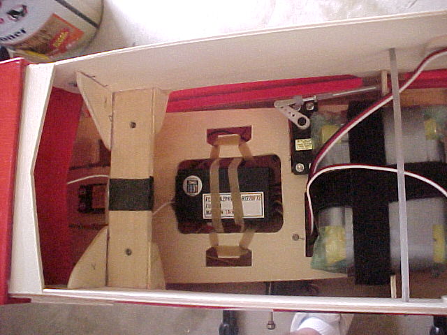

Hello Morepower
I finally got some pics.
Old 07-05-2002 | 09:14 PM
  #38
2lo
Posts: 291
From: west, TX
Default plugin wing
morepower
after cutting the wing back in half again, making a sander to fit the spar channel and sand out the left over epoxy and do some final finish in the wing for a good fit with the spar, I used the wing saddle to retain the incidence. after useing the left over light plie to build the mount area and used the wing retainer mount help in building locking tabs for the other pieces for the wing mount. I also went ahead and built the landing gear mount also. I just used all the existing lips inside the fuse to help strengthen and retain the fixtures.

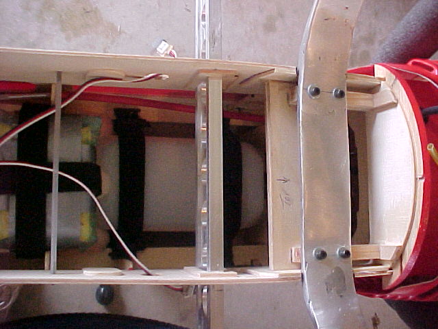

Old 07-05-2002 | 09:21 PM
  #39
2lo
Posts: 291
From: west, TX
Default plugin wings
Morepower
As you can see I have had to reinforce the landing gear, that was after building the new mount area, so it really held up well after wadding these up pretty good. I know, I know if you land them corectlly you won't have this problem, but I think I mentioned earlier that I caught some tall grass (the only grass within 5 miles and its at the end of our runway).

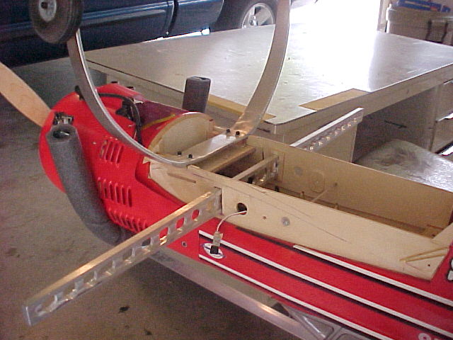

Old 07-05-2002 | 09:33 PM
  #40
2lo
Posts: 291
From: west, TX
Morepower
I'm sure there is alot I'm leaving out . so if you would like some more info or want some more pics I'll post them or e-mail you.
The spar I had made at a machine shop for about 15$ and 10$ for a piece of 3/8x36" aluminum. I measured the dimensions of the plans for inside the wings and added the width of the fuse to fit the spar. My wing span now is just a little over781/2 in.
holler back.
