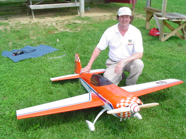

Thats now more than a bit interesting to me I did come in a bit rough but maybe it was the tall grass that made my GP Extra flip and break my new production style Bambula 22x8; that Mike Dooley V.P. of RC Showcase had 'personally' balanced for me. Gee......Guys and Gals is their a ritual or some thing when one looses his---first I.M.A.C. gasser prop?? [8D]
ID:	153714   Click image for larger version
