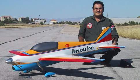

by the way this is my new pattern plane IMPULSE ...
happy and iyi inisler (landings)
oscar (ozgur)
