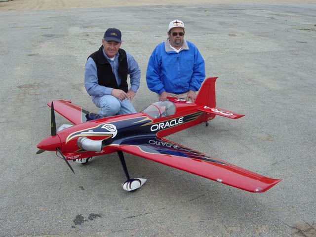

PS here is a picture of Wayne Hadley pilot of the Full size Raven and Bob Francis disigner of the Raven Kit prototype.

it is really nice made
