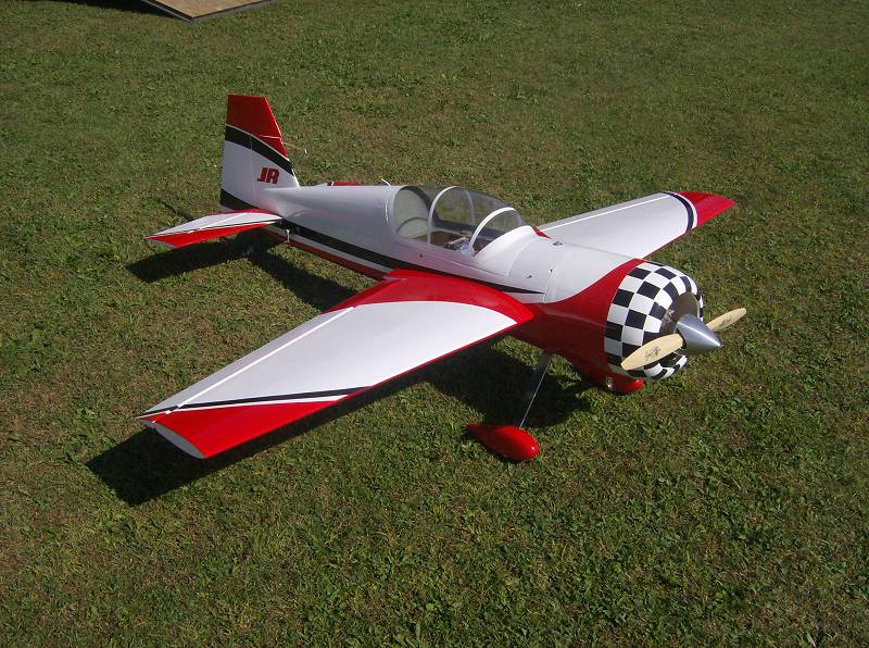

Can anyone tell me what kind of performace one can expect from a 3W 75 engine on a 25-10 or a 26-10 prop. I might pick up a used combo from a friend and want to know what I might expect performace wise. It is going in a Giles 202
The plane is a Lanier kit 95" WS and was flying on a converted 80 weedeater engine and weighed in at about 22 lbs. Would the 3w 75 be a good engine for this bird. Just not familiar with this size engine class. If not what might be a good airframe for this engine. Thanks in advance.

I have a 3W75US in a 23lb 33% Laser 200. It's swinging a 26x10 Menz prop. It will rip the prop when it is a touch over 3/4 thottle. It hovers a click over 1/4 throttle and the pull out is ballistic. It dosen't lack for power. It only has 5 gal. of fuel through it and it keeps getting stronger. I'm going to put it in the new Hanger9 Suhkoi instead of DA85, for it only weighs 4oz. more.

On the EF Yak 88', I have never needed more than the 5HP provided by the DA. I have seen many people using that engine, the DL50 or the Brillelli 366. Have not seen one mounted with a 3W. I would be interested in the performance and weight they get - what prop is used, what rpm they get, etc.
On the 35% Extra (AW or similar at 26lbs.), I have never needed more than a DA-100 to get unlimited vertical. I initially mounted a BME 110 but opted against for balance reasons and the possible lack of support...
