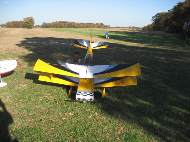

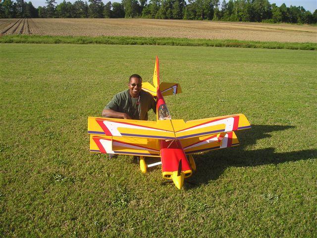

I have 3 Ultimate’s and it does take a little bit of differences in setting up Bipes since you have 2 wings and 4 ailerons to check to see that all of them are going up and down the same amount. Same as a mono is to make sure it has the correct up thrust, right thrust, and CG is the same for any bird. Most Ultimate need and also are designed with up thrust in the tail and different kits will carry different amounts on each wing that need to be checked. The rest is fly it and adjust as needed if your also run mixes as with any bird….and need it talk at you
My Feedback: (31)
Soarrich I do what the maker says from here I do the regular adjusting to suit a true tracking bird.
My Bob Godrey Ultmate carrys O on the bottom and the top wing is set correct by the straps that hold the top wing
The Hanger 9 Ultimate carrries -1 on the top and O on the bottom
Both Ultimates carry 2 degrees of postive thrust on the stabs ( the front of the stab is raised)
Both carry about 2 degrees of up thrust for true hands off up lines
Both carry about 2.5 to 3.25 of right thrust
Both planes have 4 servoes on the ailerons and I have to 8-32 bolts and radio trim numbers to have all four ailerons moving at the same degree on both up and down ailerons on all rates low and med and 3d or how ever you set your up.
10-12 on my low rates elevator
20 on low rates ailerons
20-25 low rate rudder
I do not fly a med rates on elevator only rudder and ailerons until i figuure which one fits my needs....

The neg. incidence in the top is so the bottom wing stalls before the top one on landings or spin entries. This turns the plane into a high wing trainer just before the moment of full stall. This feature remains the same when it's inverted, the top wing (now located as the lowest wing) will now have + 1 degrees in it, allowing it to stall first and leave you flying off the highest wing just before full stall. This is a safety feature for full scale and for sport pilots. However this feature may not be favorable for all attitudes of the plane. Kitting companies put this in the design just incase the builder is slighty of in the construction of the plane. First flights are protected. First landings are protected from tip stall also. For Imac Basic I'd suggest following this, and it won't hurt your flight. As you move up in class, you'll want to have both wings at zero zero.
My Carden Cap flew with 1.0 positive inc. in the stabs. I had three of these, they all needed +1.0 in the stab to get the elevators to line up with the stabs once it's trimmed out. Don't put this in your bipe just because you read it here. Fly and see where the elevators are resting after you like your thrust (engine thrust) and CG. Then move the stabs to line up with the elevators if need.
