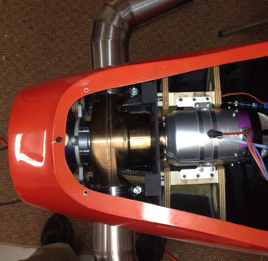

Can you guys tell me how you are connecting your exhaust pipes to the turbine. I have a set of Tam's pipes and I'm not sure of the best way to connect them.
Larry
Larry
I'm not sure about others, but if the "fit" is tight enough, a clamp works great. I did add 2 small screws to prevent any movement in any direction or from coming off in case it loosened up. You can see the one screw in the pic, the other is around near the clamping screw. I think this pic was taken before the second one was put in place.

Larry,
I drilled and tapped mine for 4-40 bolts in four places. Very strong and secure.
Mike Haddox

Originally Posted by Mike Haddox
Larry,
Mike Haddox
Yes, that is a great method, BUT only if you have access, which I do not.

Mike and George....thank you for the info.
George...I like the clamping idea. What type of clamps are you using?
Old 09-22-2014 | 04:26 AM
My Feedback: (57)
Posts: 3,069
Received 12 Likes on 11 Posts
From: Va Beach, VA
They are just regular hose clamps from the auto parts store. I can't remember the size, but around 2"-2.5". Just make sure your pipes are a "snug" fit around the turbine outlets. If they are Tam's and were built for the SPT5, then they should be a good fit.

Make sure they are clamps that can stand temperature. Did use some regular clamps in mine at first and after a couple of flights, they were done. The changed to ones than can stand high temperatures and never a problem again. I just make sure after a couple of flights that they are still tight by trying to move them a little bit. If they move, just tight them back a little bit.

Yeah, my clamps are pretty "beefy" and not thin cheap metal. I have 7 flights on mine before the gearbox issue; and the clamps were holding good.
