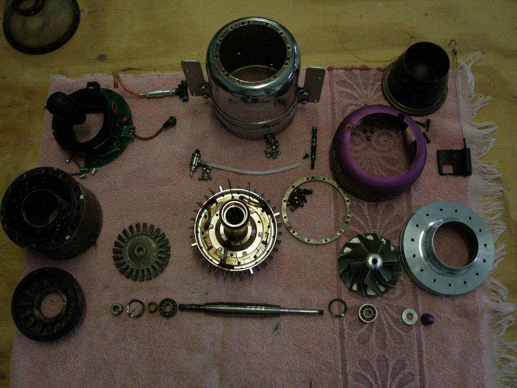

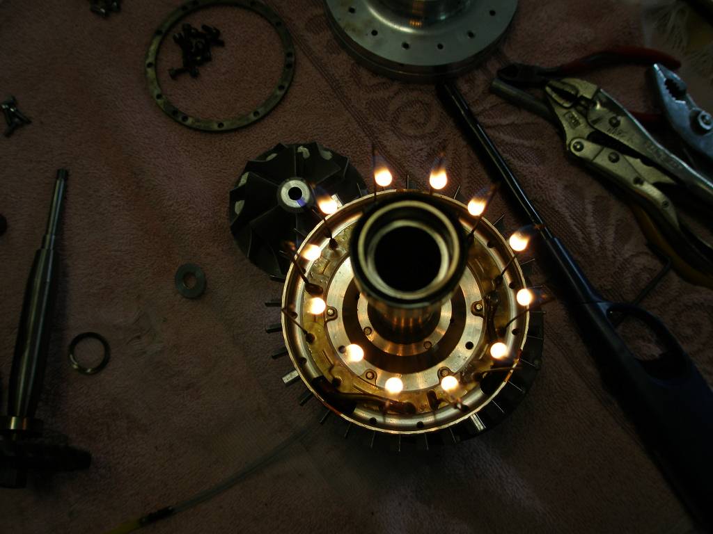

I did a search of this forum using the words "surging" and "popping" because my Titan SE is doing just that on acceleration. Come to find out that seems to be a very common problem with these engines (but nobody has had an answer that I could find). It has mostly been an unpleasant inconvenience because it just happened on the ground. But today, after a gear pass I throttled up to finish my landing pattern and instead of the thrust I needed I got a bunch of surging and popping and a totally hung acceleration. I was VERY lucky to get it back on the ground in one piece. It has flamed out on the ground under these very same circumstances
Several important facts:
EDIT: I've already set "very slow" in the ECU for low throttle ramp time.
It's very hot and humid here.
I inspected the internals of this engine last week and found everything looked fine, including a flow check of the fuel manifold.
If accelerated VERY slowly to midrange, from there it will accel and run fine.
Starts great and puts out tons of power.
I really need help to figure this out because as of now I can NOT use this engine to power an aircraft.

Ok, this may help or likely not.</p>
Back in the early days of the P-70, I had a similar problem.  Even had a flame out on the ground during takeoff at a meet because of it.  I was told by JetCat the problem was caused by the fuel needles not being shaped correctly and/or positioned incorrectly.  They thought it wouldn't happen in the air but it did and so does a P-120SE I'm flying now.</p>
John Redman eventually fixed the engine (when I got around to sending it in) by re-bending the needles and such.  Don't know the specifics but since he owns the place now, you might call and discuss your problem with him.</p>

Does anyone have a picture of how the fuel needle are suppose to look. This thing popped on acceleration from day one. I called them and some kid said that was normal and they couldn't do anything about it. Unfroturnatly it was purchased 4 years ago and it has been sitting till now. It has 39 minutes run time since new.
Old 08-20-2013 | 08:08 PM
Thud_Driver's Avatar
Posts: 1,669
Received 9 Likes on 7 Posts
From: Victorville, CA,
There's a pic in the first post but it might not help much for shaping and position.
