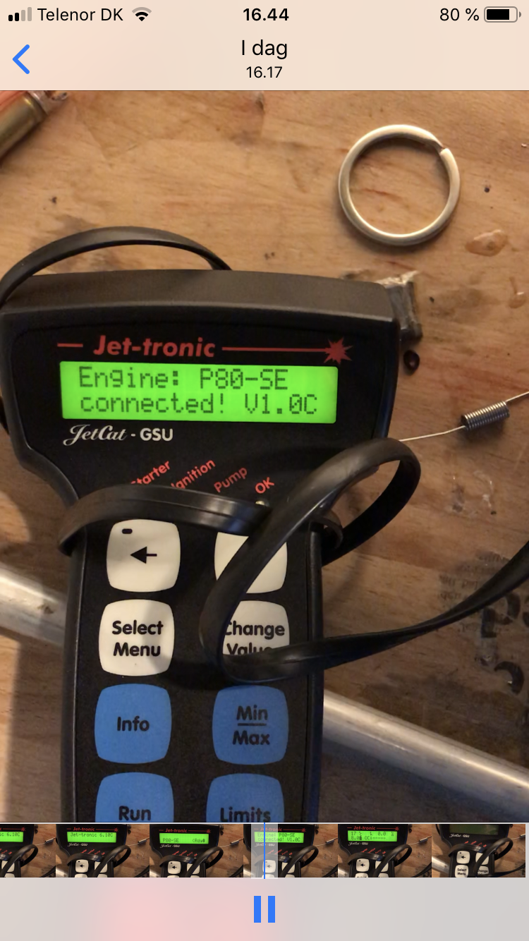

Dears all
Do you know if an ECU V6.10c would work with the JetCat ECU telemetry adapter? The manual says V6.3s is required, and I guess that 6.10 is older than 6.3.
Is it possible to update firmware myself?
The power up screen shows two numbers:
6.10c and 1.0c

Default Answer
Well, 6.10 is indeed older than 6.3, as it should be, numerically counting. So jetcat adapter is no-go, unless JetCat upgrades firmware. But I would hate to loose my 125.000 rpm max settings on my P80SE, after an upgrade.
I bought a VSpeak instead 😊
