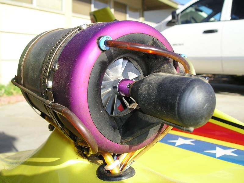

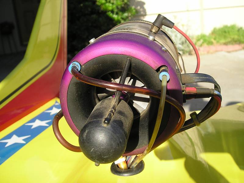

I have several thousand flights on California's dry lakebeds in the dust and dirt. If your engine looks better than this P-70, which survived this kind of abuse for hundreds of flights, you're good to go.
I took these pics a long time ago when this sort of question came up once before. The engine in the photo had about 100 hours on it then and about 220 hours on it now. The usual fine dust, dirt and light sand that goes thru the FOD guard into the engine isn't going to hurt it. The bearings are protected so they're not going to see any of that stuff.
