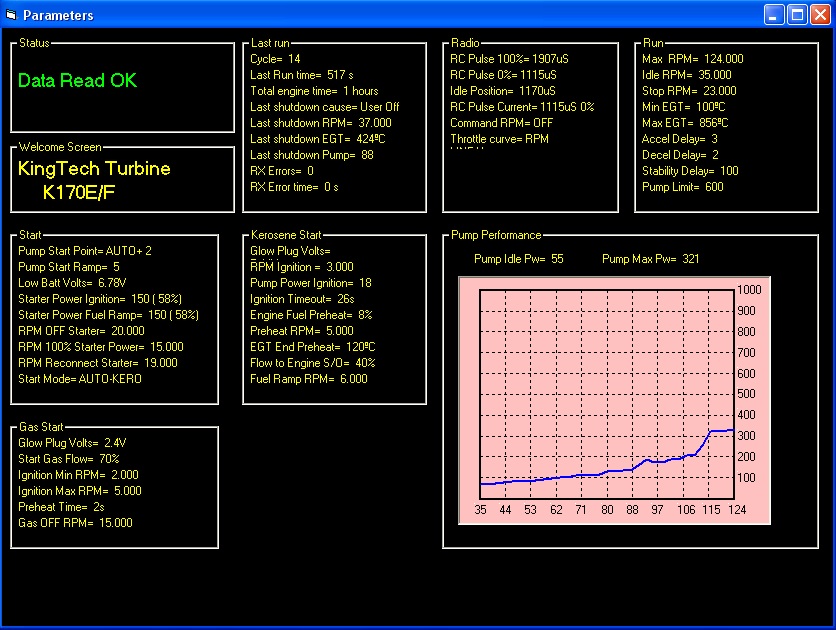

REFERENCE SETTING K-170-F
Joined: Aug 2010
Posts: 65
From: AIX-EN-PROVENCE, FRANCE
KINGTECH K170-F<span style="white-space: pre; " class="Apple-tab-span"> </span><div><span style="white-space
re" class="Apple-tab-span"> </span></div><div>Factory Menu Start :
</div><div>Auto +2<span style="white-space
re" class="Apple-tab-span"> </span></div><div>Pump Start Ramp<span style="white-space
re" class="Apple-tab-span"> </span>5</div><div>Glow Power<span style="white-space
re" class="Apple-tab-span"> </span>7,4V</div><div>Low Batt<span style="white-space
re" class="Apple-tab-span"> </span>7V</div><div>Start Power Ignit<span style="white-space
re" class="Apple-tab-span"> </span>150</div><div>Starter Power Fuel Ramp<span style="white-space
re" class="Apple-tab-span"> </span>150</div><div>RPM 100% Starter<span style="white-space
re" class="Apple-tab-span"> </span>16000</div><div>RPM Stop<span style="white-space
re" class="Apple-tab-span"> </span>19000</div><div>RPM Reconnect<span style="white-space
re" class="Apple-tab-span"> </span>18000</div><div>RPM Ignition<span style="white-space
re" class="Apple-tab-span"> </span>5000</div><div>Pump PW Ignition<span style="white-space
re" class="Apple-tab-span"> </span>18</div><div>Engine Min Flow<span style="white-space
re" class="Apple-tab-span"> </span>30%</div><div>EGT End<span style="white-space
re" class="Apple-tab-span"> </span>120°C</div><div>RPM Preheat K<span style="white-space
re" class="Apple-tab-span"> </span>5000</div><div>RPM Fuel Ramp<span style="white-space
re" class="Apple-tab-span"> </span>5000</div><div>Preheat Fuel<span style="white-space
re" class="Apple-tab-span"> </span>45%</div><div>Ignit Time Out<span style="white-space
re" class="Apple-tab-span"> </span>27s</div><div>Start Mode<span style="white-space
re" class="Apple-tab-span"> </span>AUTO KERO
<div>Factory Menu Run<span style="white-space
re" class="Apple-tab-span"> </span>:</div><div><span style="white-space
re" class="Apple-tab-span"> </span></div><div>Full Power<span style="white-space
re" class="Apple-tab-span"> </span>123000</div><div>Idle SPeed<span style="white-space
re" class="Apple-tab-span"> </span>34000</div><div>Stop Peed<span style="white-space
re" class="Apple-tab-span"> </span>20000</div><div>Start Min<span style="white-space
re" class="Apple-tab-span"> </span>100°c</div><div>Max temp<span style="white-space
re" class="Apple-tab-span"> </span>840°C</div><div>ACC DELAY<span style="white-space
re" class="Apple-tab-span"> </span>7 (<span style="background-color: rgb(251, 252, 255); font-family: Verdana, Arial; font-size: 13px; ">possible without any problems to low as 4, even lower depending the elevation)</span></div><div>DEC DELAY<span style="white-space
re" class="Apple-tab-span"> </span>4</div><div>Stability Delay<span style="white-space
re" class="Apple-tab-span"> </span>100</div><div>Pump Limit<span style="white-space
re" class="Apple-tab-span"> </span>600
Review Data :
<div>
Menu Start :
re" class="Apple-tab-span"> </span>15000</div><div>RPM Stop<span style="white-space
re" class="Apple-tab-span"> </span>20000</div><div>RPM Reconnect<span style="white-space
re" class="Apple-tab-span"> </span>19000</div><div>RPM Ignition<span style="white-space
re" class="Apple-tab-span"> </span>3000</div><div>Pump PW Ignition<span style="white-space
re" class="Apple-tab-span"> </span>17</div><div>Engine Min Flow<span style="white-space
re" class="Apple-tab-span"> </span>6000</div><div>Preheat Fuel<span style="white-space
re" class="Apple-tab-span"> </span>30%</div><div>Ignit Time Out<span style="white-space
re" class="Apple-tab-span"> </span>27s</div>Start Mode<span style="white-space
re" class="Apple-tab-span"> </span>34000</div><div>Stop SPeed<span style="white-space
re" class="Apple-tab-span"> </span>840°C</div><div>ACC DELAY <span style="white-space
re" class="Apple-tab-span"> </span>4</div><div>DEC DELAY<span style="white-space
re" class="Apple-tab-span"> </span>100</div>Pump Limit<span style="white-space
</div></div>
re" class="Apple-tab-span"> </span></div><div>Factory Menu Start :<span style="white-space
re" class="Apple-tab-span"> </span></div><div>Auto +2<span style="white-space
re" class="Apple-tab-span"> </span>AUTO KERO<div>Factory Menu Run<span style="white-space
re" class="Apple-tab-span"> </span>600Review Data :
<div>
Menu Start :
re" class="Apple-tab-span"> </span>600</div></div>

Guys
what do you think about this data :<div style="font-family: Verdana, Arial; font-size: 13px; "></div><div style="font-family: Verdana, Arial; font-size: 13px; ">RPM Ignition<span class="Apple-tab-span" style="white-space: pre; "> </span>5000</div><div style="font-family: Verdana, Arial; font-size: 13px; ">RPM Preheat K<span class="Apple-tab-span" style="white-space: pre; "> </span>5000</div><span style="font-family: Verdana, Arial; font-size: 13px; ">RPM Fuel Ramp</span><span class="Apple-tab-span" style="font-family: Verdana, Arial; font-size: 13px; white-space: pre; "> </span><span style="font-family: Verdana, Arial; font-size: 13px; ">5000</span>
Strange no?<br type="_moz" />

Does somebody can compare his K170F setting with mine?
Regards
hello
Regards

I found with the decreased Acceleration delay (4) it actually seemed at certain points during a quick acceleration to be pumping slightly too much fuel in. I am at sea level, and it was running on a test bench, otherwise mine ran fine on those settings.
I'm at less then 300' ASL and have acceleration delay set at 3 with no problems. i've had it as low as 1 but got some sputter during high speed spooling in flight, no problems at all at low speed/bench test.

this is all i've got handy on mine at the moment........

Any suggestions?
