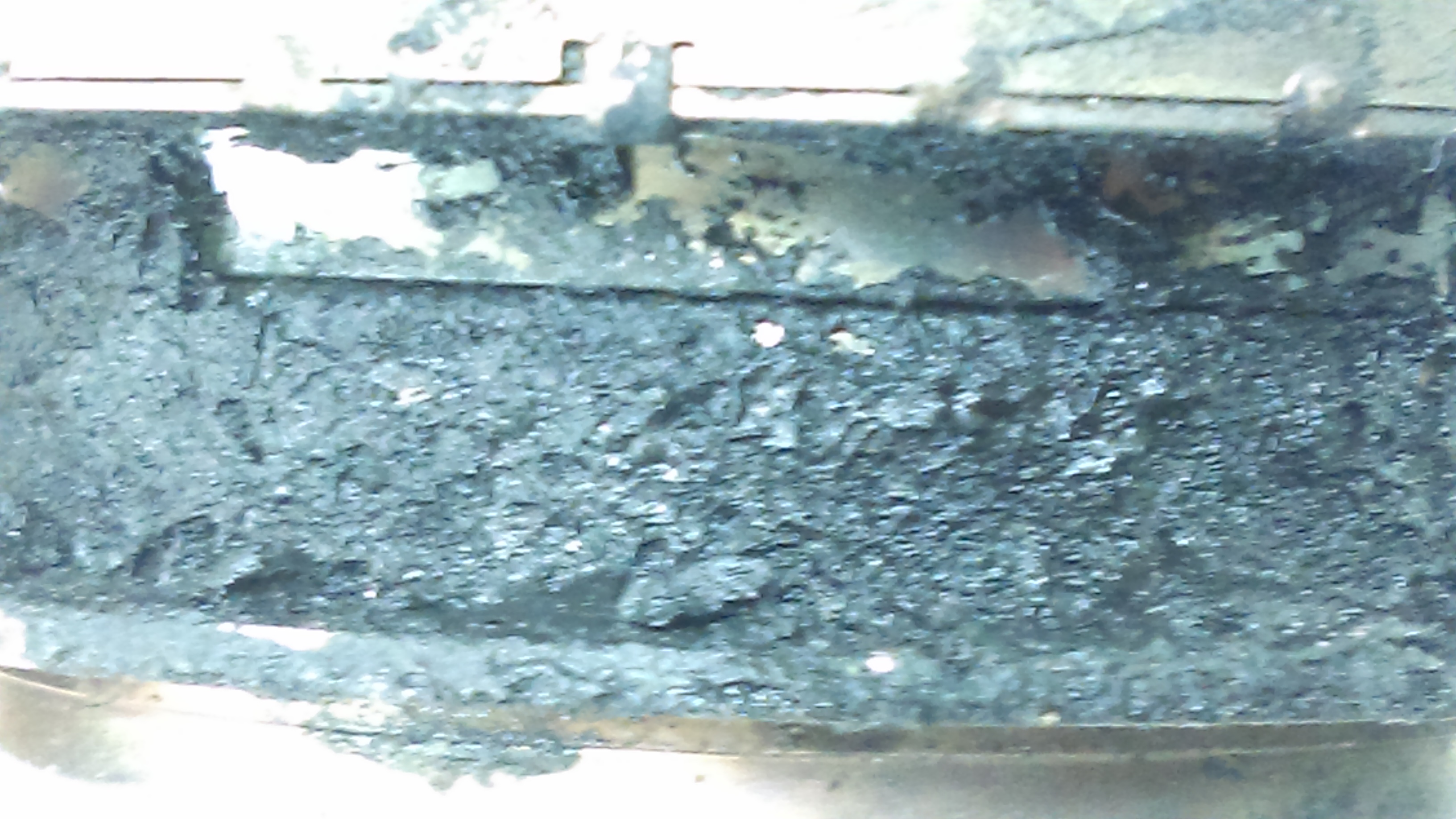

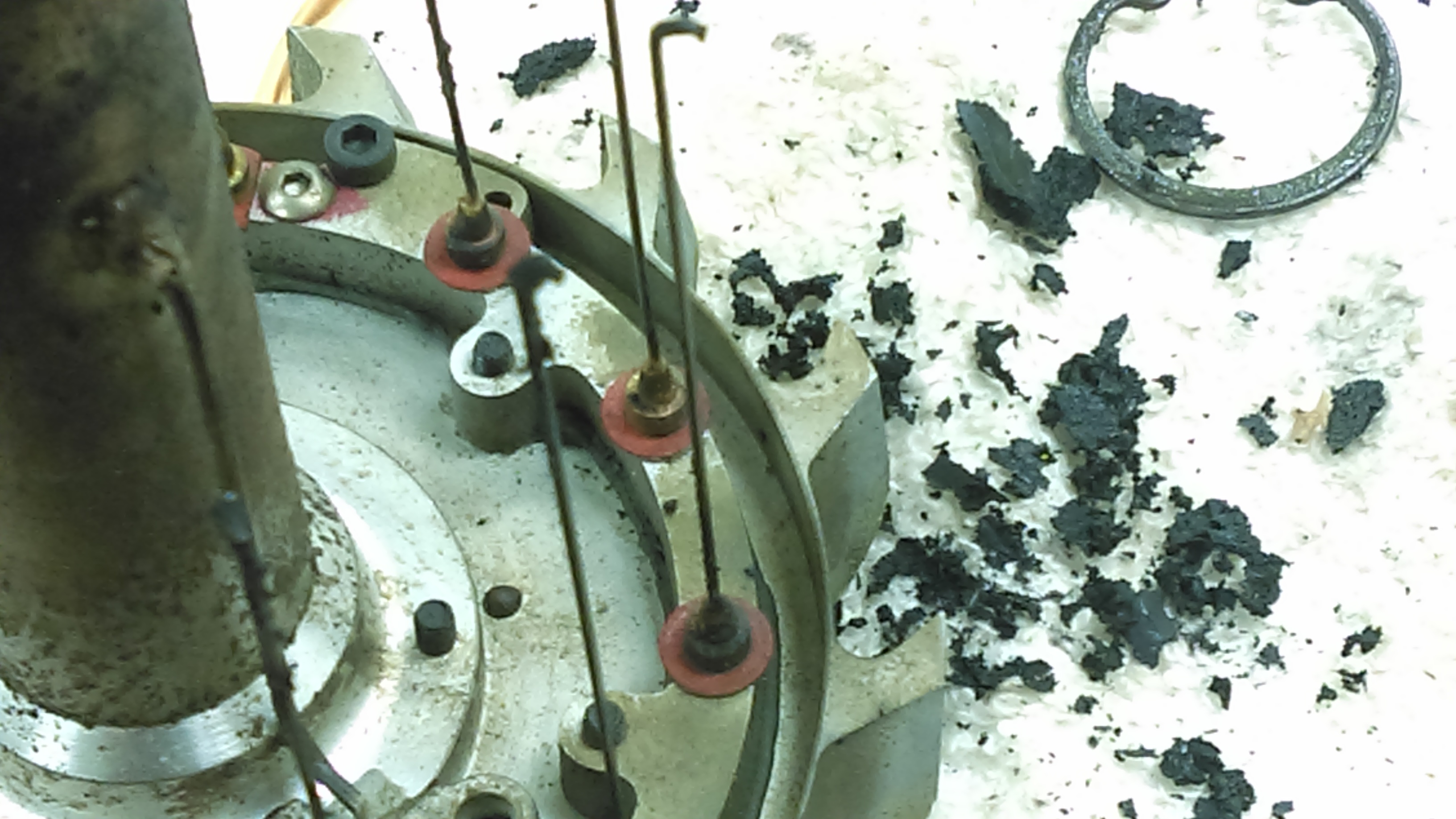

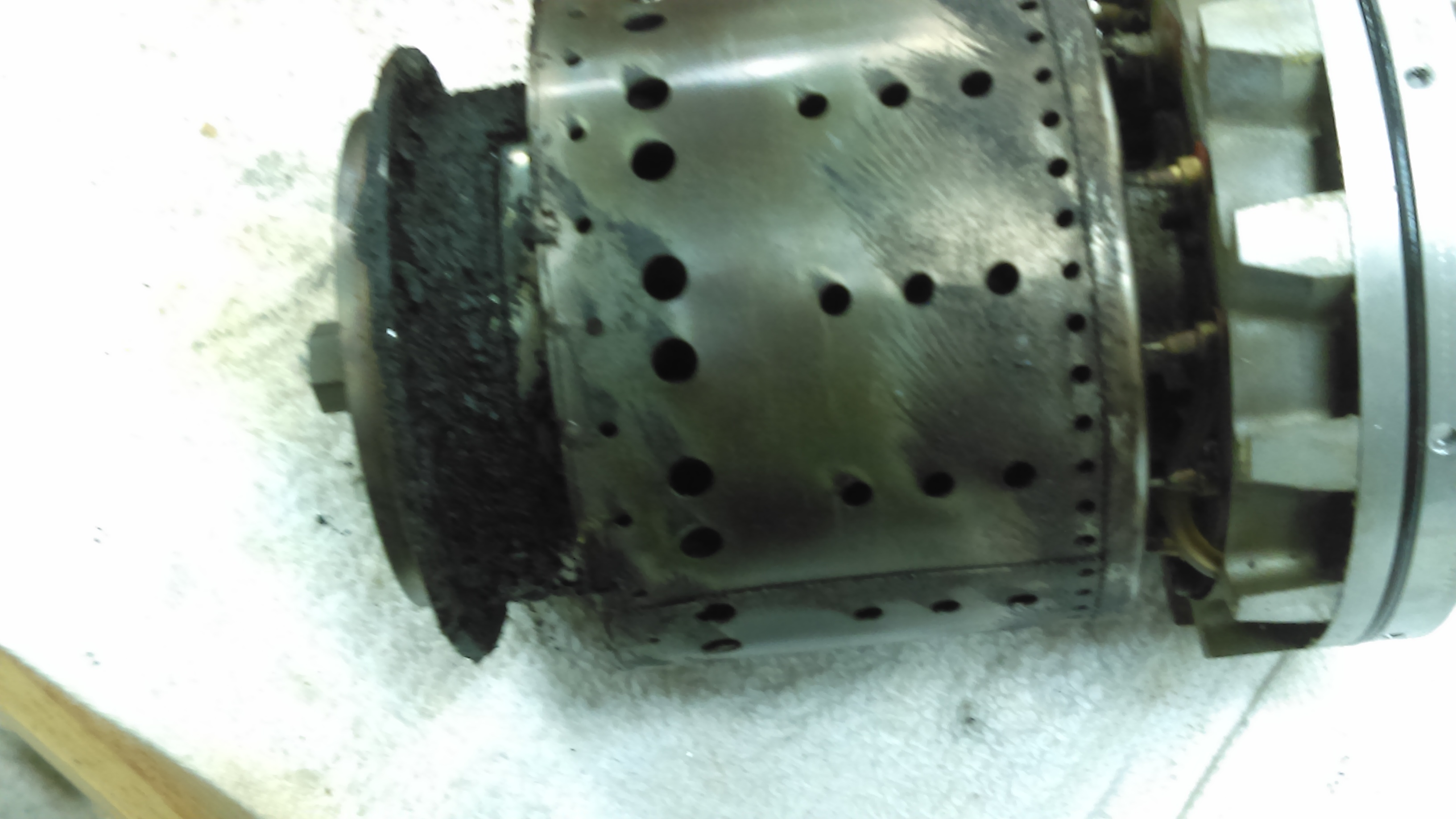

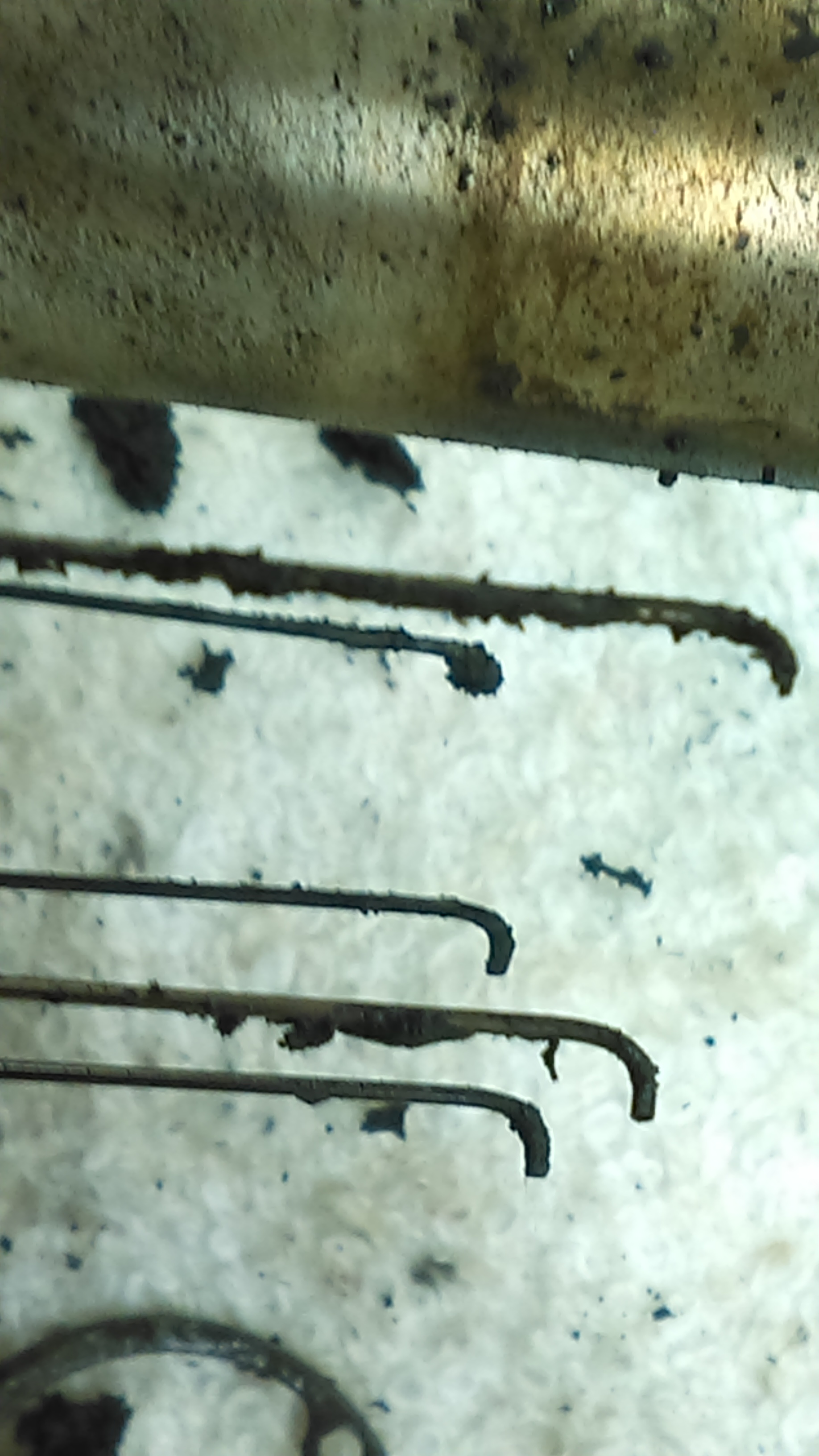

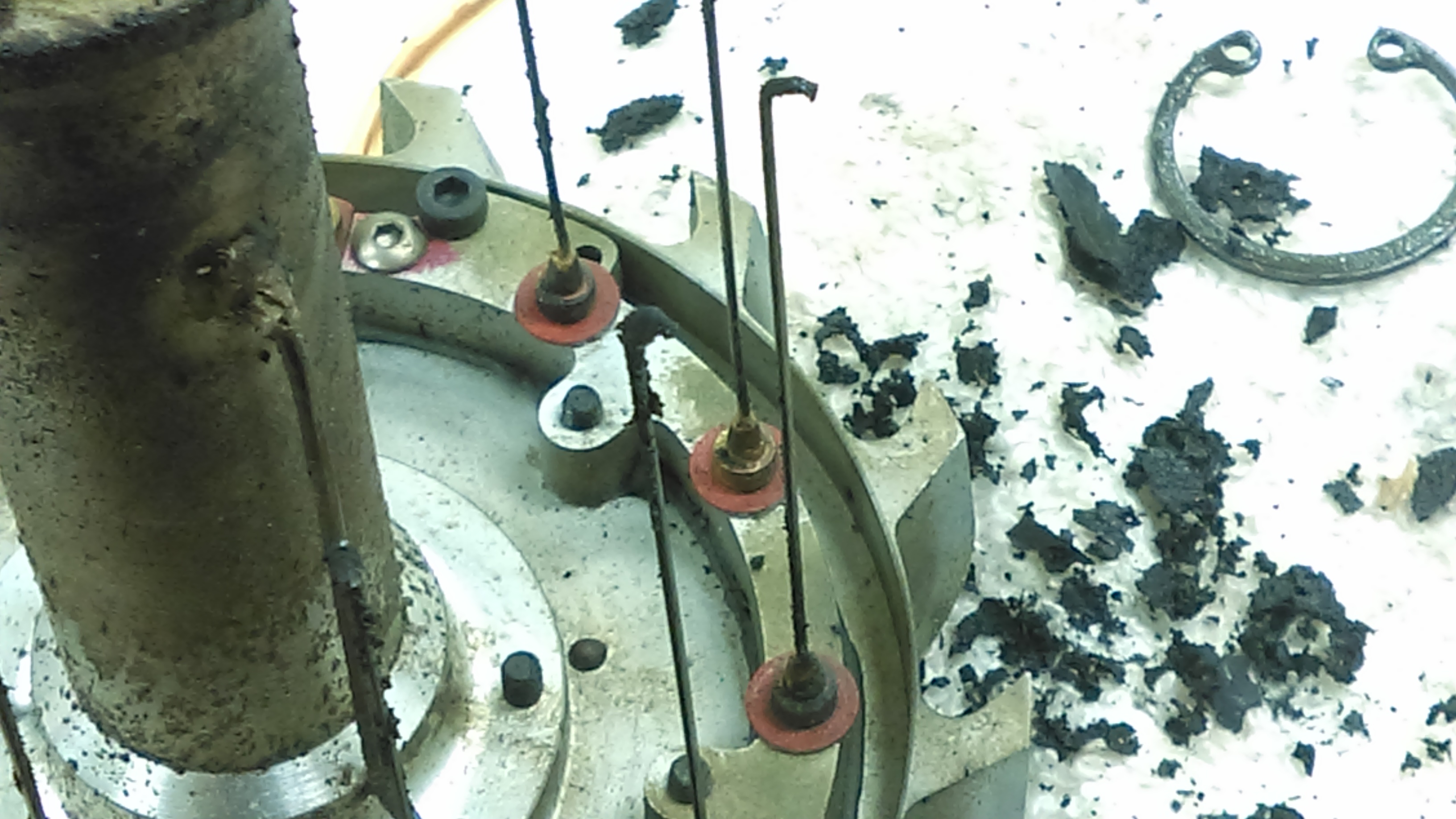

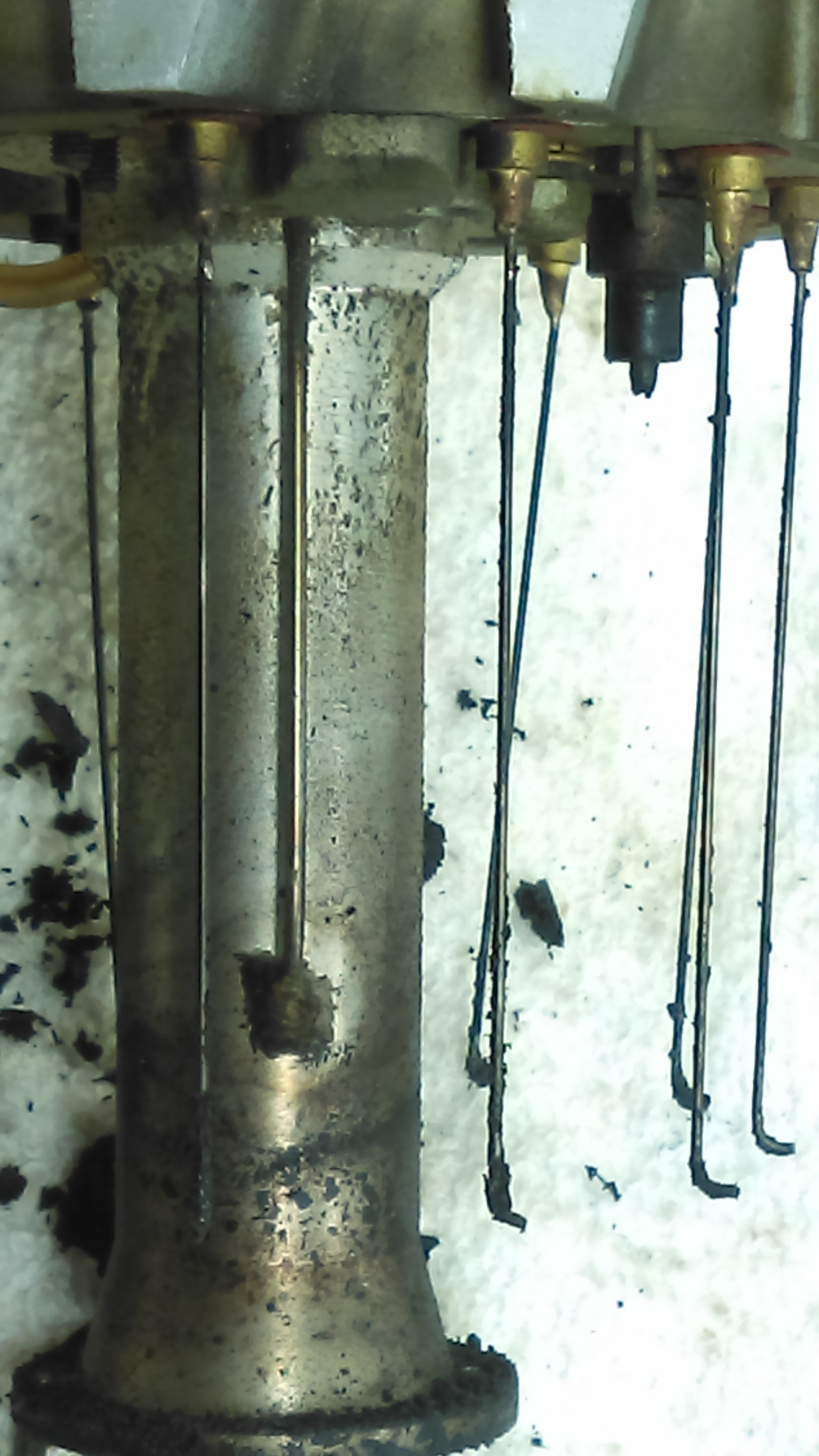

sompop,
There are many countries we can not ship oil to, due to many reasons. It takes time for Barry to find a local Dealer to take the initiative to find a local oil company to mix our special blend and offer it locally. Aeroshell 560 has performed ok along with BP2380 & Mobile DTE. Please see pictures attached of engines using Aeroshell 500. I just received this engine in yesterday with a stuck rotor and only 600 minutes run time.
. The coking build up is so bad that it caused the rotor to stop spinning as the bearings are ruined. I hear other manufacturers are using sand blasters to remove the coking from inside their engines. That is why we banned Aeroshell 500 and I would like to see Mobile Jet II be banned as well.
Regards,
Dirk
kingtech Service
