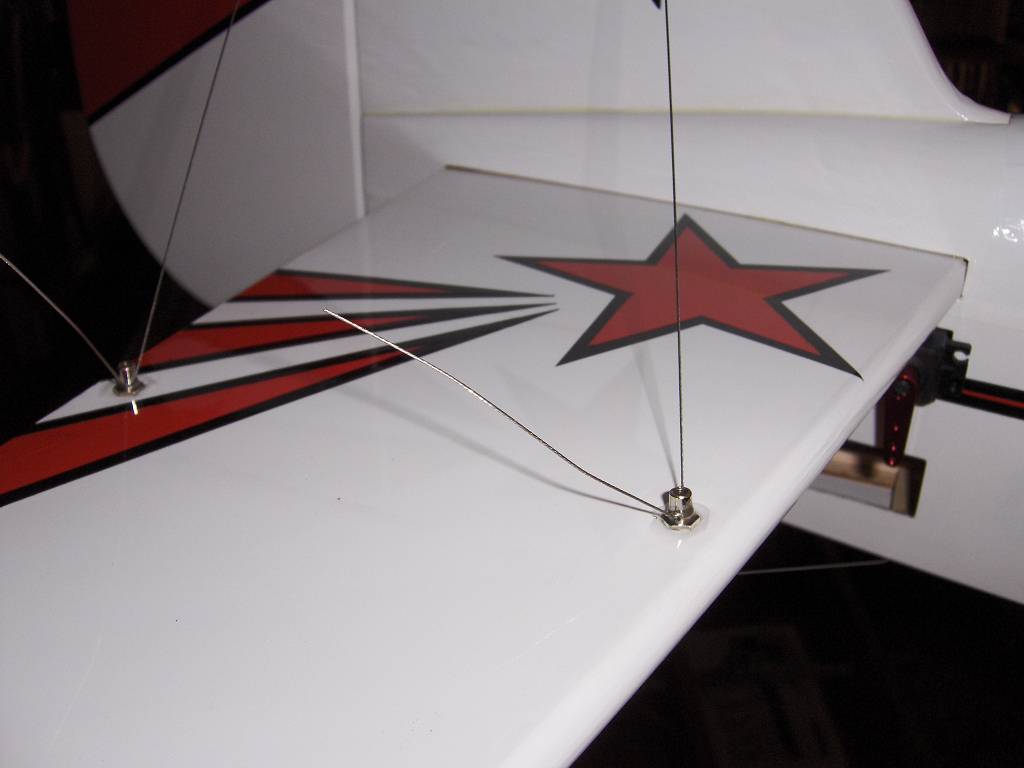

I just finished building a 1/4scale spacewalker2 and need to put wire tail braces on the tail.theres not a lot of detail or instruction and I have never done this before.is there a tutorial on the net .I dont know what size wire to buy.I really want to stay away from using 4-40 rods as it wont look very scale.

For a 1/4 scale model I would go with 2-56 rods. I use a threaded end and a solder end clevis for attaching the rods. This alolows you to adjust the tension on the wires as needed and it looks pretty good as well. You can use Dubro or Sullivan straps for the anchor points. I have done this on several models and I like the results.
I am attaching a pic of the tail brace wires on my 33% Waco, these are 4-40 rods with Dubro solder on and threaded rod ends.

Braided stainless steel fishing leader with plastic coating, different sizes/weights. Rigging couplers and 2/56 clevises with the top half of the clevis cut off. I get my wire at bass pro or any good sporting goods store, rigging couplers from any good hobby shop. The couplers come in 2/56 or 4/40. There are also very nice turn buckles for models too.

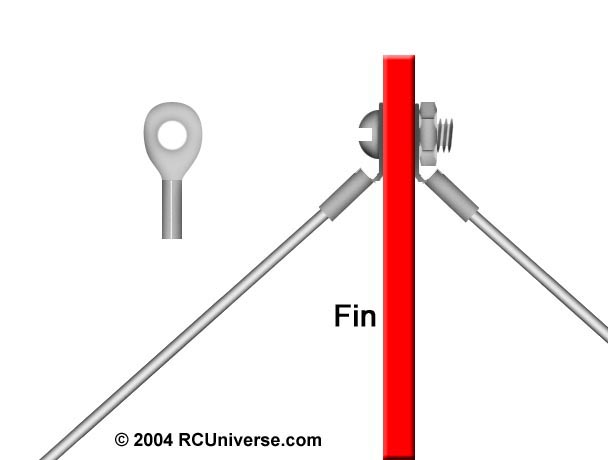

I use electrical loop connectors and 2-56 wire.
Screw the connectors in place with the wires attached. Crimp to hold position, remove and solder

I have used some 0.030 diameter HTR (brand) stainless steel wire for tail and main wings flying wire.
I made the ferrules where the wires terminate using 0.030 inch thickness aluminum (dural alloy) .
I terminated the wires using two methods ___
1- Bend the wire back on itself forming a circle coming back to itself and bent over itself so it can never unbend.
2- use a Dubro 2-56 threaded clevis at one end and a solder type at the other end.
This provides for length adjustment.
I used some small diameter brass tubings cut in length to the thickness of the stab so that the 2-56 screws, nuts and lockwashers could be tightened witout crushing the balsa.
A couple of drops of thin CA around the bras tubing does reinforce the wood at that location.

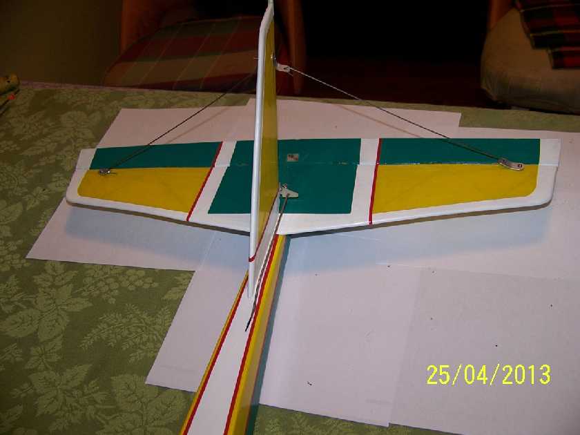

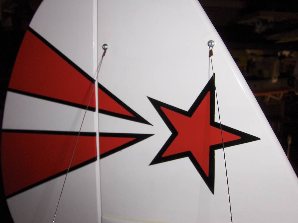

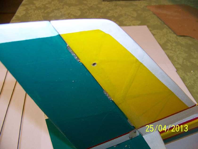

You are doing nice work.
Attached some pictures illustrating some recent work I did to reinforce the feathers.
First pic __the parts being prepared. The wire is stainless steel 0.030" dia.
Second pic __Right side of fin in which a brass tube allows thightening the screw without crushing the balsa.
Same for the stabilizer.
Third pic __Overall view from the front.
Fourth pic __Rear view.
Fifth pic __My new source of "turtle deck coverin" LOL
I also have a new source for the "turtle deck" Hee Hee! LOL
Zor

Old 05-04-2013 | 06:40 AM
Banned
Posts: 2,670
From: San Diego, CA
Default RE: making tail braces
I have drilled thru and installed tubing of the appropriate length, so I could tighten the bolt without crushing the balsa.

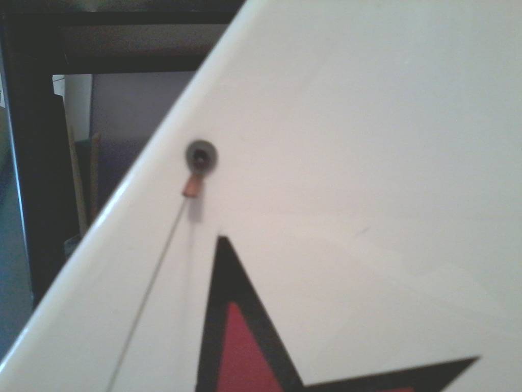

Thanks for the info! I decided not to use brass tubing, mostly because I did not have any on hand. I sandwiched. the cable between two washers and gently tightened with threadlocker.
