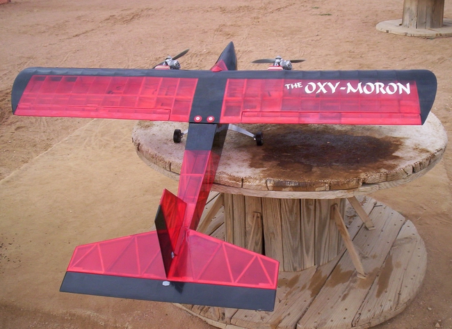

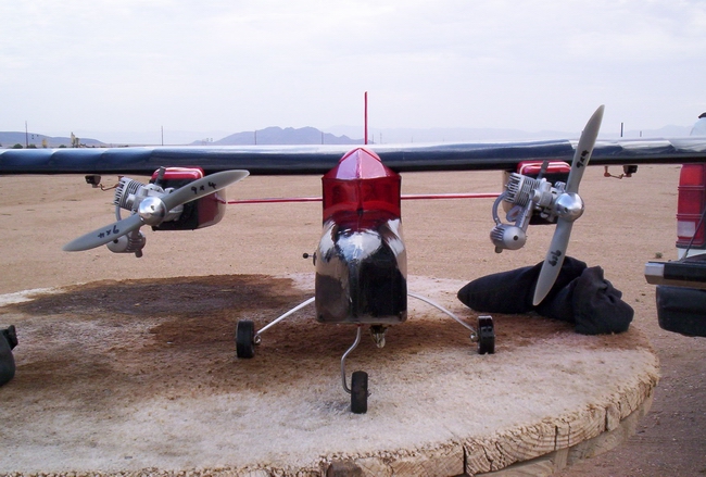

My specific suggestion under your conditions would be an OS LA 65. Last year I rebuilt an old wreck for a gentleman that had become a professional student without ever progressing for years. The chief cause was no real mentor and a long line of totally inappropriate airplanes for him to really learn, its a common story.
This airplane was hugh success for him and I built/restored it as I posted above no ailerons and the only concession of extra weight was oversized dubro balloon wheels. The engine was a ST 61 but it turned out somewhat cranky for him so a new la65 solved that and was an extremely user friendly engine for him as well.
On the Mk 1 or 11 no larger than a 35 and my favorte is a nice modern .25.

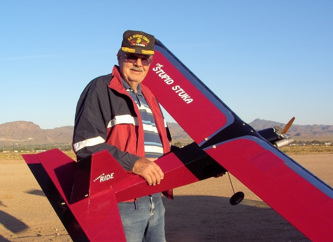

This is Larrys ride still with the ST:

[img]{akamaiimageforum}/upfiles/23346/Xr45222.jpg[/img]
That Senior is a beauty and does not look too big for us, he has made up his mind that yes, its what he wants. We are going to cover it with Coverite fabric, won't this [link=http://www3.towerhobbies.com/cgi-bin/wti0001p?&I=LXHSL3&P=0]Magnum XLS-52[/link] be enough power on a fabric covered Senior? We are building it stock without ailerons. If not then how bout the [link=http://www3.towerhobbies.com/cgi-bin/wti0001p?&I=LXRLG7&P=0]Magnum XLS-61A[/link]

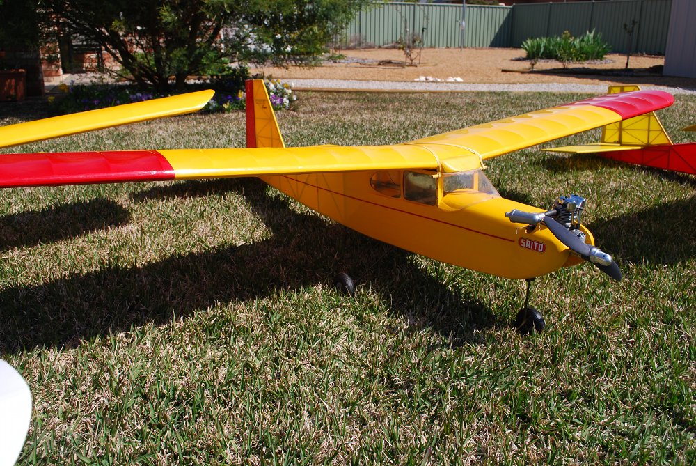

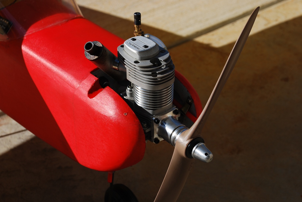

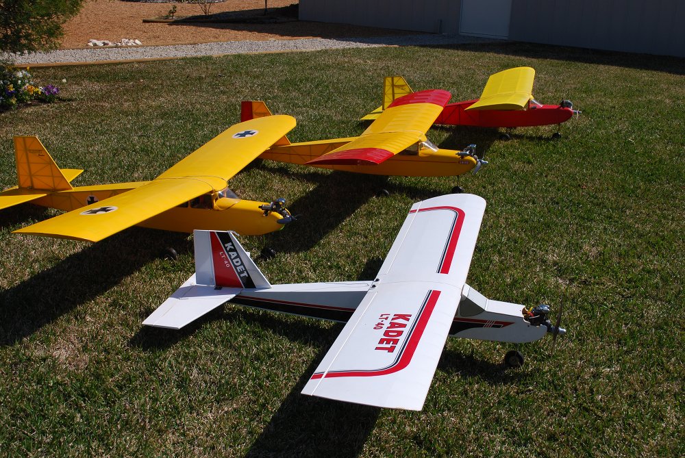

Here are some pix of some of my Kadets.
The all yellow one with the German WWI crosses is Solatex covered and has the Saito 56. It is my favourite for all weather flying.
The yellow with red wing tips is partly covered in Solatex (fuse) and the flying surfaces are covered in Solafilm. It originally had a Saito 62 but at the moment has a new Saito 82 which is there to do some trial runs.
The red fuse, yellow wing Kadet has an English Laser 70 engine. The engine is brilliant but on the pricey side. This one took a bit of getting used to but is now flying really well in all weathers.
The LT-40 is an ARF and is powered by a very old Saito 45 with a hot cam from a recent 56. This engine would also fly a Senior. A friend had one that I built and covered in Solatex but sadly it died from under maintenance. I am sure it could have been rebuilt but it was dumped before I got there.
If you are unsure about building the structure of the Senior, the LT 40 Kit is easy to build and flies almost as well.
