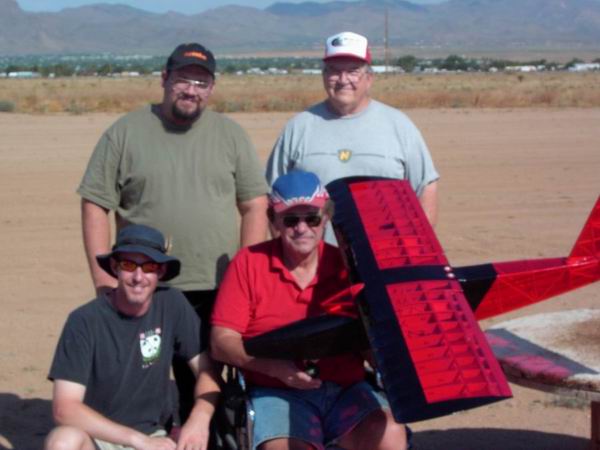

Any photos of the plane in a field with the pilot next to it so we can judge the size?
We would consider a Senioretta but we already have the motor (Magnum XT .46) that is currently in my Kadet Mark II and was told by RCKen that is way too big for it. So what we were going to do was buy a .32 or .35 for the Mark II and put the .46 in the Senior.
Photos would be a huge help for my brother so please post your finished planes so we can judge the size and just see your beautiful birds. As well as 2-piece wing details and photos, tailwheel mods with details and photos.

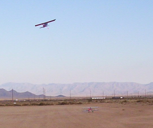

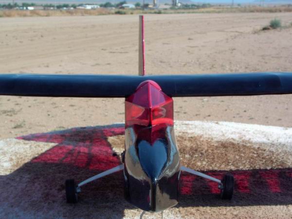

Here is one of my Kaydets (seniorita) in this case it has the perfect engine:
