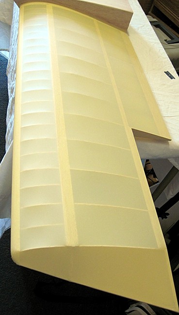

I am covering my 33% Cub with Cub Yellow Solartex. The stuff is going down great(much better than monokote IMO). The only thing I do not like is the Solartex is too transparent. I will be spraying a coat or two of paint once I have the tapes applied.
The Solartex does work around the wingtips very nice.
Later!!
Anthony

I can tell you a 1/3 scale Cub eats up alot of covering. I ordered a 10 meter roll and it is not enough. I just placed an order for a 5 meter roll. It's really looking good. All the seams lay down nice and I am placing them where the reinforcement tapes will cover the seams.
Later!
Anthony

Default RE: Covering with Solartex help.
Here are a couple of pics of the wing panels. Not one wrinkle
Anthony

I agree, but on the plus side it will take less coats of Cub Yellow paint to achieve the desired look by starting with the Cub Yellow Solartex. I took a sample of the Solartex to Home Depot and had a quart of Yellow color matched.
Here is a pic of the starting of the rib stitching and tapes. The tapes from Pink-It are cut from the Cub Yellow Solartex. The tapes go down very well over the Solartex.
BTW: The stitching is from Scale Rib Stitch in Canada.
Later!!
