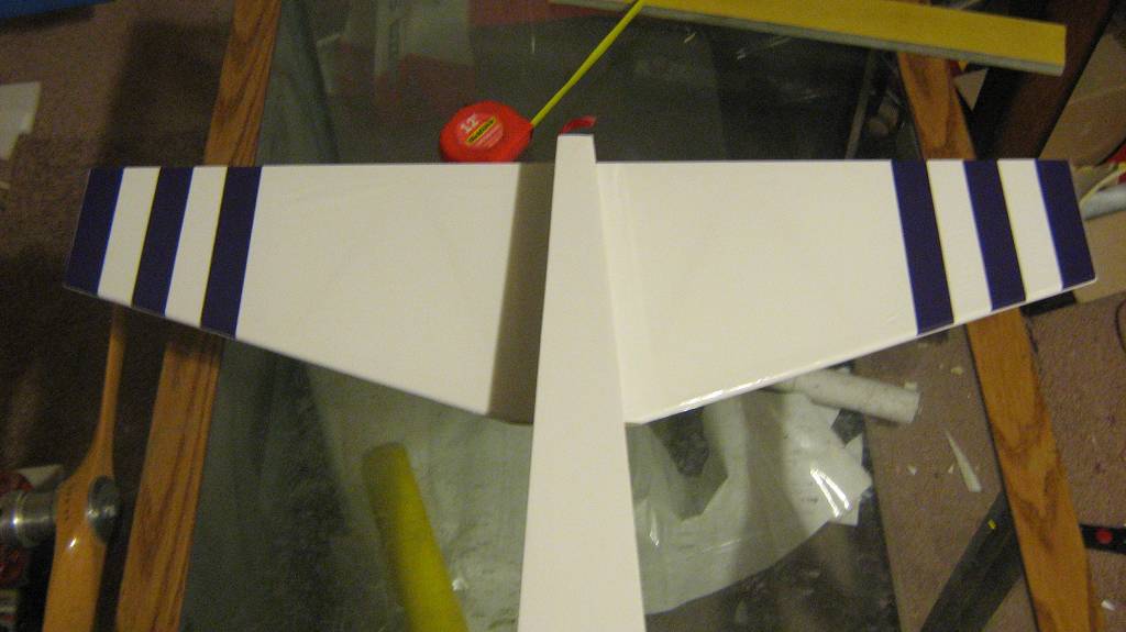

Thanks for the comments Seamus.
I like your suggestion to widen the purple where it meets the fuse near the TE of the wing. I'll definitely widen it enough to swallow a little bit of the aileron root.
I know the yellow stripe is not going to be seen at more than 10 feet away. It's purely bench appeal. Same with the fuselage stripes. But I couldn't handle a plain white fuse side. I do have windows on the side of the fuse. They are black. The top of the wing - in the center - has black as well. Sorta "Decathlon" or "Citabria" theme...... where you can look up from the cockpit and see out. Updated fuse pic with the black windows attached to this post.
I've found that the bottom of the wing and stab are rarely seen if flying a race track pattern. I try and put the stripes on these areas so that I can keep my orientation when doing aerobatics. Don't know if you've seen me fly yet? [sm=confused.gif] I'm RARELY flat and level. Always twisting and rolling - upline or downline. I need something on the bottom to differentiate when the plane is balled up. Thats the only reason I even bother with the bottom of the wing and stabs at all. If you're flying flat and level - the bottom of the wing usually looks black anyway. Only time you see it flying the race track is an overhead pass down the runway.
Bottom wing stripes are 2.5 inches wide and will be spaced same distance. Bottom of the horizontal stab stripes are 1 inch and were spaced same.
Purple strips on the fuse are 1/2 inch and the yellow will be touching it, but only 1/4 inch wide for the yellow stripe. Red strip will be 1/2 inch. Thats all I can fit on there. The back of the fuse, under the stab is only 2 inches deep.

My Chaos originally had two 1/2" stripes down the side on a bunch skinner fuse than the LT's. Thing that I realized - it's darn near impossible to lay down two (let alone three) stripes straight. I bailed on the skinny scheme and went wider because the film is much more easily handled. Are you using MonkeyKote? If so, maybe the Windex method for laying the stripes down would be a much easier task.

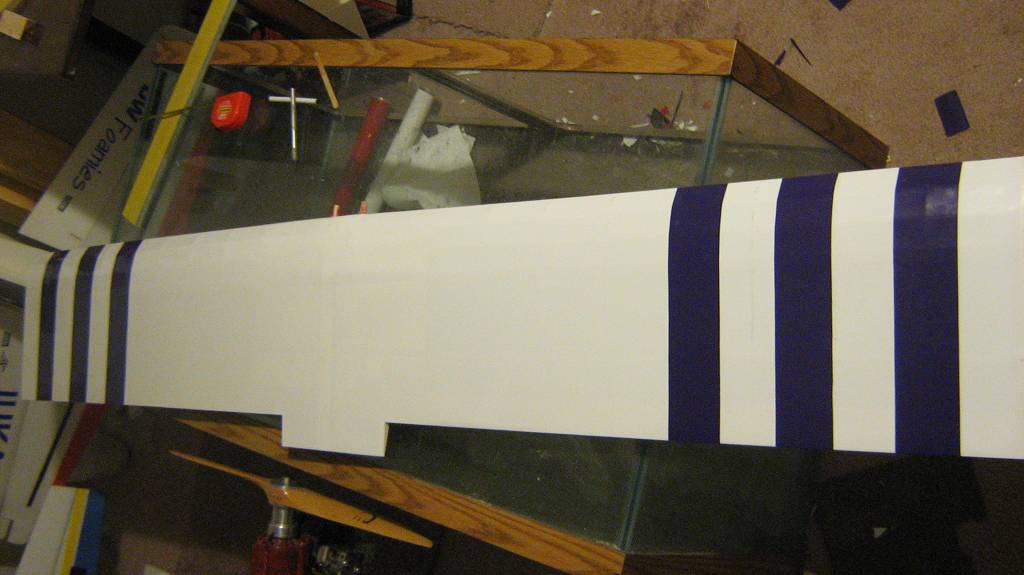

Got the stripes on the bottom of the wing.

Lets try it again.
Taa-daa!
Don't know why the stripes look blue. It's Monkeykote purple in real life..... fluorescent lighting in the man cave?

yup - lighting thing. I've scanned pieces of covering. The RGB numbers for the color are consistent with snipits from Hanger 9's Ultracote site but, when it comes to blues & purples - they all look the same.

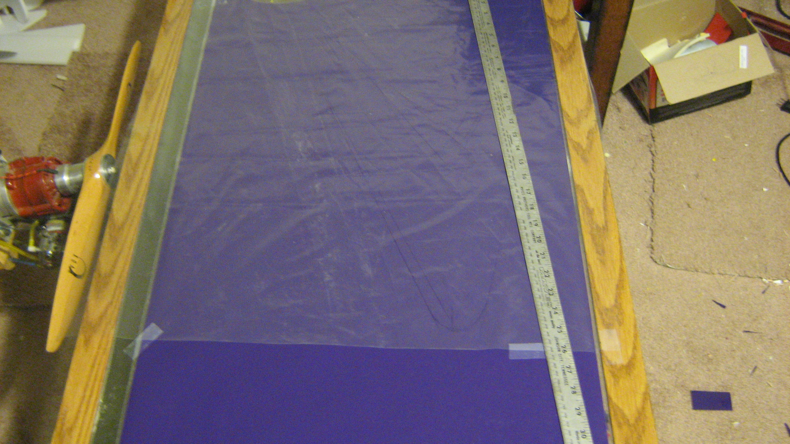

I saw your drawings of the counter balanced ailerons. GO FOR IT!! They look really cool.
I took some clear Monkeykote backing and taped it to the top of my wing. Then used a black ball point pen to draw lines all over. I've created a template that I can see through.
Laid the template on top of the covering and taped it down. Gonna start slicing soon. Pics to follow - gimme 15-20 minutes.....

Clear template taped down over the purple. If you look hard you can see the pen marks.
Right wing with graphics laid out. Not ironed down yet.
Didn't turn out exactly like I had it drawn, but who cares? I don't usually try and cover like this. It's a lot of work and this is just a sport plane for hogging around the sky. Still, it's kinda fun to press yourself and try more complicated stuff. [8D]
That was a loooooooong 20 minutes. More like 1hr and 45 minutes.
Got all the parts and pieces cut for the wing. Dead tired and 6am comes early. Gotta hit the rack. Will stick it down tomorrow after work.

Busy week. Sorry for the delay.
Friggin covering on the wing looks good at ............ errr.............. 20 feet? [sm=lol.gif]
Damn monkeykote bubbles!!! [:@]

Thumbs up!!
I've felt your pain. I've never used monokote - have you ever danced with the "rumored" Windex method for doing monokote trim?
I put a piece of trim on a 4Star60 wing about the size of your purple trim. Easily took 1 hour for that one piece to keep the bubbles out.
I really don't like using a T pin to "plick" holes in the bubbles - rather use a decent #11 X-acto blade slipped into the side of the bubble while pushing the air out with the iron. It'll fix a bunch of evil bubbles. Give it a try. I really hate it when the damn forum software blocks out certain words that rhymn with plick.
