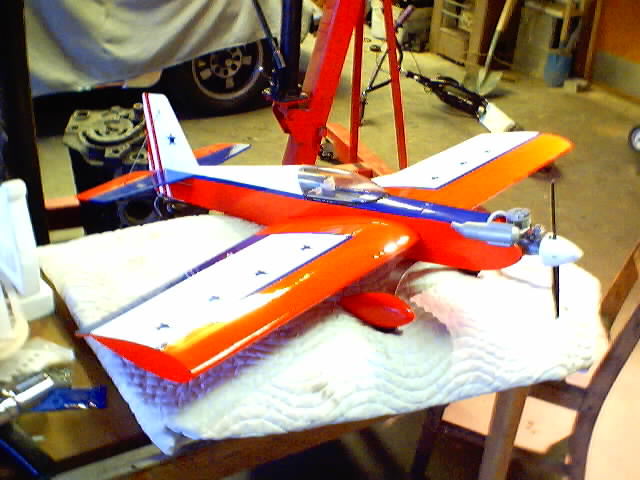

My current (and best) SE is powered by a piped and ported OS .61. Needless to say it has unlimited vertical.
The landing gear is off a GP extra 300 - 40 and gives me the additional prop clearance needed to run a 12X7 prop. I Lost the tail wheel long ago and now just use a big balsa skid in it's place.
For fast flying I use an APC 12X7 prop as indicated above. For 3D flying and hovering I use a 12.25X3.75 APC. This big fan really makes hovering easier.
On this version I partially enclosed the engine and use a 2 1/2 inch spinner.
The throttle servo is a tiny HiTec HS-55 mounted inside the fuselage directly behind the firewall.
I partially removed the fuse former that is behind the stock tank location and also removed the fuel tank wooden floor. This allowed me to install a 14 ounce tank and have room for the throttle servo. The top of the fuse front is now a hatch so I could massage the large tank into place.
The elevator and rudder servos are mounted in front of the stab and I use Pull-Pull on the elevator. The servos are Hobbico CS-35s. They are very fast on 6 volts (0.11 sec) strong (65.8 0z-in) small and light (27 grams - .95 0z.) best of all they only cost $22.95 each.
I added 2 inches and a counter-balance to the rudder and added 1 inch and counter-balances to the elevator. These counter-balances virtual eliminate flutter while adding much needed surface area to the tail feathers. In addition I drilled several holes in the stab and elevator to reduce the weight.

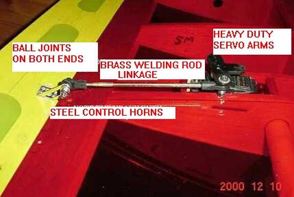

In order for the SE to really perform it needs massive control surface deflection. I got tired of sanding all the bevels on the ailerons, rudder and elevator halves etc so now instead of sanding I simply glue on small triangle strips. This is SO easy and gives you all the clearance needed for full surface deflection. For extreme deflection you can even use these strips on both the fixed and moving surface.

Note: Check the aileron linkages in the enclosed picture. I threaded brass welding rod to 440 size. Heavy, but cheap and very rigid. This was before I added flaps and went to smaller servos. I still use this type of linkage on all 4 wing control surfaces as it does not allow any flutter and high speeds.

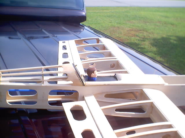

I'm just about finished with my 150% scale Somethin' Extra. My original intention was to simply build an oversized version. But I ended up changing a lot of things to save weight and increase strength. It looks just like an SE, but inside, it's different.
The fuselage sides are 1/8" lite ply with carbon fiber lamination, I used basswood stringers on the bottom of the fuselage instead of sheeting and made the top hatch using stringers. In fact, the hatch on the big one is lighter than the original! I mounted all the servos (except throttle) in the tail and used pull-pull on the rudder. I have a separate servo for each elevator half. The elevator and rudder are oversized and have counter-balances. I have 70 degrees of throw on the elevators and about 60 on the rudder.
I kept the design of the wings the same and used a 1 1/2" tube from TNT. Power is a Saito 180 with an 18x5 prop. This combo would pull my 16 pound Lanier Extra 300 without breaking a sweat. I estimate this plane will weigh about 11 pounds. I was trying for under 10.
It ought to be a 3D animal (when I ever finish it). I've been working on some paying jobs and had to sideline it. I need to spend about another 10 hours and it'll be ready to go.
