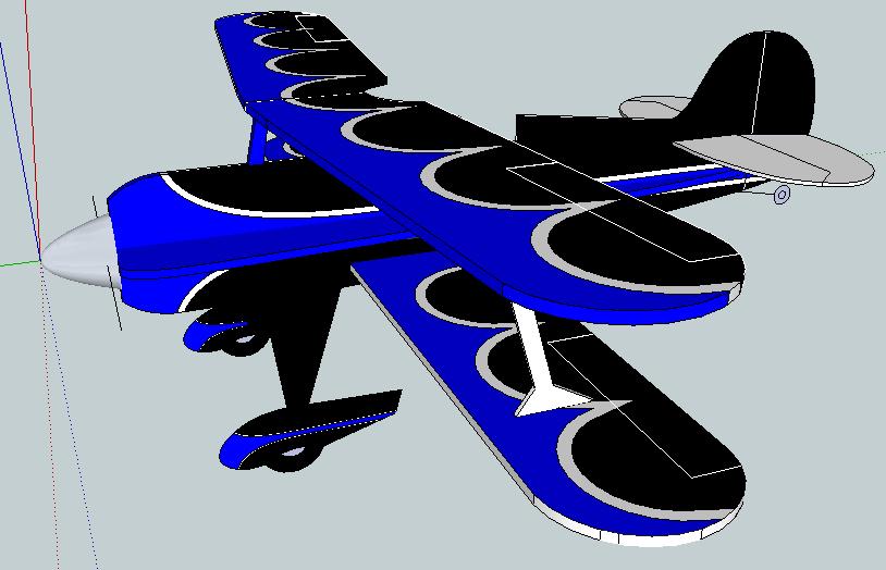

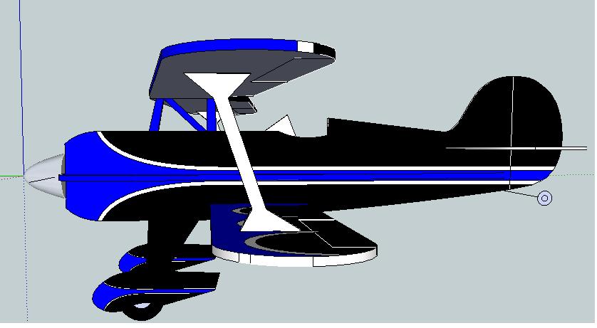

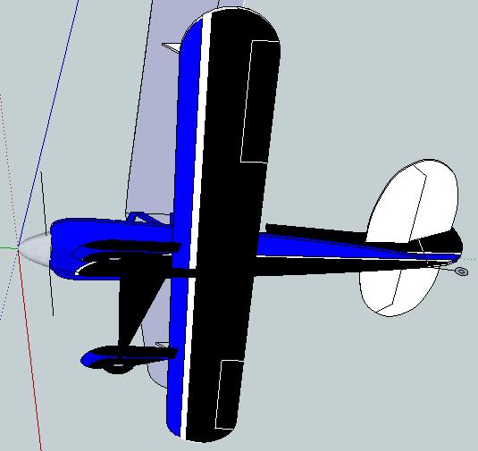

hi all i will be using solartex to cover my next plane a 100cc size culp special. my question is can i pre seam solartex like you can with monokote? my meaning here is to take your base color which for me is black then on top of glass attach the trim together with 1/4-1/2 inch overlaps then apply the whole sheet to the wing in one shot eliminating all the extra base color material under the trim colors. my scheme will be fairly simple with blue full cord scallops with a white accent scallop then a black base color. the blue will be painted on but the white i was planning on using covering for so that i only have to paint one line instead of two. i would then clear coat the rest of the bare covering
the pics are a work in progress but it gives you an idea of my scheme
also i will not be pre-seaming the fuse too many curves but i will still be using white covering for the accent and paint the blue

When you over lap with ST it's a must to put the dark over the light. The TEX shows through a lot more then the plastic coverings like Mono and Ultra. Is that what you are asking? Other then that the TEX goes on just like the plastics, just stretches over curves and shrinks better. Great stuff!! I love working with the TEX coverings.

To me, it would be easiest to cover the entire model in the base color, and use paint for the trim.

I have used solartex quite a bit, including right now on a BUSA DH-4. I have not had good results using it for trim. What I find is that the trim will shrink when heat is applied and I get wavy lines. I suspect you will see it wrinkle up when you tack the trim to the base color and you will have to get the iron close to the seam when you install it. I agree with Tom that it would be best to paint the trim. I have used epoxy, rustoleum, polyurethane, nitrate dope and latex successfully on ST. Also agree with Gray Beard on the opacity of ST.
