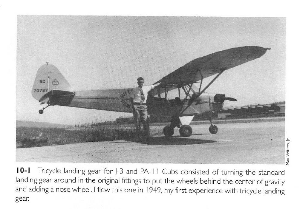

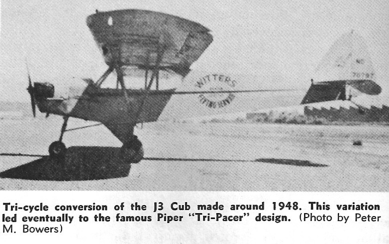

There were a few J-3 cubs that came out of the factory with tri-gear. I can't find a picture, but they are listed in the US Civil Aircraft series of books bu joseph Juptner. If you can find them, those books are a great reference. They have all the type certificates listed in numerical order with pictures and technical information from the aircraft certification.

I'll try and locate the book you mentioned. I'm not trying to really scale this thing out. I just have never liked flying tail draggers and have always liked they way trik gear look.

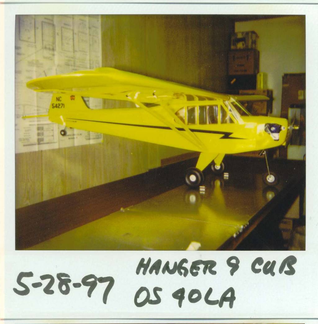

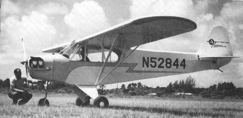

I took a Hanger 9 J3 ARF and made it convertable from convential gear to tri gear. I made the nose wheel steerable on the model.
On the full size the main gear is simply turned around and the same mounting is used on the fuselage. The nose wheel on the full size is not steerable. There is a unit hanging up on the wall at Lock Haven in the Piper museum. The tail wheel remains on the plane. With only the rear seat occupied the plane sits down on the tail wheel.
I own a fullsize J3, but it is not tri geared and if it had been I would have removed it.

I forgot to mention that conversion from nose wheel to tail wheel takes about 15 minutes. Remove the nose wheel strut and replace it with a short piece of 5/32 wire to keep the steering stuff in place. Remove and turn around the main gear.
Take proof of the nose wheel version with you to the field because there are going to be some bets placed and you could get a lunch out of it.
