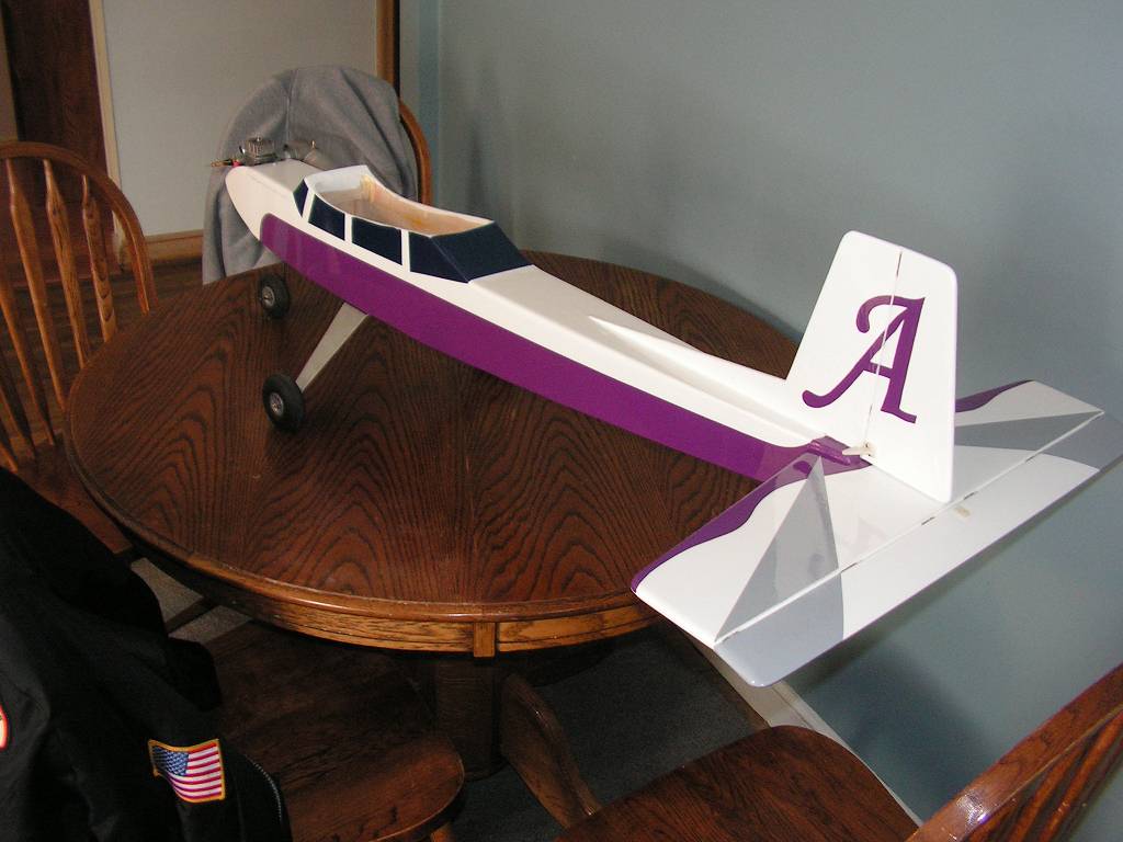

I have found as long as the monokote gets attached VERY tight to start with, it will shrink well. If I allow an area to be loose, it will take to much heat to shrink it with the gun, and it will create ripples that will never pull out, and I can never get it to fully shrink. It is as if you have to overheat it to shrink it, and it will be ruined.
I still think the look is better than Ultracote in the end, but it has become hard to work with. Much harder than it used to be.
I posted an example of what happens when you have to get the monokote too hot in order to shrink it.
I decided to leave it and move forward as you can see the fuse is just about done, and my daughter is excited to see it done and fly her airplane.
Brian
