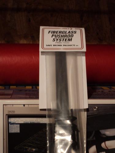

Care package arrived from home base (Tower Hobbies).......lol
Ordered a few goodies and decided to go w/ Dave Brown fiberglass pushrods and sprung f/the extra ends as well. I have also got the Sullivan flex for the throttle. I am not a fan of balsa rods and in keeping albeit w/the design of a stiff type pushrod, I opted to give this a try. I have never used their rods, but I sure have used many of their other products and have never had a problem with any of them. I admit, was a bit pricey, but hey, what's not w/gas almost @ $4.00 a gal?
That eats into my Living Expenses, RC!

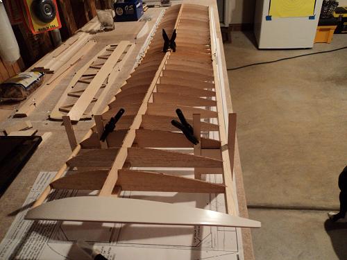

Almost completed the wing, I know, slooooow builder, but hope to have photos soon of the finished wing,

Thanks guys for the kind words. I am a slow builder compared too many here. I just have always took plenty of time for any construction I am doing, and usually have more than one project going @ one time. I also am working on a 1/2A RC when I can not work in the garage.
I am @ a in-pass right right now trying to figure out if I want to go w/bolt on wings which are much clear looking or go w/the rubber band type. Any thoughts on this fellas.
I need to decide since I am @ the point of sheeting the top saddle of the wing. What size screw holes for the blocks should I consider. I know Sig makes sets alreadt drilled for this and there is two sizes available on eBay. Hope everyone has a Happy Easter.

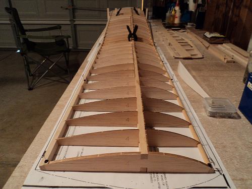

Well, I thought about it and decided I will just go ahead w/the wing held on w/rubber-bands as shown in the instructions for the sake of keeping the build moving forward. I am ready to finish the wing and as posted on another thread, glass the wing joint. I did deviate a bit from the instructions and went ahead and used all three center ribs glued together and not just 2. This was then solidly glued to the wings joining center. Very strong, and I have no fear about this area failing. I am sanding and ready to install the ailerons, received a handy tool for this step, a Great Planes Groove Tube, never did like doing this w/a rat file/knife. Also sprung for the Dead Center as well, both tools appear to be well made and very useful for what they were designed to do. Besides being a kit fanatic, I also am a sucker for any tool that will make the job easier and more professional. Micro Mark smiles every-time they see my name.
Another question? Saw small aluminum strips added to locations where the rubber band draped over the wing. I get the idea why, but is this a good mod to keep the wing edges from being crushed by the rubber bands. I believe I read it takes 14-16 rubber bands to hold the wing securely.<br type="_moz" />

Hi DUCO,
The aluminum metal strips is to protect the Trailing edge of the wing from being crushed and messing up your covering film by installing and removing the rubber bands.
If I build another Eagle 2, it will be a bolt on wing.
For the bolt-on wing, you modify the #1 Ribs (2) by cutting a piece of the rear Ribs to accept the 1/4" Dowel. At the front of the #1 Ribs, you cut a Wedge shape piece from left over #1 Ribs drop-offs. Then you make two additional Ribs to guide and capture the 1/4" Dowel along with epoxy and glass cloth. These extra Ribs will be on the outside of the #1 Ribs.
If you decide to use the rubber bands, be sure to notch the rear Dowel so the Aileron Control Horns do not stall-out on the rear Dowel.
