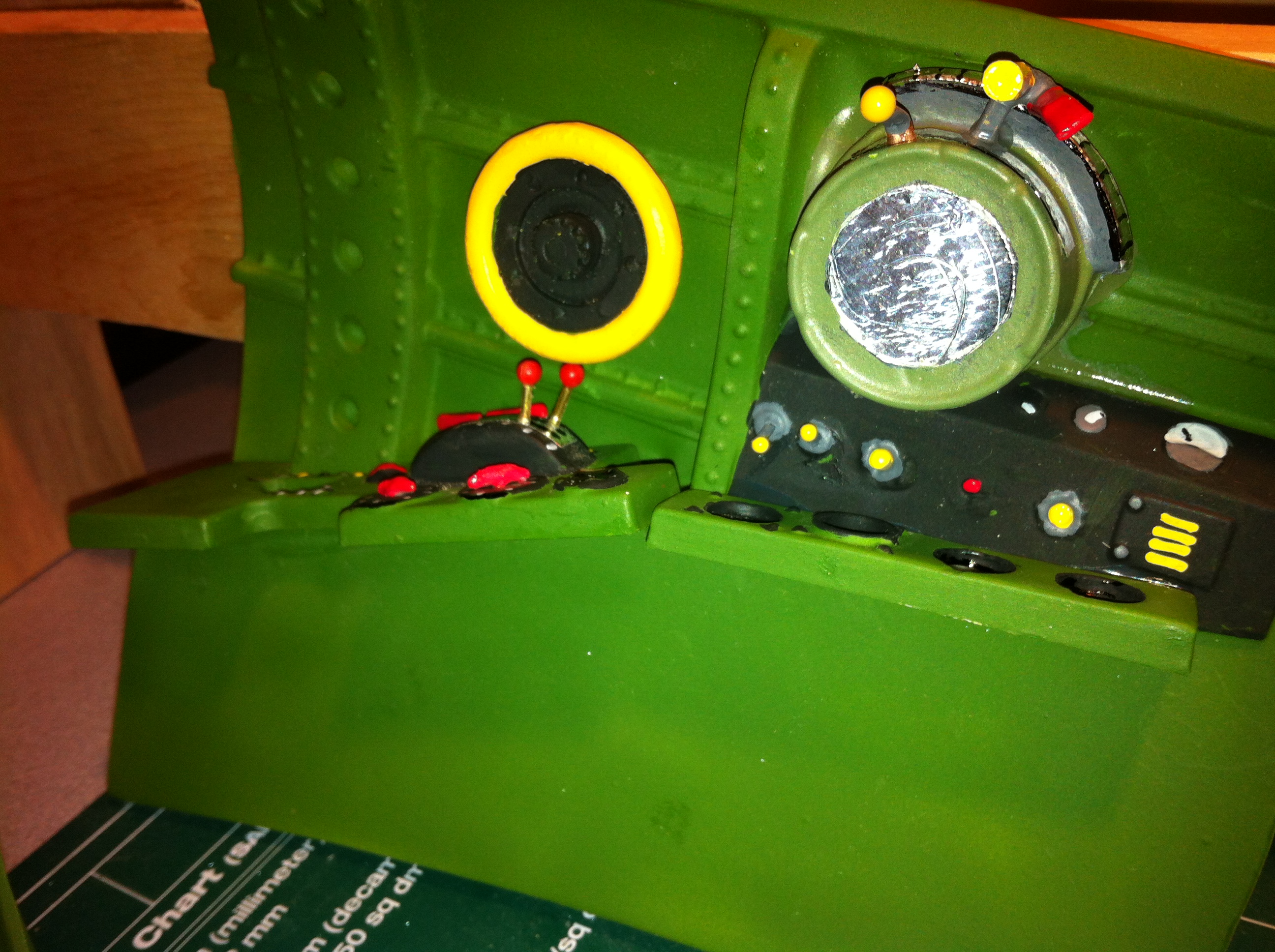

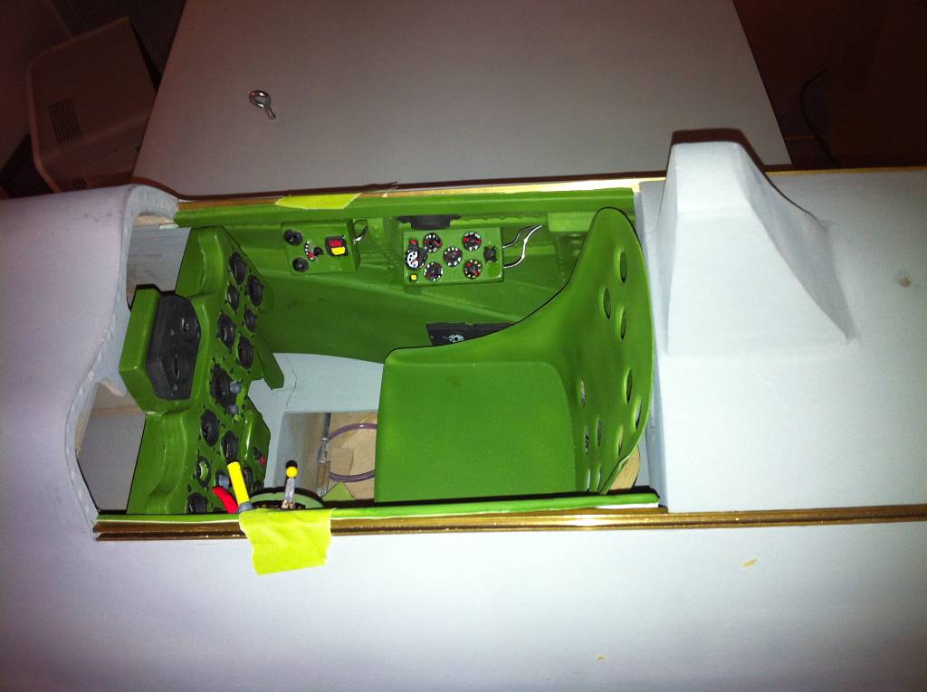

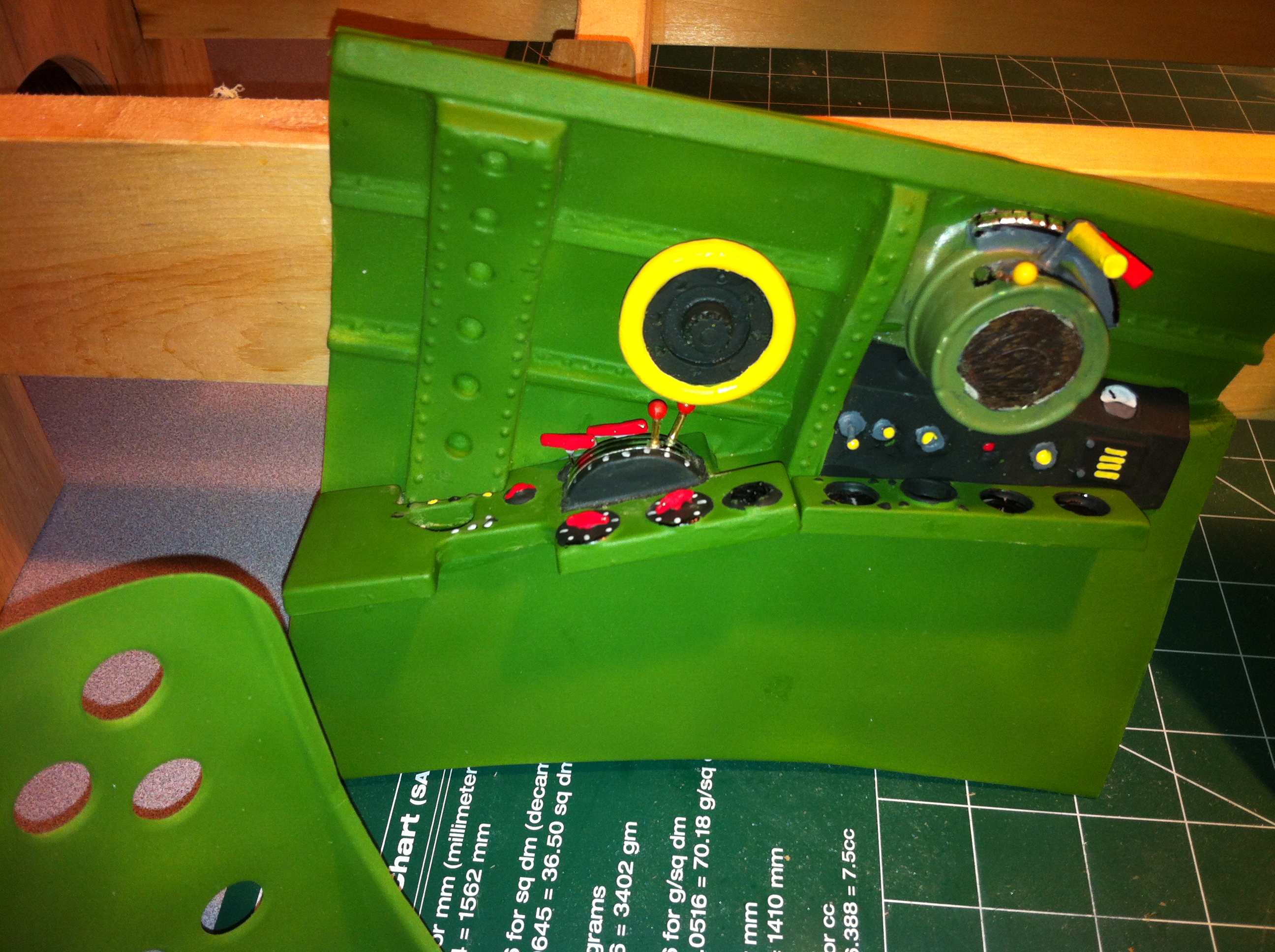

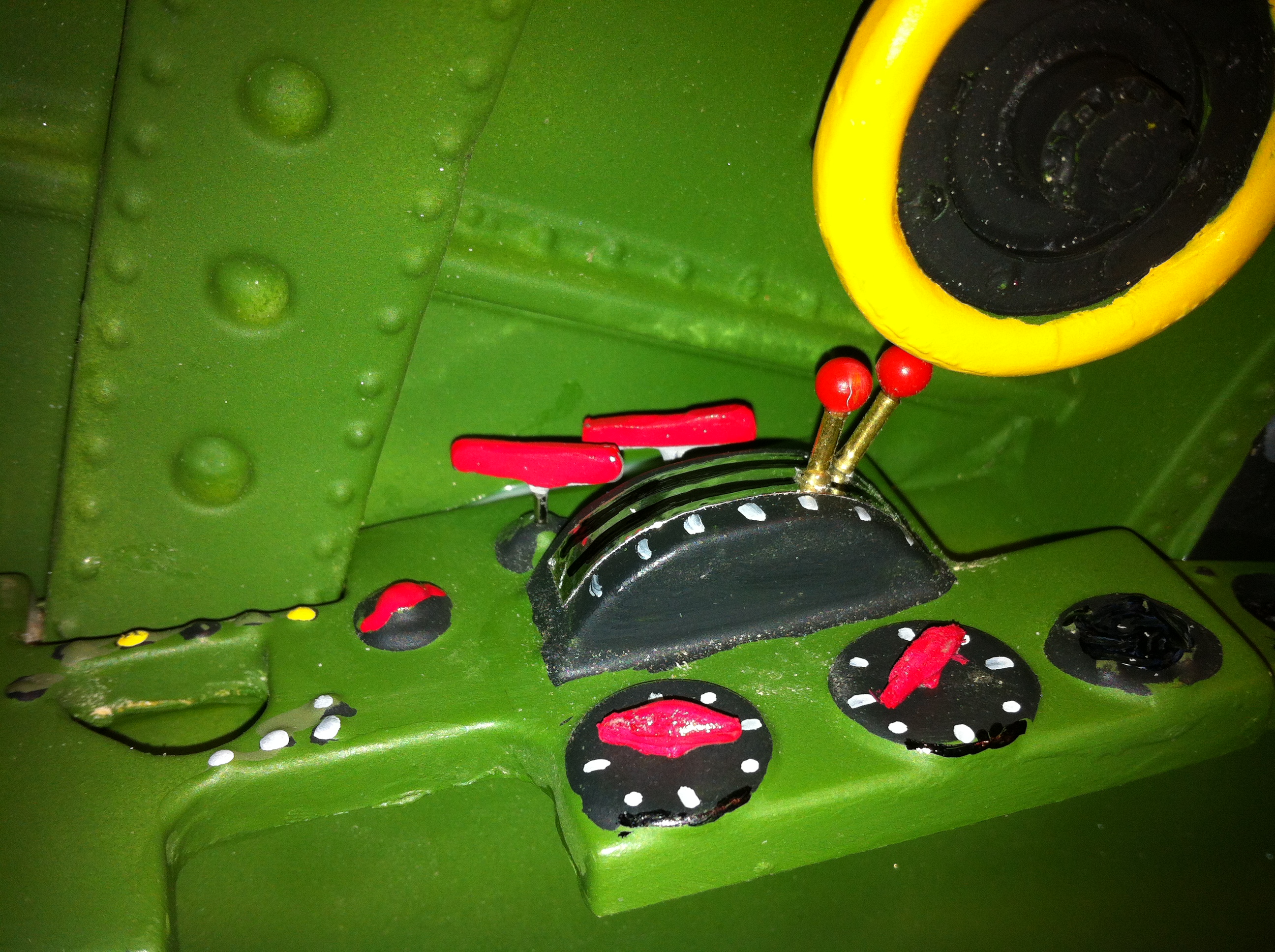

Received my cockpit kit from Ed at BuyAero.com and have been painting and making knobs from pins all week!
I'm pretty pleased with the results so far.

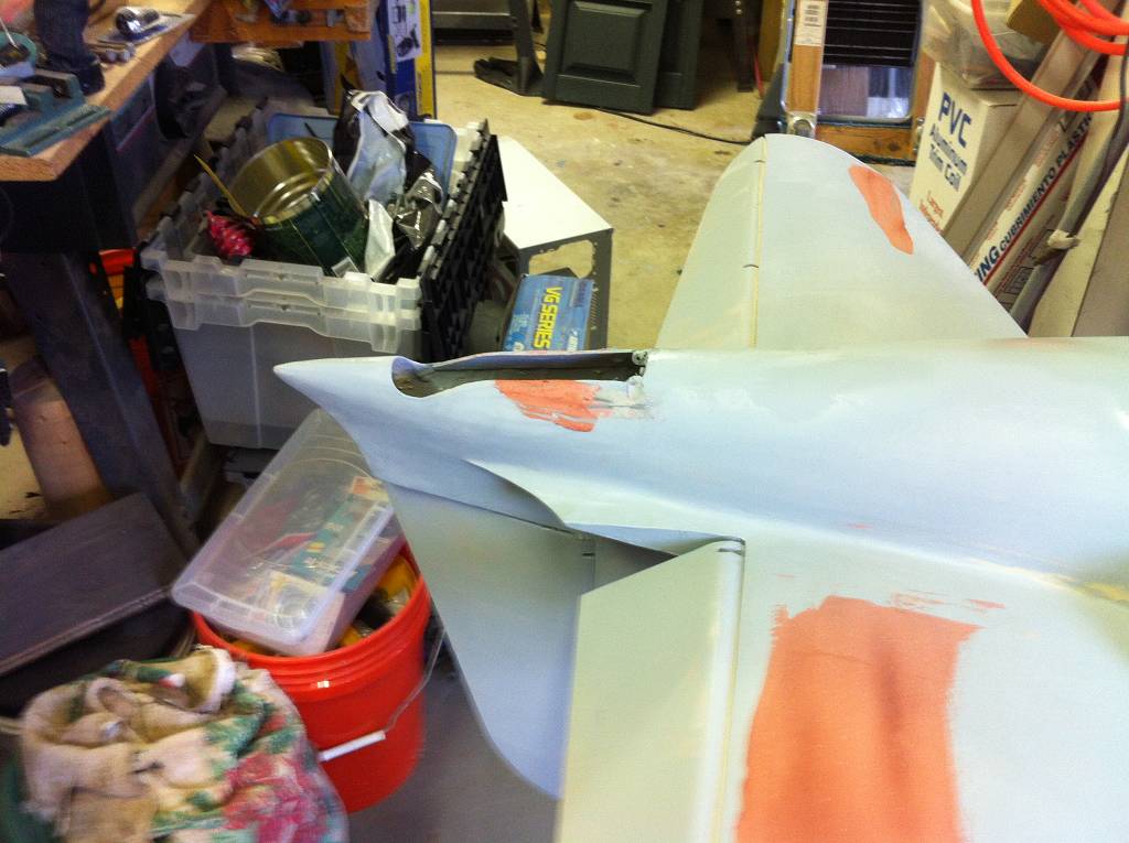

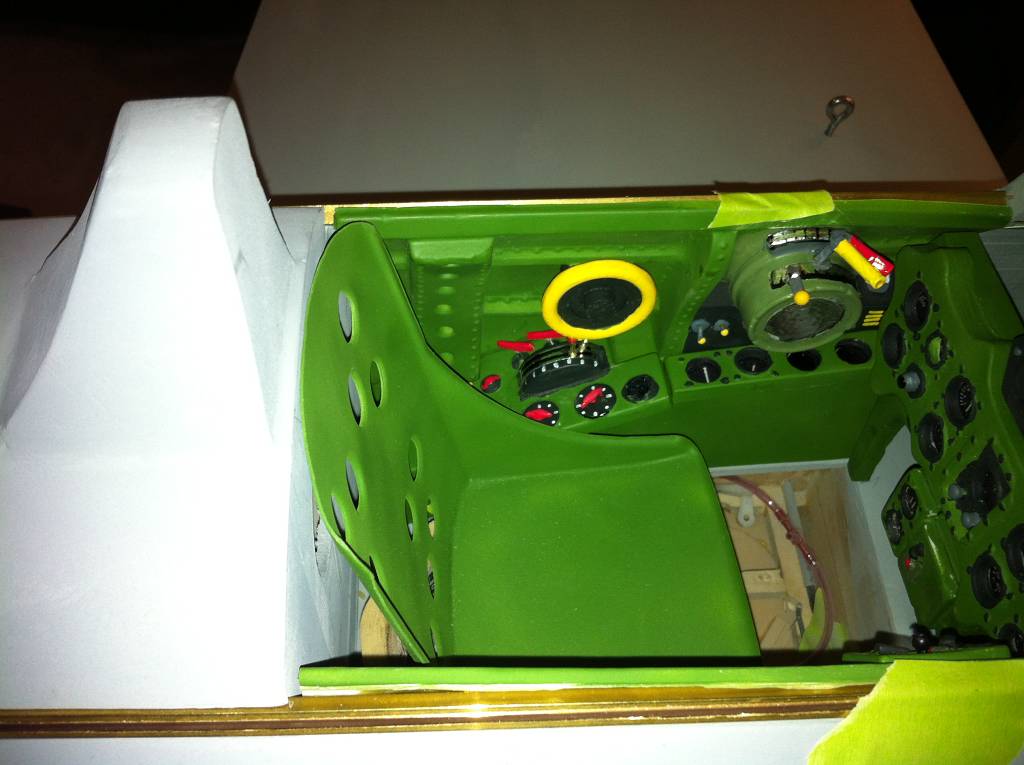

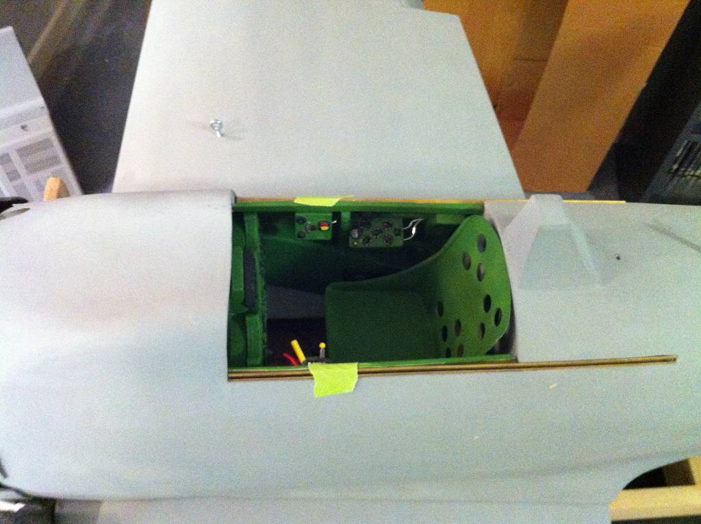

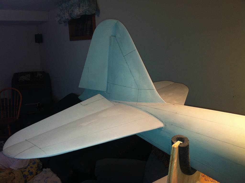

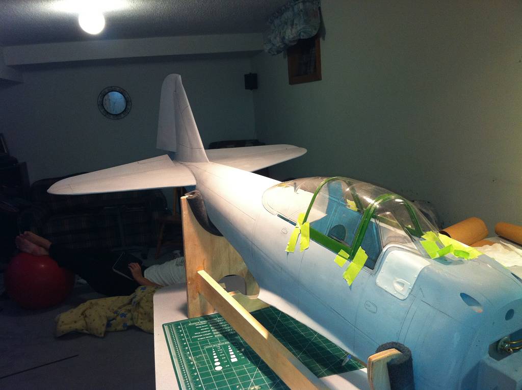

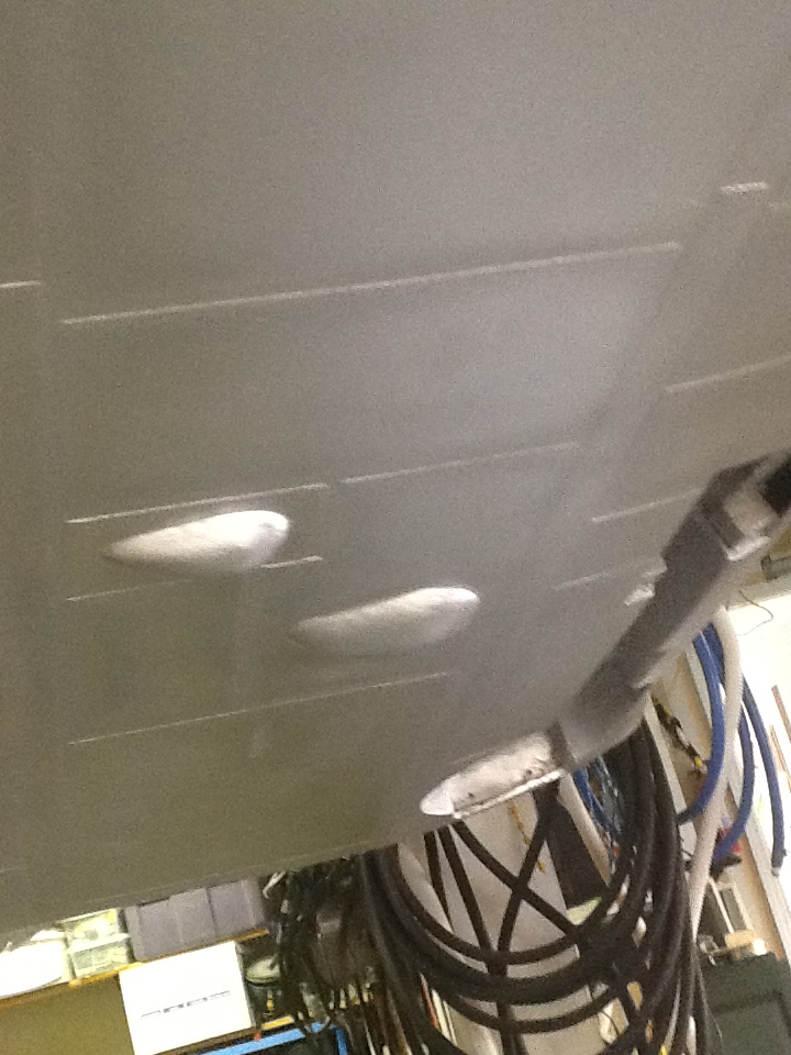

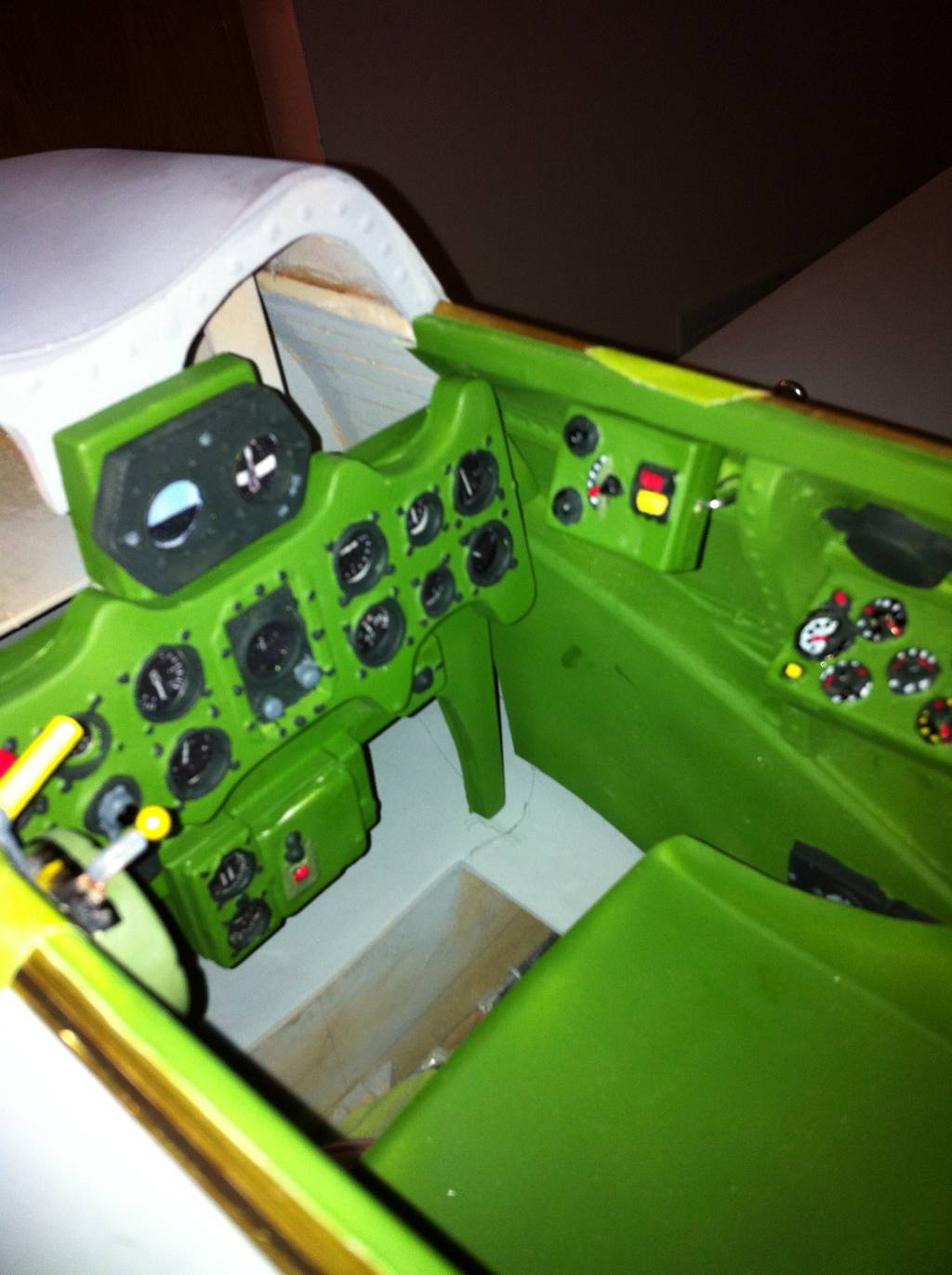

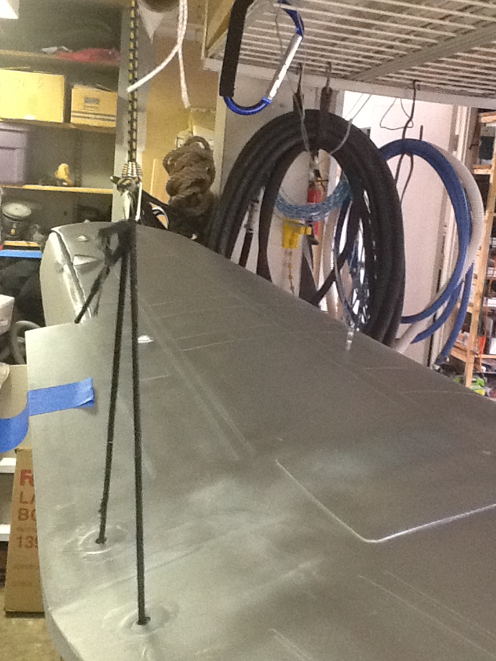

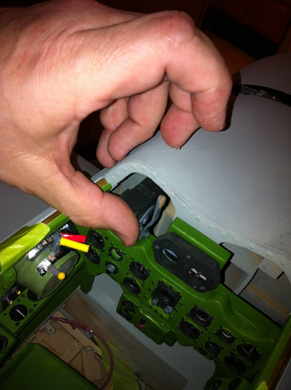

I finished glassing and priming this week.
Now I have a few last tasks before color coat:
1. draw the panel lines
2. lay down the chart tape
3. more primer
4. wet sand
5. pull the chart tape
6. hours of rivet marking
6. paint it aluminum rustoleum
I also have a few final body scaleing items. Not sure if i'll use the amunition hatch molded plastic bits and various hatches. I will make some of these shapes with flight metal before final priming.
Here's some photos with the cockpit kit taped in to check fit and see how cool it's gonna look. I am really pleased!
-Regards
-Skip

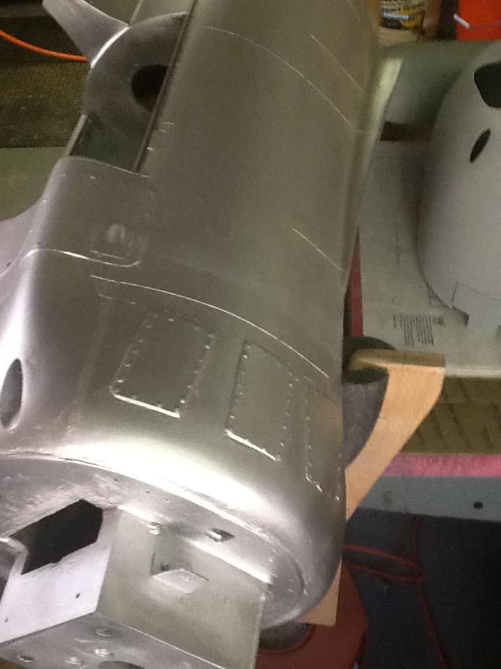

With the hurricane and all, I had a couple bonus hours to work on the Zero! Yay! Here's some shots. I'm still amazed at the size of this thing!

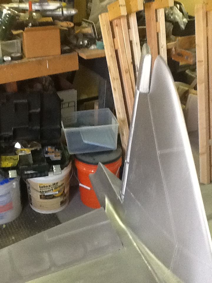

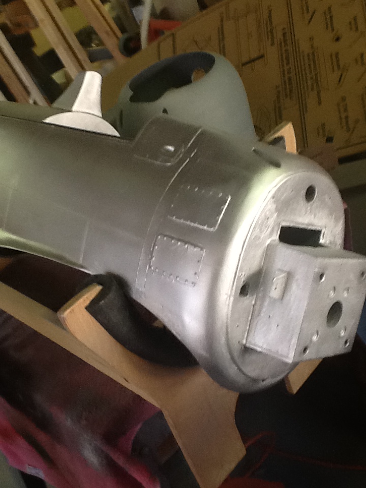

Making progress, between work and other projects!

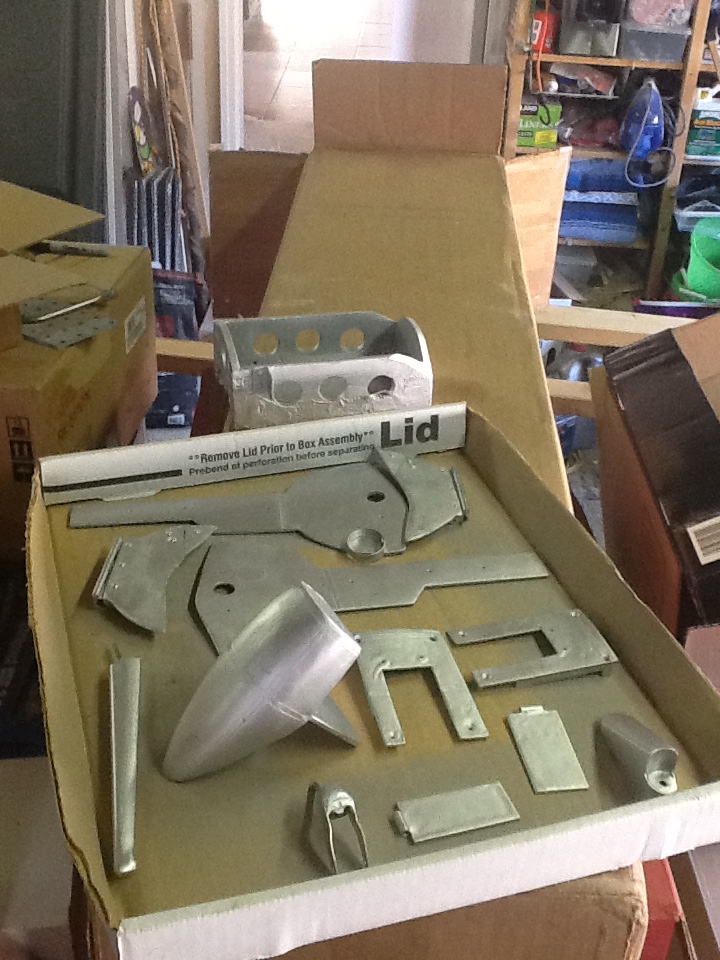

Base coat of Rustoleum Alluminum is on... next is color coat, and I'm torn between Imperial Navy sky grey and Imperial Army green...
