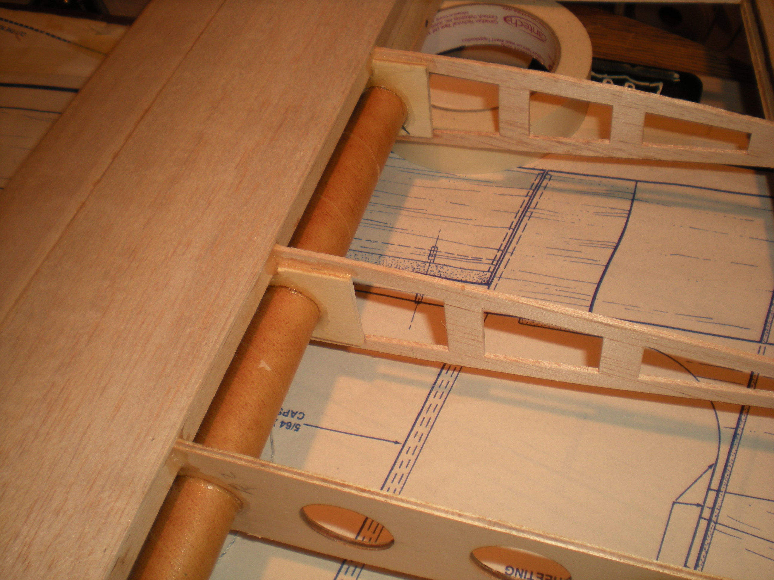

hi guys
ok i am going to build a gp goldberg anniversery cub kit i would like to use a two peice or be able to remove the end panels of the wings and leave the center on the plane i think that the wing has a dieheil of 3/4 ? how would i cut the holes for the tube and what size do u think i should use ,thanks rye

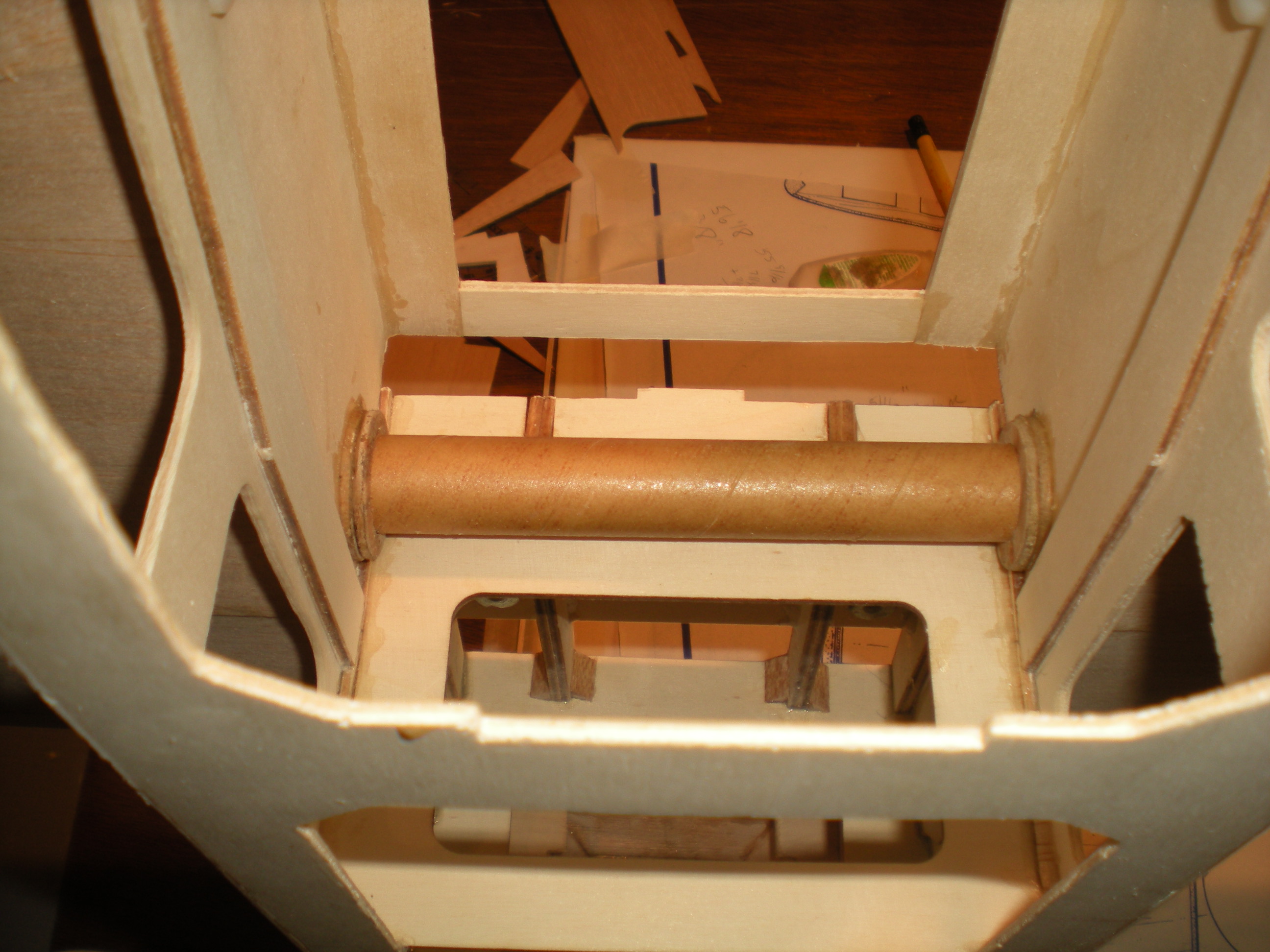

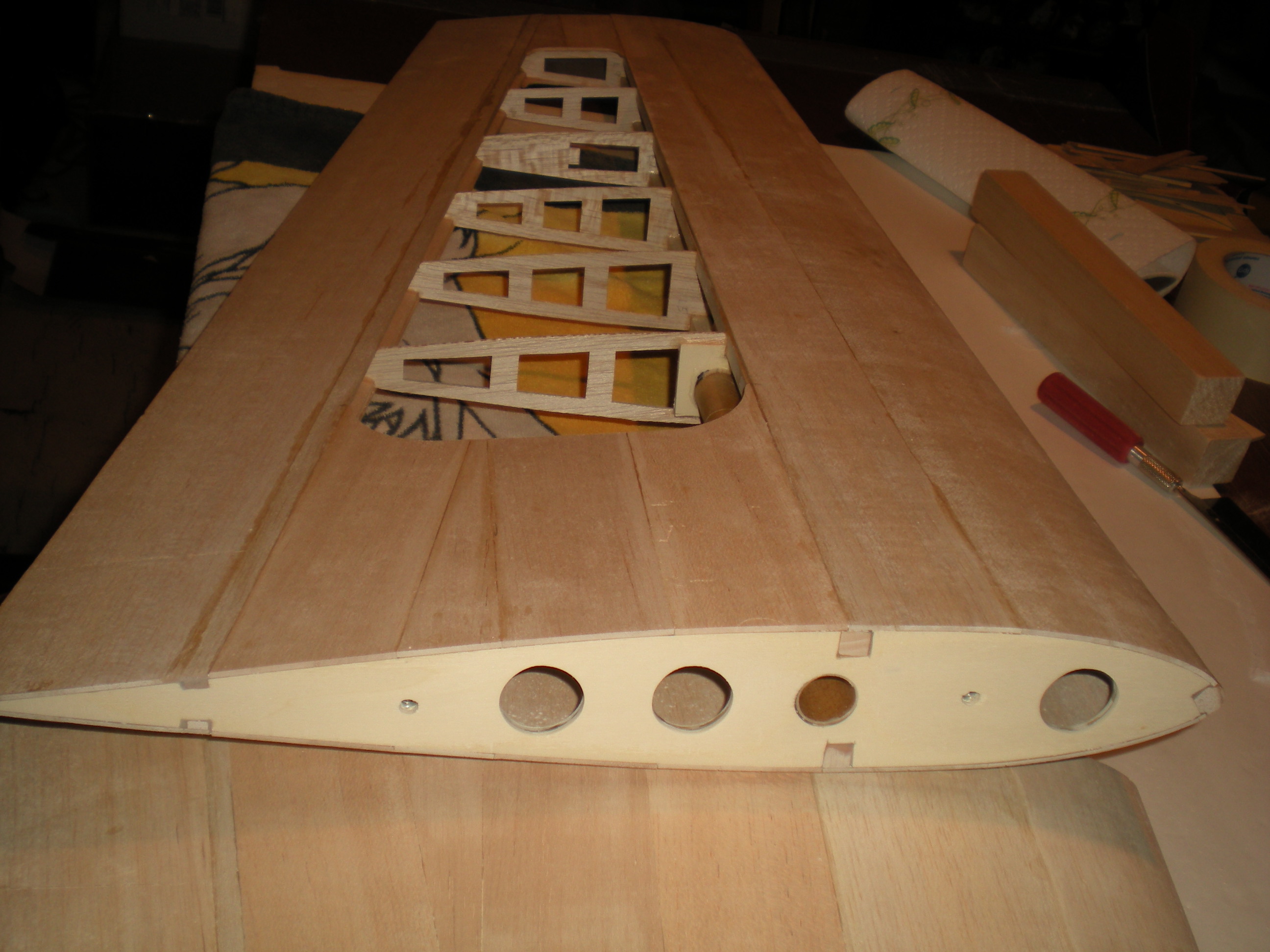

Funny you should ask. I just completed a Goldberg Sukhoi and added a wing tube. It came out great. I put in slight dihedral. My goal was to have the top of the wing perfectly flat, and all the taper of the wing on the bottom. To do that, when I cut the wing tube holes in the ribs, I maintained a constant distance from the top spar. It wasn't that difficult to do. The sukhoi has a similar wing span (72.5"). I purchased a 3/4" x 30" carbon tube from TNT, that worked perfectly. See the pics, they expain it better than I can.

thanks i am going to try it ,rye
