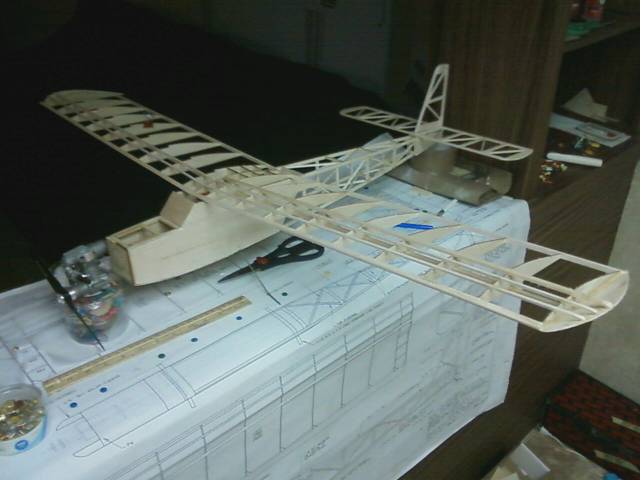

Heres the mockup after assembling wing using little metal clamps holding r/l panels in place. Balanced on fuse. and i taped the tail surfaces on real quick, for the absolutely beautiful mock up!Even set the engine on my bowl of clamps and stuff. SOOOO glad i went with trycicle gear. Dont even have the front lg yet and can tell its gunna look nice. Gunna use 2inch wheels. I still gotta beaf up the tail feathers and button up the fuse. when i get the stuff. Not to mention i gotta epoxy the joints on the right wing and do some sanding and wood filling on everything. Im gunna use the big style popsicle sticks which are a string light ply to beaf up the wing joint. Plus itl protect for rubberbands holding the wing, unless i decide to use nylon locking nuts which the ply will help then too. Im gunna laminate the whole center section of said wing. Gunna be bullet proof. Alsp prob gunna get some rattle spray can primer gray. And spray the entire fuse. once complete becuz i kno im gunna throat floats on it at some point and dont wanna risk sogie fuse. I love this thing...
P.S. We all established this was a gian engine in comparison to the airfriame but it looks right at home there on the Mtelemaster doesnt she?! Lol!

Old 05-19-2011 | 07:16 PM
  #54
cfircav8r's Avatar
Joined: Jul 2004
Posts: 1,244
From: Hampton, IA
Default RE: Mini Telemaster build. Glow conversion.
For covering I would recommend something along the lines of Coverite or Monokote. Coverite seems to have a better rep currently and is easy to work with. I have used both (although not monokote recently) and they should work nicely. The key to avoiding warping the wings or tail is to apply it to the flat bottom portion of the wing at the lower heat range. This gets it to stick without shrinking. Keep the wing flat as you start to shrink it up and work from the center out keeping it flat on a solid flat surface. Do the same for the top and after completed check it for twist, again using a straight flat surface. Idealy you should have the center section flat and the wingtip trailing edge up slightly (the same amount on both wings) giving you a little washout. If it is off twist a little past the point you want and heat the new wrinkles out and this will fix the warp. I would recommend the standard weight covering as it will provide more strength than a lighter low shrink covering.

Your pictures show a nice build up to now.
