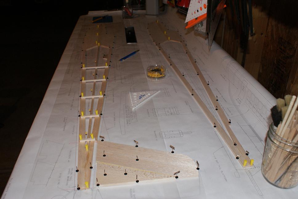

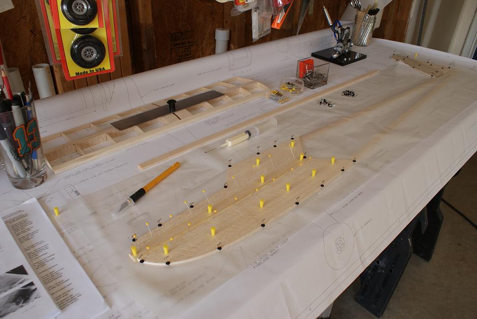

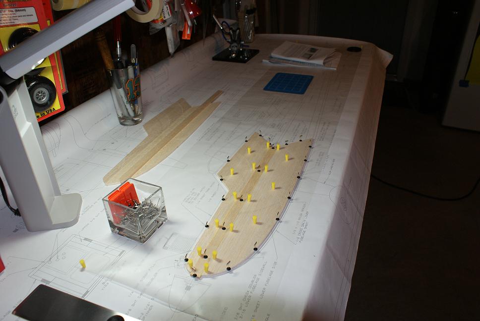

As I work on the 1st side to the fuselage today and have been pulling more and more lumber from the Hobby Lobby Telemaster 40, I have come to the following: The wood in this thing is horrible, looks like it was cut w/a cross cut saw, f/you younger ones, thats a 2 man saw, one on ea. end. Stringers are twisted and or bowed. Some parts look like a 1000lb break stamped it out. Is this indictive of the quality of product that the supplying company produces, or did I get a really poor kit. Oh yea, no there is no water damage to the box, as a matter of fact, the box is the nicest thing about the kit[&o]
Old 05-21-2011 | 10:27 AM
  #62
DUCO's Avatar
Joined: Mar 2011
Posts: 227
From: Lowell, NC
Default RE: Telemaster 40

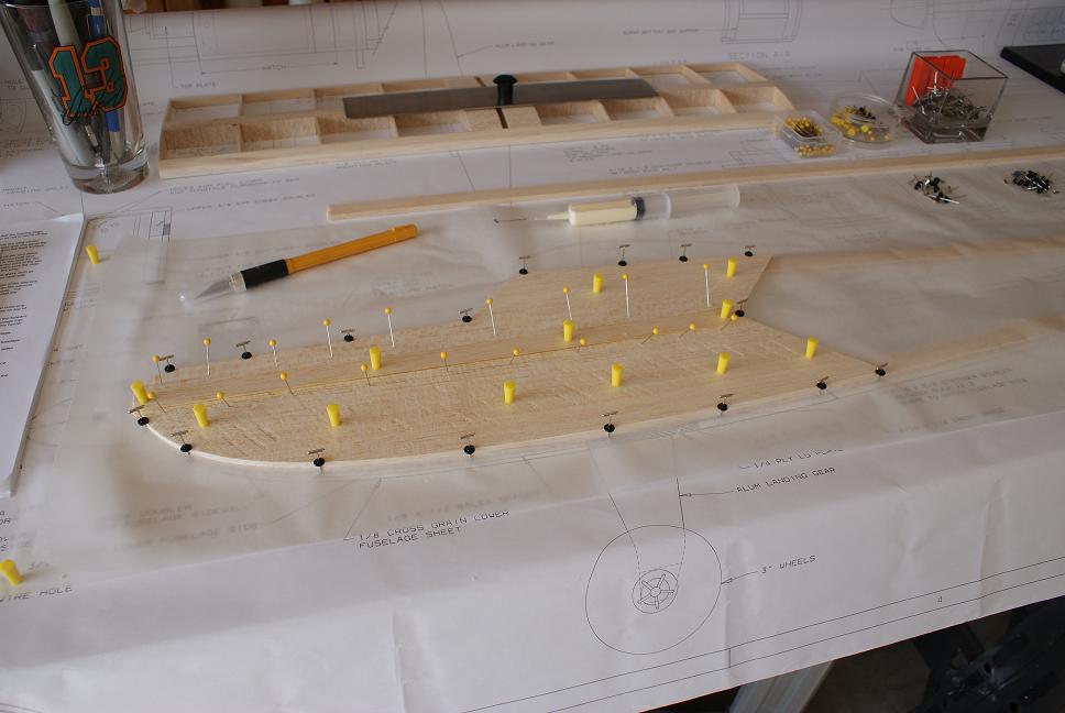

What I have done up to now:
ID:	1612127   Click image for larger version
ID:	1612128   Click image for larger version

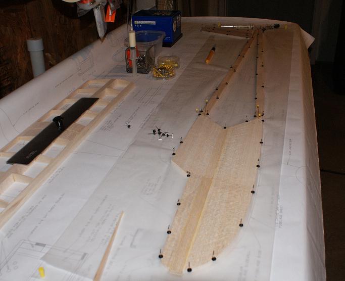

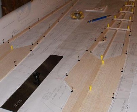

Old 05-21-2011 | 01:11 PM
  #63
DUCO's Avatar
Joined: Mar 2011
Posts: 227
From: Lowell, NC

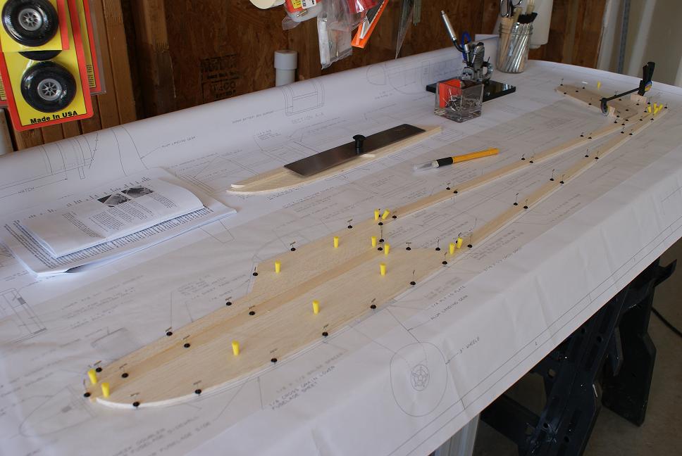

2nd Half of fuselage built over top of 1st, much like a giant rubber FF.[X(]
ID:	1612164   Click image for larger version

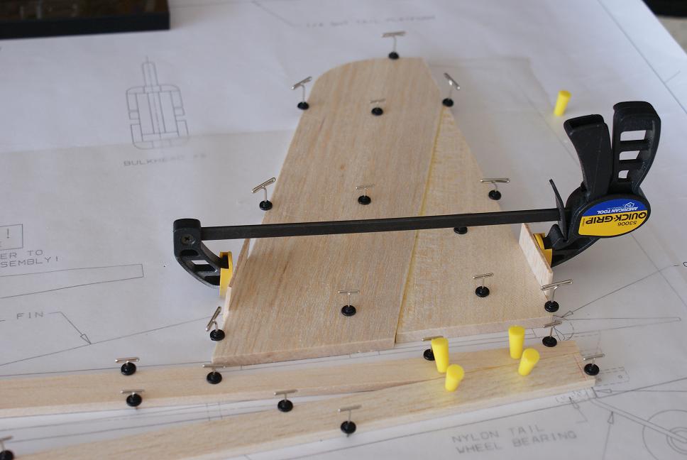

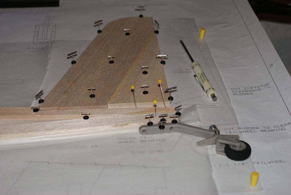

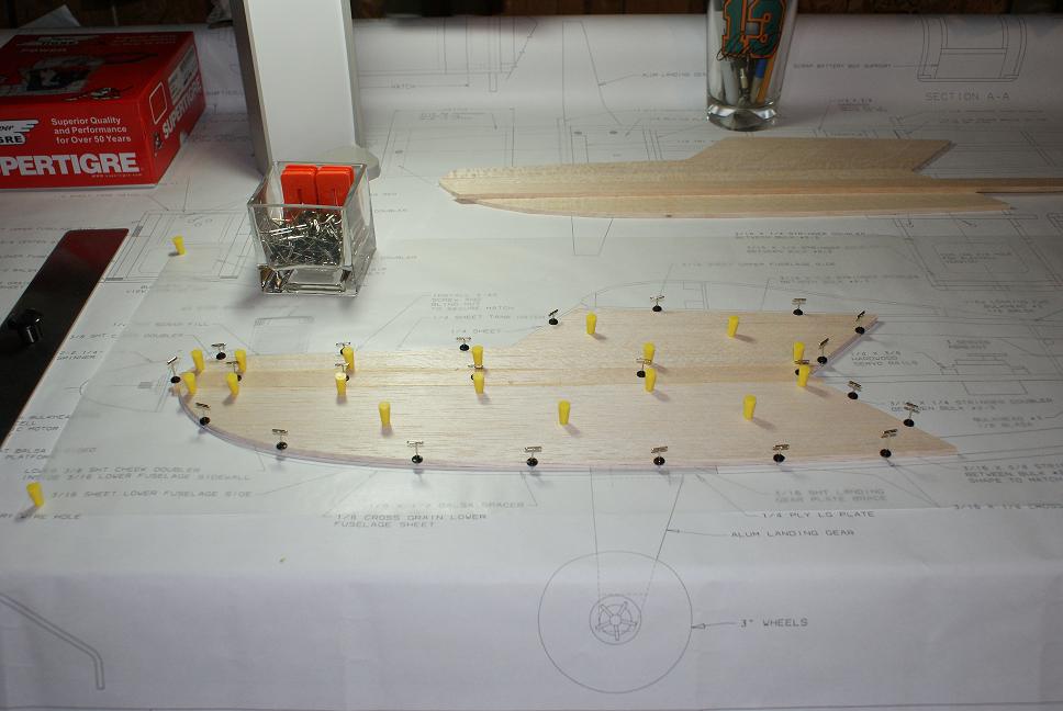

Both basic sides are up and checking to make sure the tail wheel assembley will work and I feel it is just fine though the plans do call f/a bit larger wheel.
ID:	1612853   Click image for larger version

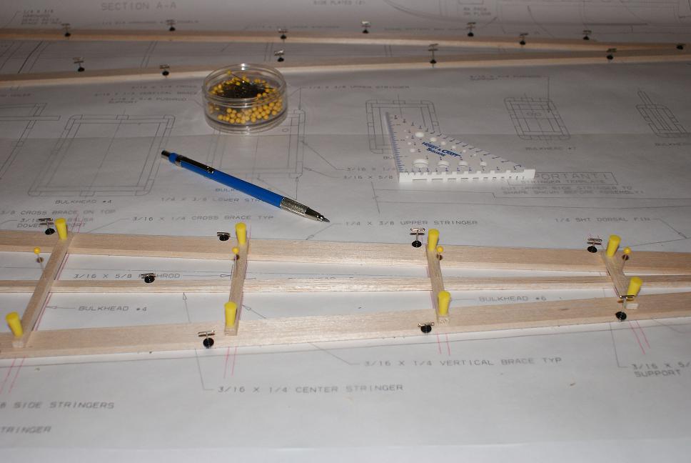

A few more photos.............
ID:	1613184   Click image for larger version
ID:	1613185   Click image for larger version
