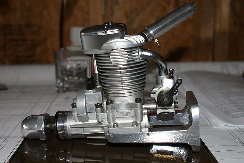

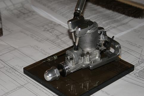

Went to my home town PO and signed for a jewel I got off of eBay. This is what I plan to use to power this beauty with.
I have $140.00 in it and so far I feel I have got a great deal, as of yet to fire and see how she pops, but from what I have seen so far, I'm not too worried about engine run condition. Great compression and the bearings feel great.

I like the older Saitos better. You have a gem for sure. That muffler is much more astheticaly pleasing.
Nice engine.
Brian
