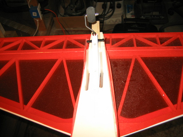

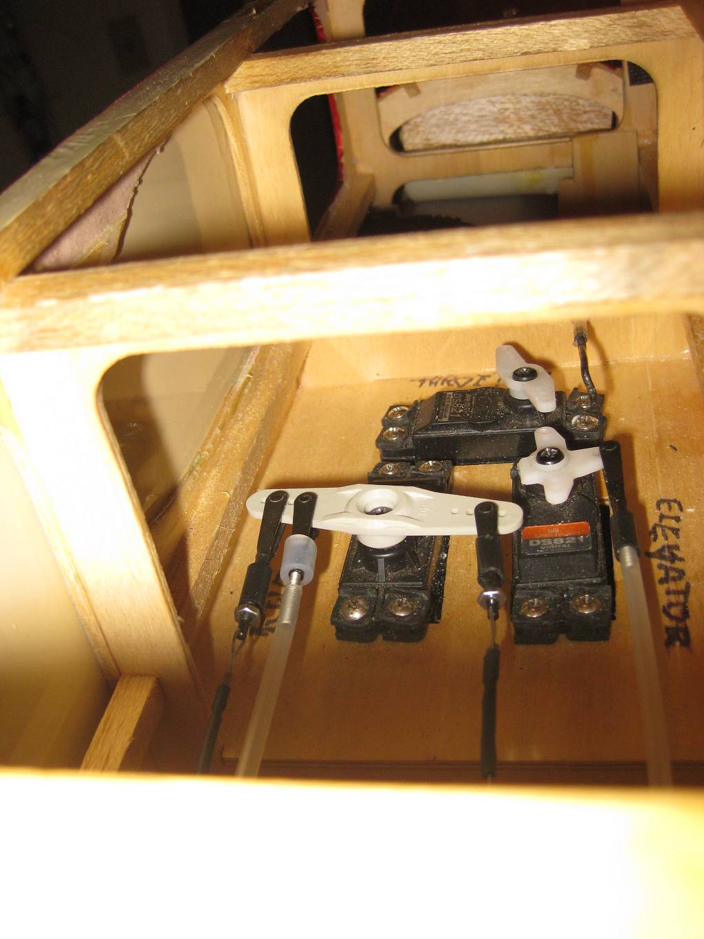

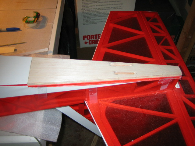

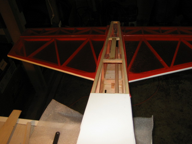

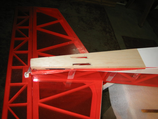

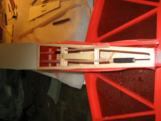

Hey Tom - another project?
I converted an ARF to a tail dragger. I used a second control rod from the rudder servo to the tail wheel assembly. A ply plate was added to the inside of the fuse, on the bottom. A couple of 2-56 blind nuts were added before gluing to the inside of the fuse. I think that I used a Sullivan tail wheel assembly - so the blind nuts were located accordingly.
An LT-40 uses the same fin/rudder stab/elevator approach as the Senior. This was a bit more involved as I fabricated a new fin. There was a reason - stab/elevator had been broken (hanger rash) so I was removing the fin anyhow. The trailing edge of the fin was extended thru the bottom of the fuse. I think that it was 5/16 x 1/2 stock. I cut a hinge slot in the post to accept a nylon torque bearing (like a one side of a nylon Dubro pinned hinge). This was prefect for a 4-40 wire. I was doing a new rudder so I added a block at the bottom of the rudder to accept about 1" of the 4-40 rod. A 90 degree downward bend, thru the torque bearing and thru the fuse bottom. A couple of bends and the axle for a 1" wheel was formed. Oh yea, I soldered a piece of 1/8" brass tubing to the 4-40 wire, slightly flared on the top. It was positioned so that the flare and torque bearing were snug. Did this so that the tubing flare will carry the weight of the rear of the plane - NOT the 4-40 wire sticking into the rudder. Works great.
Obviously, the Sullivan TW with a 2nd control rod was a whole lot simpler and didn't require much work at all.
I'll see if I have some pics of the easy approach.
OK- I lied - not a Sullivan TW(used that for my Senior kit built as a tail dragger). Memory typically fails me - they all look the same. The pics show using a hardwood spine used to mount the TW (not a ply plate with blind nuts). This was my first ever trainer and my first ever modification - so sue me
Also, the control rod was a pull-pull deal running thru a couple of plastic tube "guides".
If I were to do it again - what I originally said - not what I really did ...

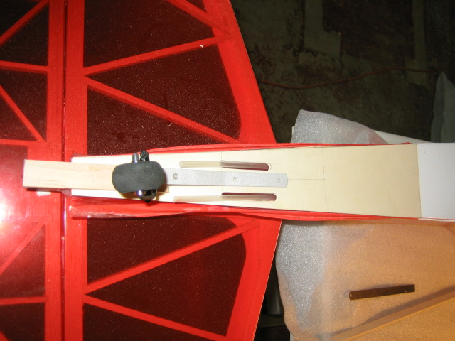

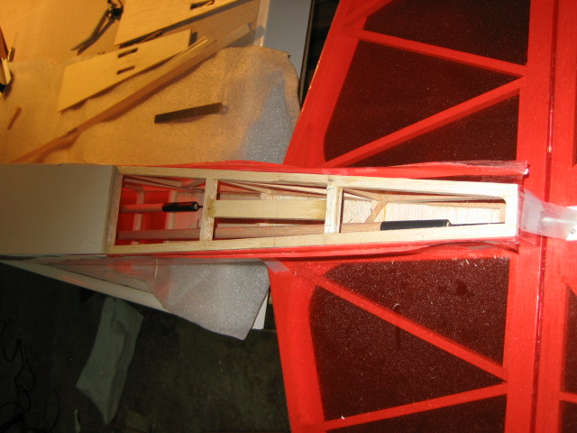

Old 07-29-2011 | 07:11 PM
Kmot's Avatar
My Feedback: (24)
Joined: Jun 2003
Posts: 10,963
Received 5 Likes on 5 Posts
From: Northridge, CA
Default RE: Sig Kadet Senior - Tail dragger conversion?

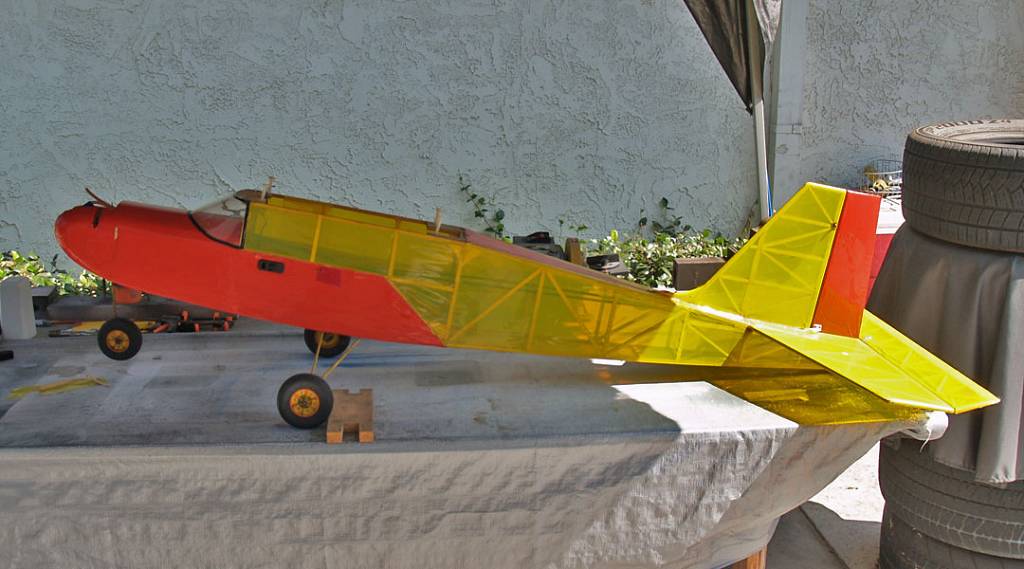

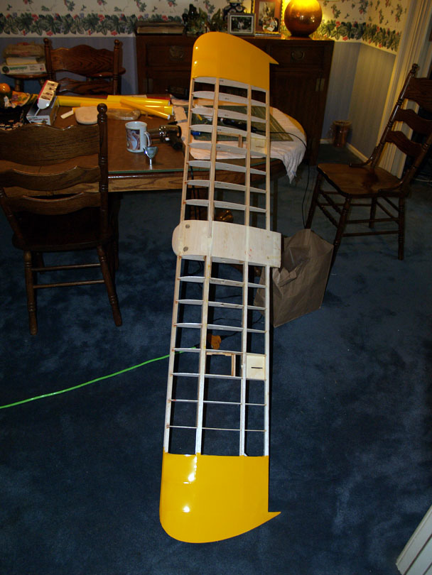

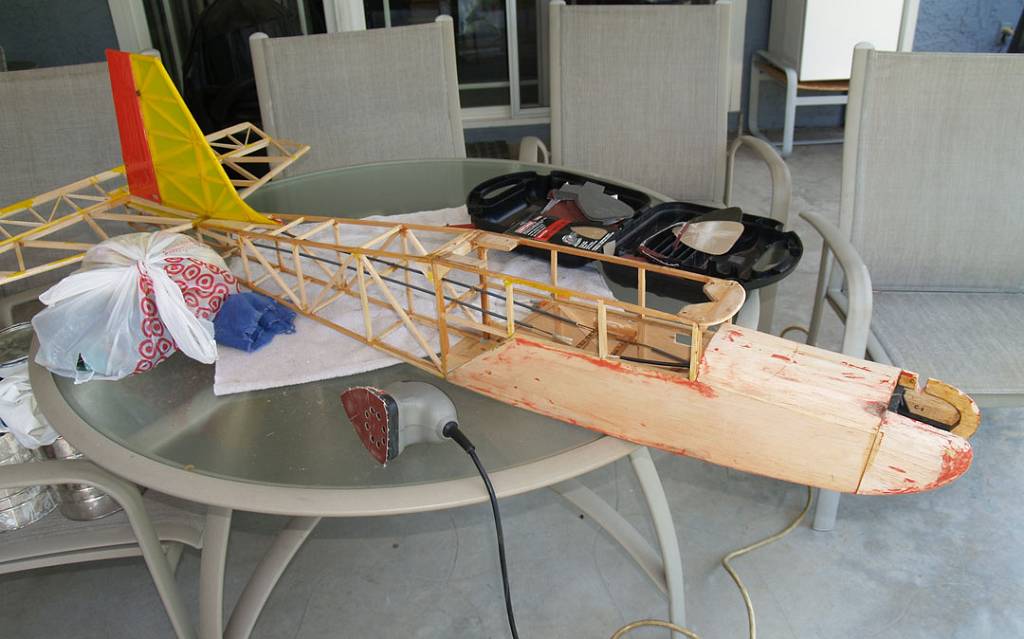

Thanks Seamus for the in depth reply!
This is a new project, but an old airframe I have had for years. The impetus to get going on it is because I want to have a "test mule" for testing out those 2.4 radio receivers before I install them in a 'good' plane.

Old 07-29-2011 | 07:14 PM
Joined: Apr 2011
Posts: 510
From: The Dalles, OR
I bought one used that is set up as a tail dragger. It has a rod running through the fuse to steer the rear wheel.

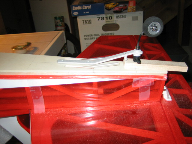

Old 07-30-2011 | 04:12 AM
soarrich's Avatar
My Feedback: (98)
Posts: 4,677
From: The Villages, Florida NJ

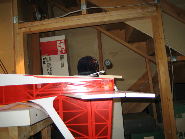

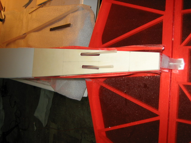

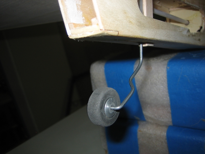

This is what I did, not high tech, but it worked fine, and was easy.

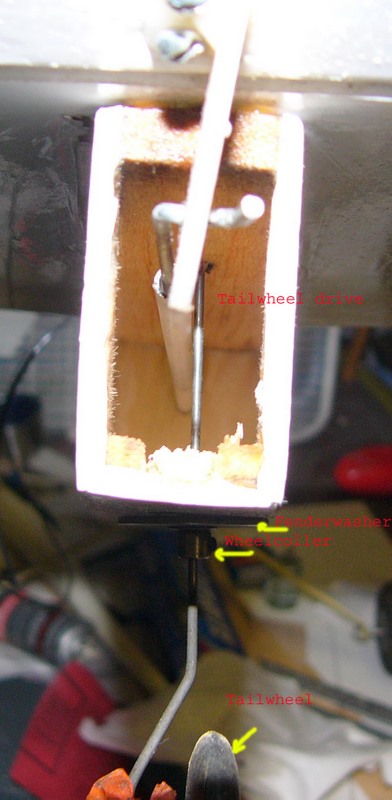

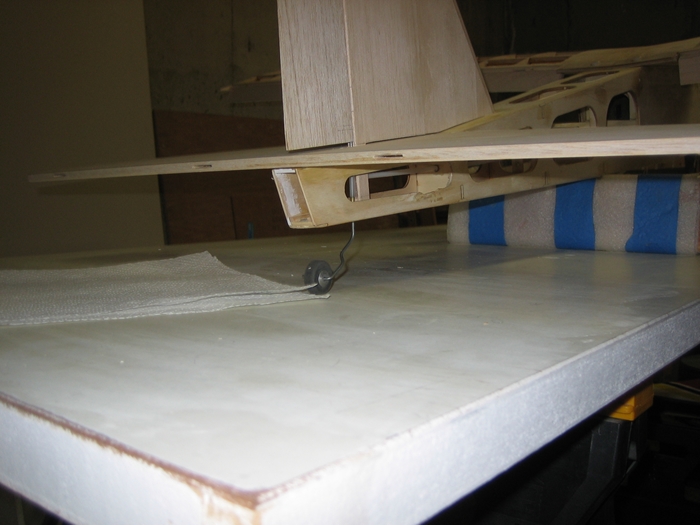

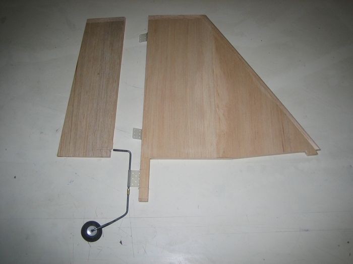

Old 07-30-2011 | 05:37 AM
SeamusG's Avatar
Joined: Jun 2007
Posts: 3,919
From: Arvada, CO

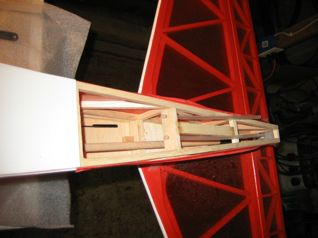

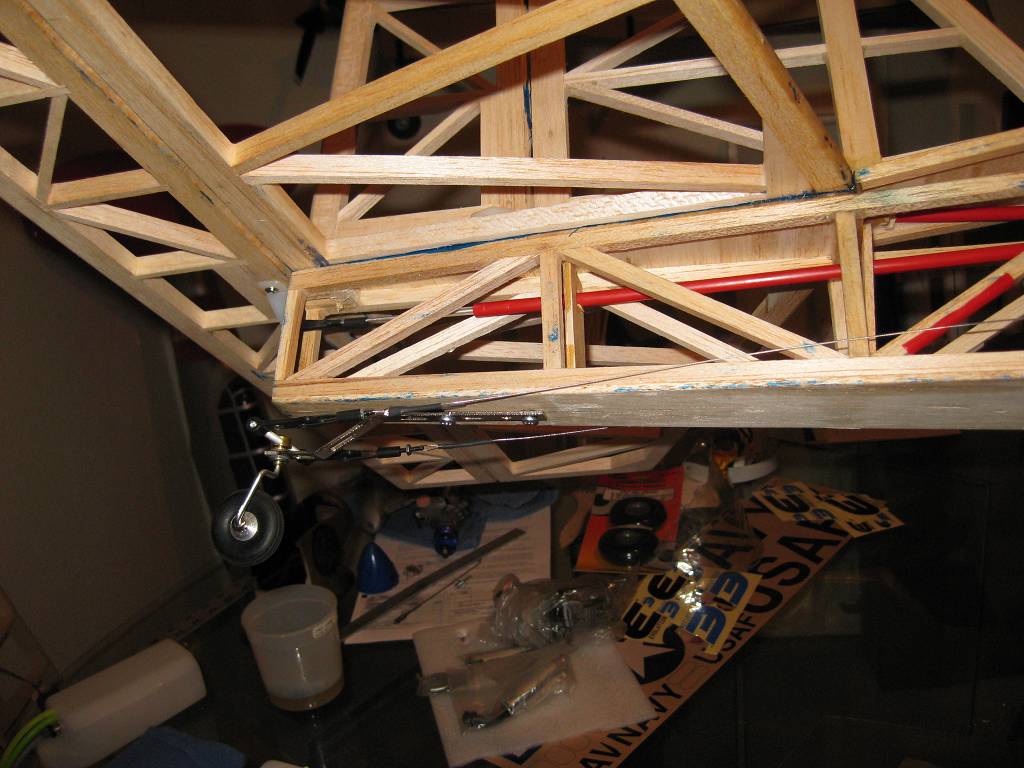

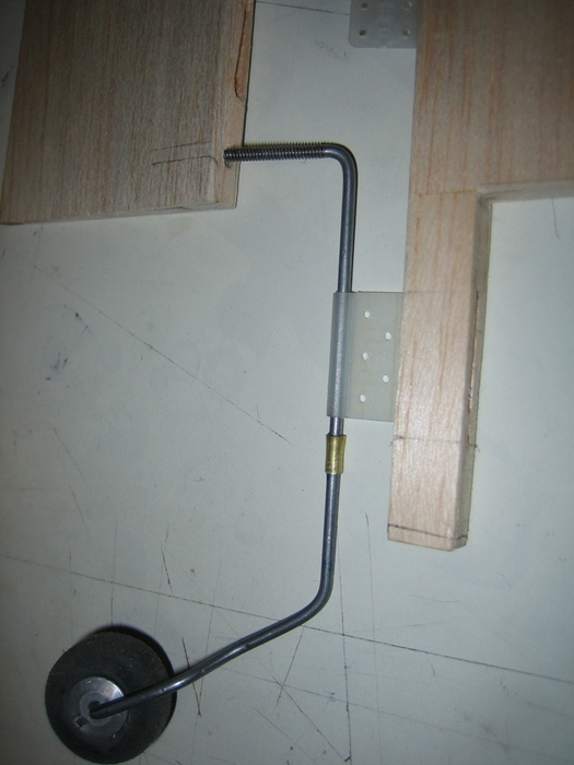

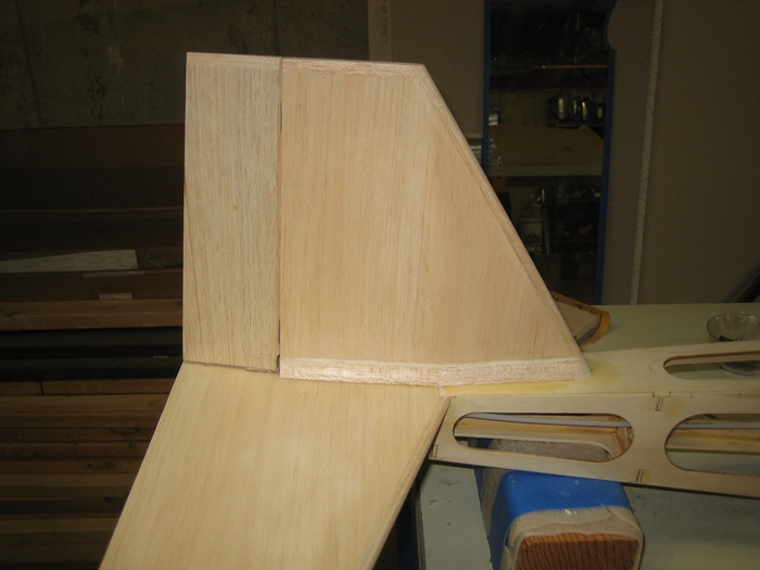

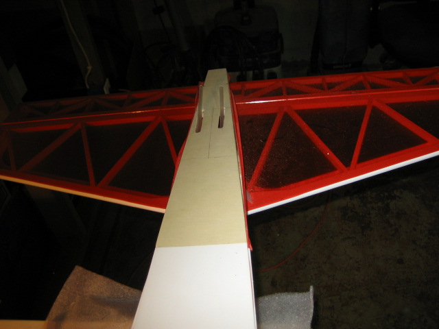

Iunearthed the pics of the LT-40 approach.

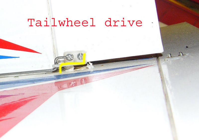

Iused a threaded 4-40 rod and inserted the threaded bit into the rudder to make sure that the 30-min epoxy had something to bite on.
The rudder &amp;fin are both built up and sheeted. I was practicing to improve my technique before I jump on my GPExtra 300S build. Finally got everything straitht after 3 attempts. Not saying I'm slow - but jeez - I used too much Titebond and it really warped the end product (yea - Iused weights for days).

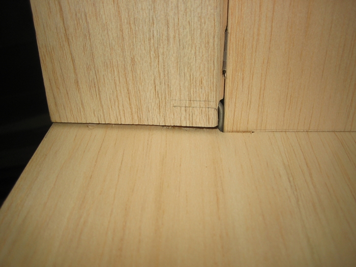

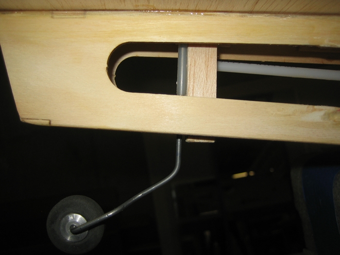

Not hard to do.
I drilled a hole up through the fuse bottom and made sure it came out right at the fin/rudder joint. Then I epoxied a bit of brass tube from an old ink cartridge in.
I got some control rod wire and did a 90 degree bend about 3/8" long in one end. I cut out a piece of the rudder a bit over 3/8" long and about 1/8" deep right at the edge.
I slid the wire in and epoxied it into the slot, reinforcing with a but of nylon mesh.
Next step was to put 2 rubber servo grommets with brass inserts onto the wire with flange ends facing outside. Put a wheel collar over that. Go down about a quarter inch below the collar and bend the wire back 45 degrees. Then bend 90 degree to the side, allowing enough to mount the wheels and collars. Finally, press the wheel collar lightly against the lower grommet and tighten the screw.
Did this on my Kadet Sr. and it has worked for over a decade.

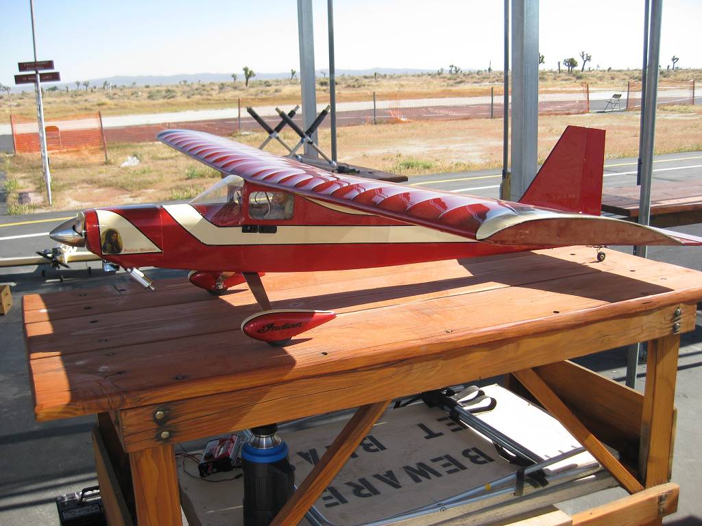

I converted my Kadet Sr. ARF to a taildragger usng a pull pull set up on the tail wheel. I set up the rudder on the same servo attaching the pull pull to the outside of the servo arm and the rudder in two wholes. This gives me more responsive ground control. I am running a Saito .91 4 stroke and loving it.
Grump Gorilla

Grump: Your KS looks awesome!!
I have two Klett tailwheels in my stockpile. A 40 to 60 size and a 1/4 scale size. The KS is a big plane. What size tailwheel should I go with?
BTW, I recently noticed that Dubro is now making the Klett tailwheels and selling them in three sizes.

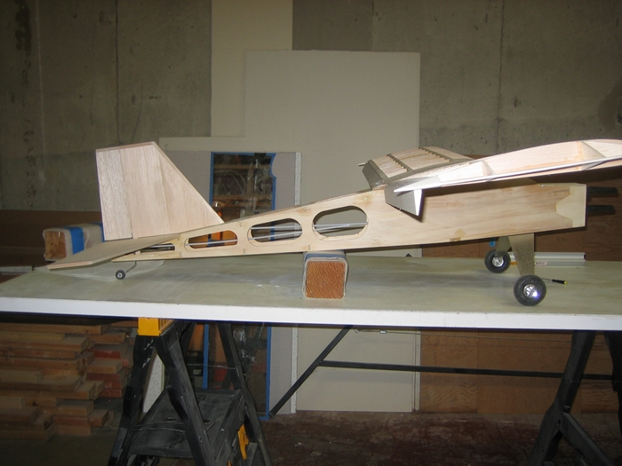

Here's where I am at with the rebuild. I waited weeks to get my covering material from Hobby King. Came last week and I got started on the job. I stopped so I could get a couple of boats ready for a regatta this weekend. I will start back on the covering next week and probably get the tailwheel framework started.
ID:	1663260   Click image for larger version
ID:	1663261   Click image for larger version
Sorry for the delayed response, and by the way I saw your pics later added. VERY NICE! Hope to see the completer project. Am out of town presently and do not recall the size of the tailwheel. I will check when I get home next week.
The attached pics may help. Note that on the servo I used a larger arm so that thewheel connectionwould not interfere with the pull pull on the rudder. After observing my own pics I see that I did just the opposite of what I said earlier in the thread. I attached the pull pull on theOUTSIDE of the arm instead of inside as I previously indicated.
Let us see how your Kadet turns out! What are you planning for power?
ID:	1664361   Click image for larger version
