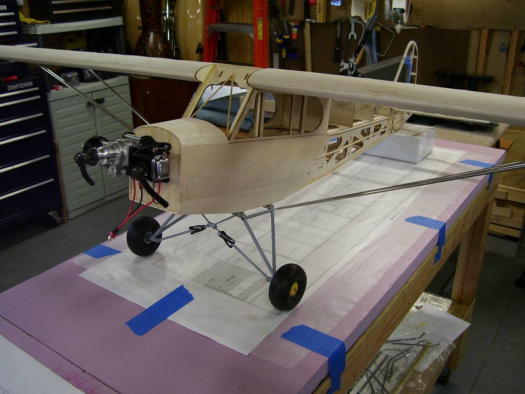

There was more than one request for pics...
Sig 1/5 Anniversary Cub with a Saito 90TS and Robart landing gear [8D]

Cool! I just started my Sig 1/5 Cub about three days ago. I'll will also use Koverall, and the same finishing method I've used a number of times before. Perhaps you already know much of this, but just in case, here is what I do:
I use Randolph nitrate & thinner, purchased from Aircraft Spruce, then use Brodak butyrate for colors (which is re-packaged Randolph); the Sig nitrate and buty dopes work the same. First, 3-4 coats of 50/50 nitrate on all wood surfaces that will touch fabric. Light sand after the final two coats. I adhere the edges of the koverall to the wood with very thinned nitrate (70/30). The thinner melts the built-up nitrate in the wood, and sticks the fabric down. After shrinking the fabric, I then lightly fill the fabric weave with more nitrate (roughly 50/50 mix again). Filling the weave will take several coats. Don't sweat about adding weight with each coat - as others have mentioned, the clear dopes weigh next to nothing.
My first color coat is silver, which easily covers the different shades of wood, glue, & filler used during construction (these different shades can bleed through otherwise). The silver creates a uniform color base, and will easily expose any gross flaws in the finish. Now is the time to fix the flaws, so they don't show. Then I will lightly apply a coat or two of Cub Yellow, then the black lettering & lightening bolt. I can go light with the final color coats because the silver creates such a good base. Don't sand the color, yet. Next, I spray on several coats of clear buty (about 50/50). I will lightly sand (600 grit wet) only after the second or third coat of clear, otherwise it's too easy to cut through the thin color coats. I finish the model with a few more coats of thinned clear buty, with light wet sanding as needed.
With some, or all, of the clear and color coats, you may have some blushing if you are painting above 60% humidity. Blushing is white, or milky, blotches in random areas of the finish. It is caused by the humidity getting trapped in the finish as the solvents flash off. No worries, as blushing doesn't hurt anything, and is easily fixed on the very last coat of clear. With the last clear coat, add some retarder, which will slow the rate of drying, and prevent blushing. Order a small bottle of retarder from Sig when you place your final order for dopes. Usually, you don't want to add more than about 10% retarder. The best thing to do for the final coat is to wait for a day when the humidity is less than 50% (good time to call in sick to work, hehe), and with a touch of retarder, the final clear coat will come out perfect.
