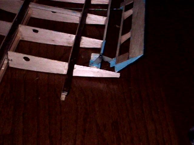

I found my file of digital pics on my OVERWEIGHT spruce and [X(]Ironwood[X(] (well whatever wood the spars are... it sinks in water) Kadet Sr. (darn thing was over 13 pounds) Someone scratch built this from the plans... and thought he knew more about the wood needed than Sig. It flew OK... but definitely not the way a Kadet was meant to fly.
How to predict where the pics will be so I can put the text in the right place? no idea.
I didn't help the weight problem by using a silk and dope covering on the plane.
This hinging may be of interest.

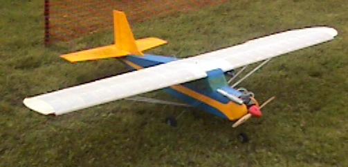

Well I'm happy to say my first gas plane and first kit for that matter flew great.....46 evolution works excellent. Minor adjustment to the front wheel and everything else was fine. Took it out last Sunday and she flys flawless. For all of you who said they wouldn't put ailerons on a Senior...I appreciate your input. I've seen it done and I was glad I did it. I like to build things so the time wasn't an issue. The fact that I was able to build this thing the first time and it flew great was worth it for me. I liked the challenge. Thanks again for all your input and help.
