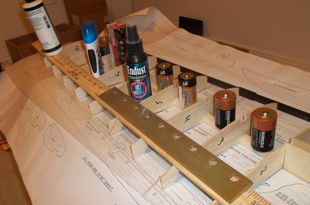

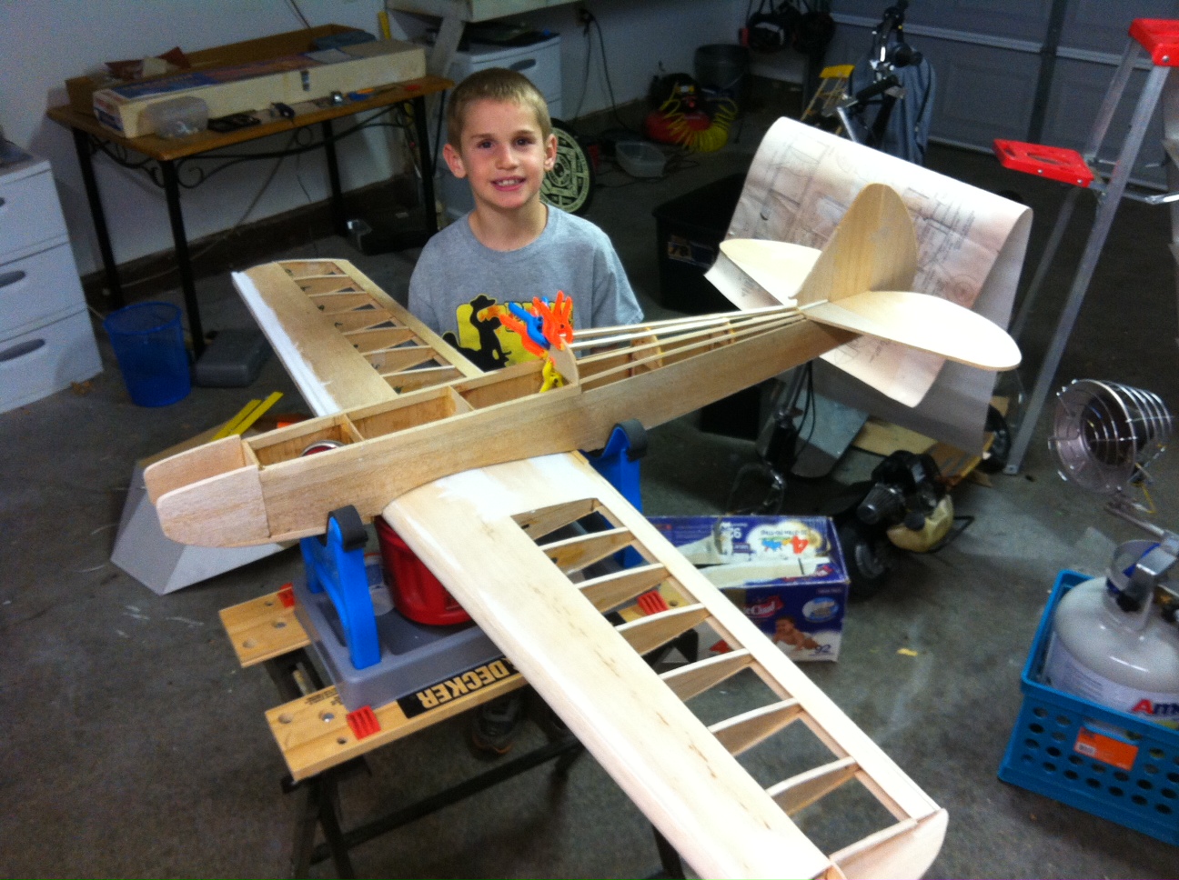

Starting to look like an airplane. Framing the wing up is what i dreaded most and so far nothing has tested my patients, it has been a joy. Only a few slots in the ribs needed to be re sized for the spars to fit in. The tabs on the bottom trailing edge of the ribs for support were cut accurately for the wing to sit level. I do not trust the two 1/16" ply pieces for the dihedral braces, i will be adding more braces or glassing the root. I have to remind myself to make holes in the ribs for the aileron harnesses as i will be installing two servos one for each aileron. All the ribs and spars are strait and square and i cant see any warp at this point. Maybe this weekend i will have enough time to at least have the left wing complete, maybe both.

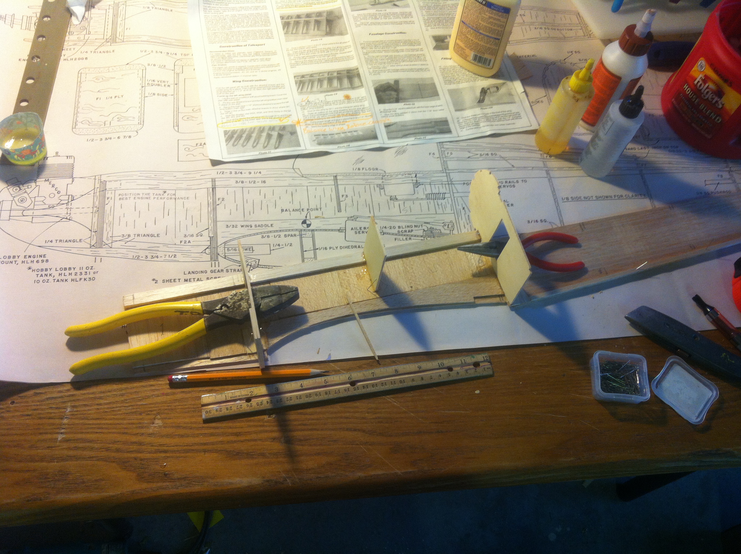

Well life happened this weekend so i didnt get much done. The left wing is built up and the right spar is glued in place ready for the right ribs. Ill take pics later.

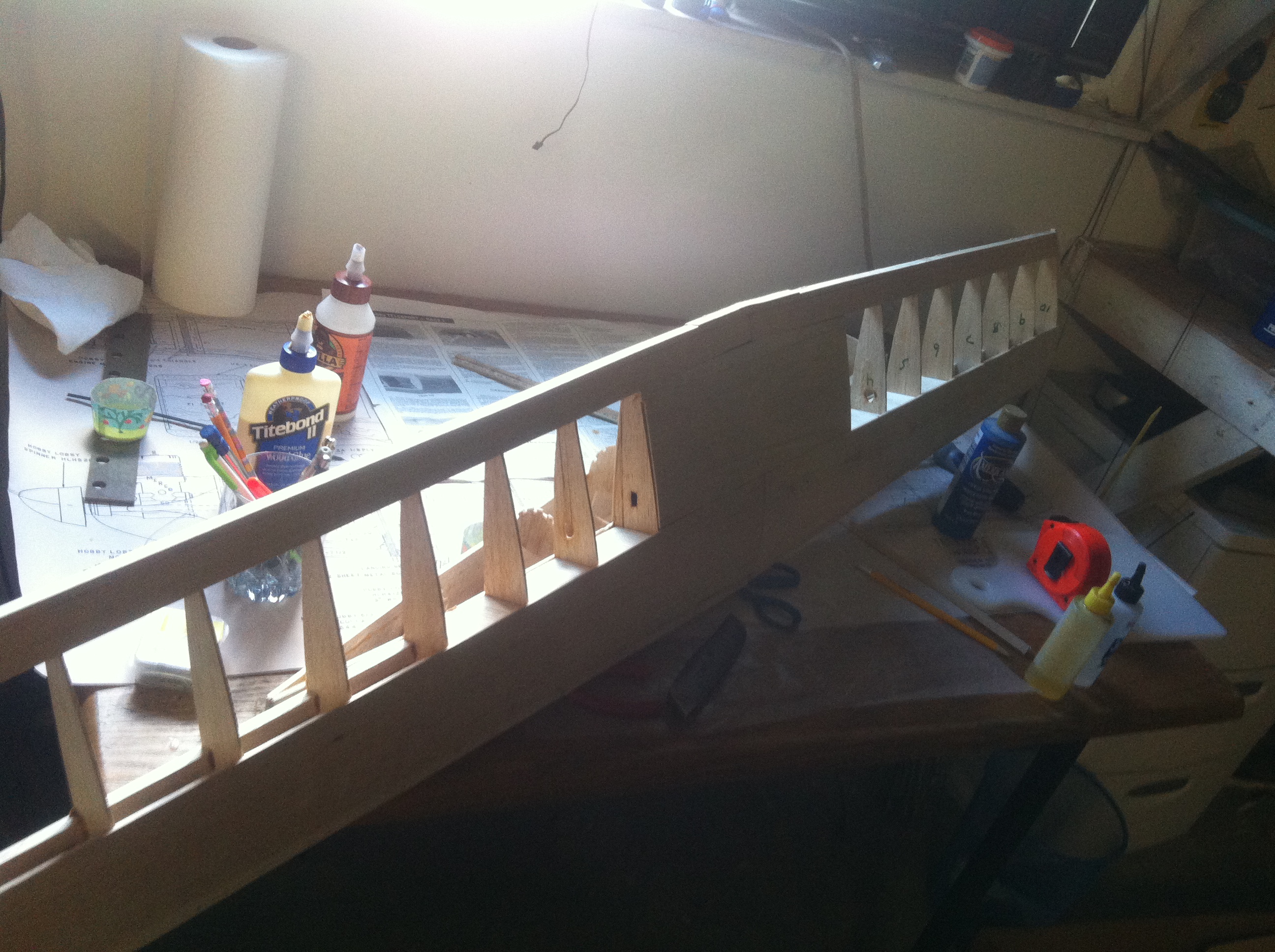

The wing is built up and ready for the wing tips to be glued on and then sheeted. be for i sheet the wing i will apply epoxy to high stress areas inside the wing like the root and landing gear blocks.
A few mods was i added an extra 1/4" dihedral brace in between the 2 stock braces. I also added some small 1/4" ply blocks to the leading edge of the ribs that are supporting the landing gear blocks, you can see that in the pics.
A flaw that is in the instructions which i didn't catch be for it was to late is it doesn't mention to glue the trailing edge dihedral brace in be for you glue the trailing edge balsa strip on, the plans show the brace in between the leading edge balsa strip and wing bolt support blocks. So i had to glue the dihedral brace on outside of the trailing edge. See pic. I will just have to work around this with the ailerons.

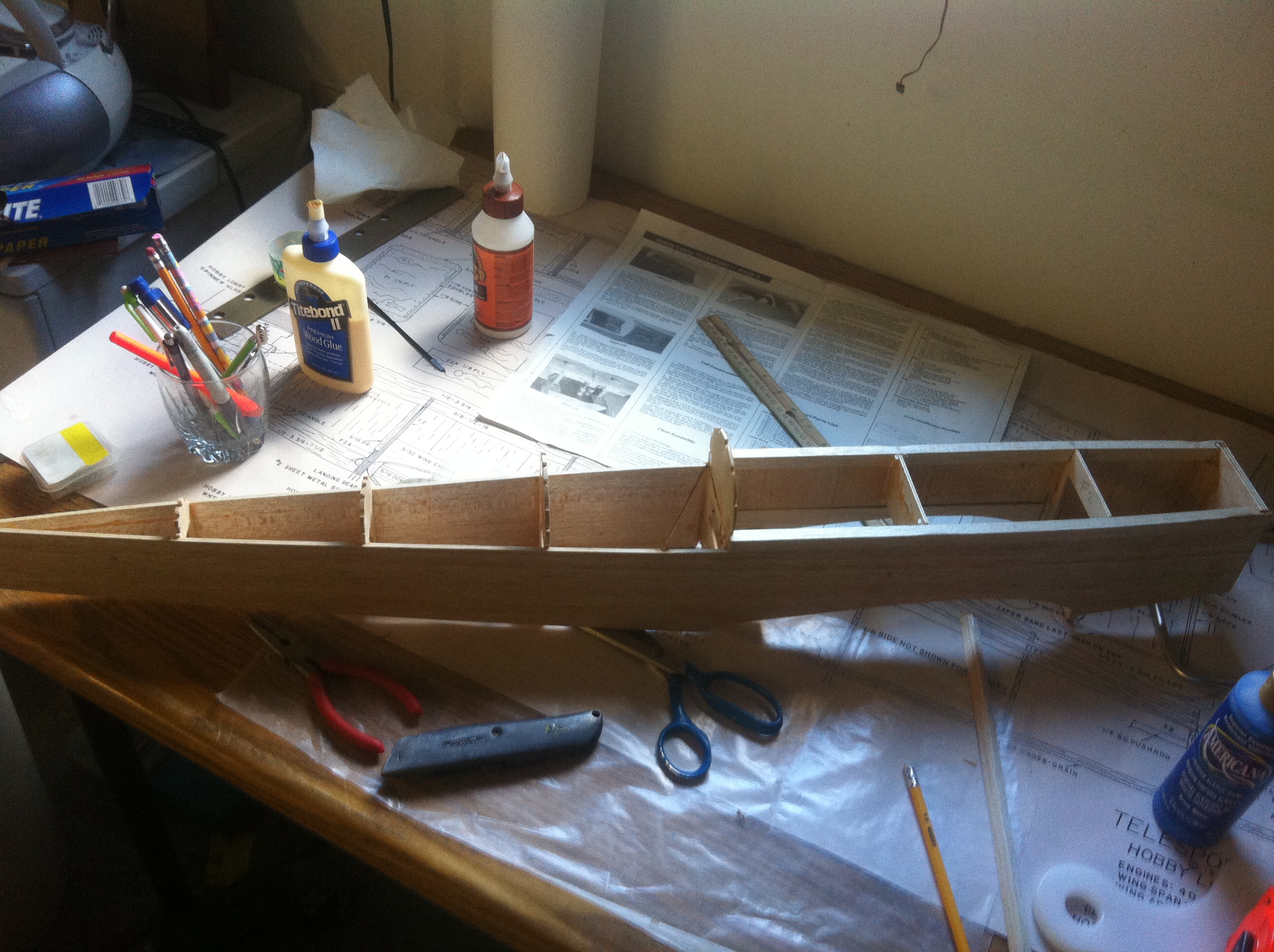

Ok so where was I? Wing is covered and ready for the leading edge to be sanded to shape, rib caps still need to be glued on. The fuslage has the sides glued together along with the firewall and formers. Recieved two rolls of monokote cub yellow and royal blue to mach the covering scheme on the box. Will be excited to get it ready to cover.
Sorry for the two year delay in the build thread. Went through some major life changes.

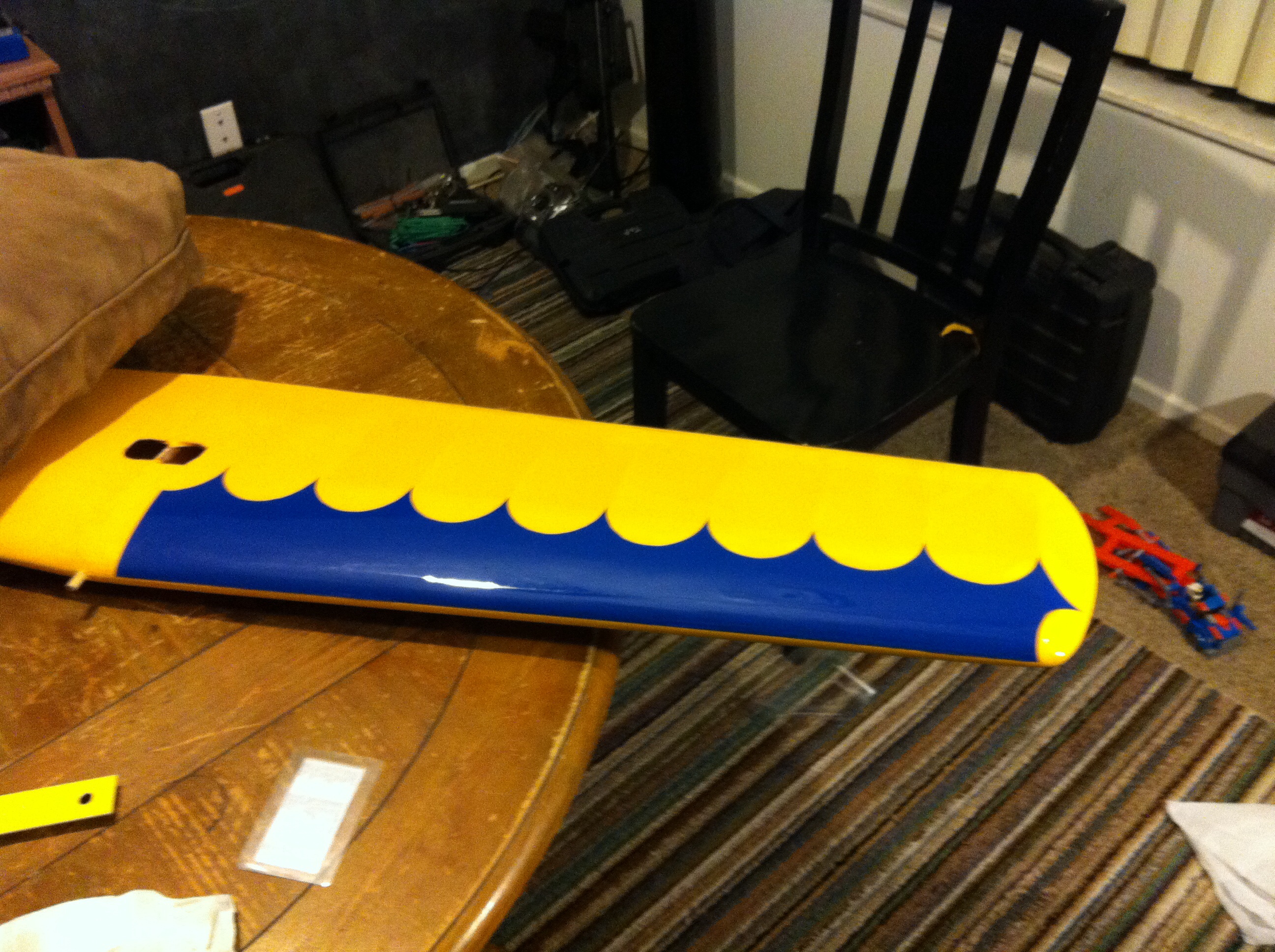

Got the wing ready to cover. Applying the blue graphics to the LE was easier than i thought once i developed a method. I spaced the scalops according to the ribs and used an aproprate sized cup to trace around. Slowly with a razor cutting it out then useing the windex method to apply it to the wing with a squeegy. I will go over it lightly with an iron to make sure it seals good after the windex is dry.

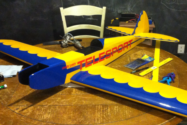

Wow i cant believe it took me this long! I had it finished a couple years ago and it just hung in the ceiling. We got some cooler weather and i woke up last Sunday at the spur of the moment it hit me, lets do it! My thumbs havnt shook like that in years doing a maiden. As you will see in the video my rates were way too high. I was being a stupid idiot, i should have known better. That led to a nasty little stall on my first landing but no worries shes built well. After lowering the rates and getting a good feel for it on the second flight i lowered the rates even more and had just a little to much fun on the third and final flight of the day. A little fun fact, this is the exact same place i maidened my first rc plane 30 years ago, the GP pt60 i talk about in my first post of this thread. This was a special day. And thanks to my sons for catching some great footage. Watch the pics at the end of the video for a good laugh.

Thank you for posting the maiden flight video. After you got the rates adjusted it flew great!

Yes i didnt realize how high they were. I don't think i checked them after i initially set my radio up a couple years ago. It came out heavy at 7 pounds! But it flys great and handles the wind like a champ. Forgot how much i enjoy nitro. Brushless has spoiled us over the years with ease of use.
