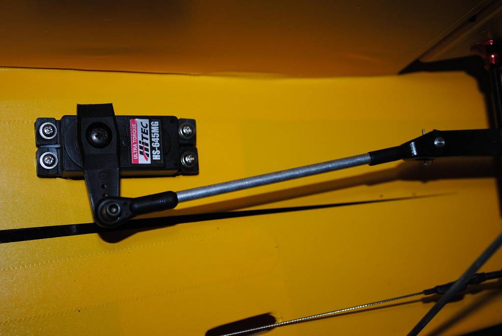

I make my rods using all thread but I add an aluminum sleeve over the thread all that the ends screws up to. This will give the control rod good strength in the compression direction.
This will work with clevis ends or ball liks in 2-25 or 4-40. I prefer to use ball links. (see atatched pic of the elevator linkage on my 1/3 Cub.
Later!!
Anthony

Default RE: contol rods
That looks vry sharp, Anthony. I am going to copy your technique!

Thanks Skip,
It makes for a very strong slop free linkage.
Anthony
