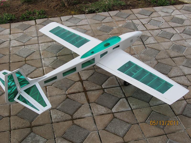

I still haven't figured out if the beast below is a Total or Utter Kaos (the box cover said Utter, and the plans said Total) but as has been said, it flies very smoothly, and will do all the basic roll/loop/pattern manouvers, either upright or inverted. It will even knife-edge OK. I modified the tail feathers to use truss construction instead of the solid balsa in the kit, as well as cutting the "windows" in the fuselage. I really thought it was going to come out tail heavy with the big long fuse, but it balanced pretty well on the recommended CG. For whatever reason, I got a wild hare idea and used electrons to power it instead of a glow engine. (400Kv motor, 60 amp ESC, and 2x4000mah 11.1 V 50C batteries in series) If I had it to do over, I'd opt for a 60 2Stroke.

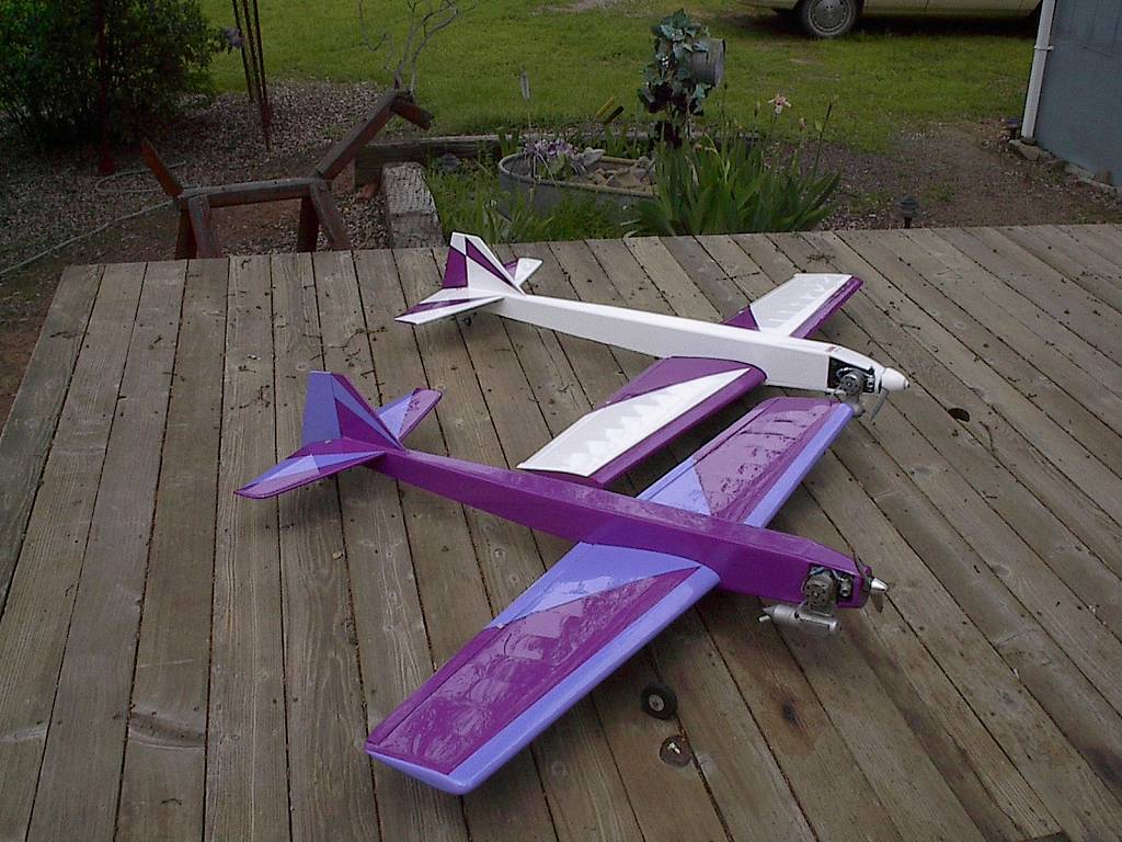

The white one just got it's third cover and the other it's second in this photo. I just lost the white one after it's forth cover job. Yep, very old originals, I lost my 80 inch Kaos soon after I lost the 60. Then I gave the Dirty Birdy a try and really liked it. With the minor mods done to the different Kaos design it's usually hard to tell what model you have. They are all outstanding planes, anything Joe designed is outstanding.
