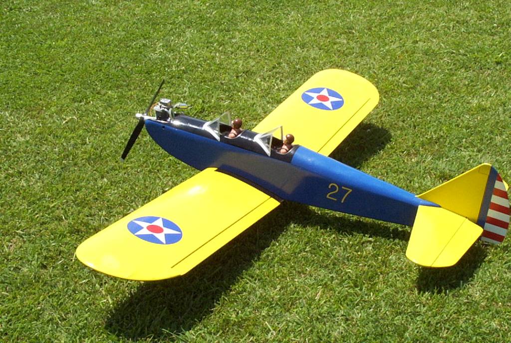

Let me know if you go that route, I may still have dimensions for the bash. Also I used the Great Planes Stearman windshields and painted them silver. Needed a little heat gun work but turned out good.

First cockpit opening is 6 - 1/8 inches from F1 and the second is 13 - 9/16. Obviously you will need to build floors for each. I also used Great Planes Stearman windshields. Took a little head gun work, but they turned out good. Also reshaped the rudder based on a side view of the PT 19. Good luck and do what you can to make the tail light. Mine required a nice chunk of lead to balance with an 80 4 stroke. Also rake the landing gear as far foward as possibe, she likes to nose over.

A tip or two to keep in mind when building the "Hog" bashed or otherwise.
1. Drill the holes in the former in which the wing dowels are fitted before building the fuselage. This will make fitting the wing much easier later on.
2. Remember a tail dragger version of the "Hog" requires longer landing gear wires for prop clearance which is not included in the kit.
3. Consider using 3/16" music wire for landing gear as the 5/16" wire provided is more prone to bending back from landing. (A wider landing gear block will be needed to accomodate 3/16" wire which is available from Sig).
Good luck,
DaveB

Found plans for a 62" WS on net. It is a Gene Rogers design. Had the plans printed full size. Now I am in the process of trying to compute just how much of each type of wood I will need. I have never built a scratch bild before. First time for everythng! One in my club suggested I cut out the ribs and formers from one of the two sets of plans, glue them to the wood as a timplet. Others suggest dracing them out onto hard material and trace around on the wood. Looks like it will take most of the winter to do this. Of course any suggestions on procedure would be greatly appreciated.

Well I finally started on the build of the Gene Rogers PT-19 plans/design. Copied all the wing ribs, 10 per side, onto heavy paper. Actually it was file folder paper. Got all 20 of them cut out of 1/8" balsa. On #2,3 and4 there is 1/16" ply doublers. That is cutting out an additional 12 front half of the ribs. I'm cutting stuff out on my jig saw but only able to work about 2 hours per day. Bending over that saw is hard on the old back. Of course after cutting out there is the edge sanding for uniformity. The spars are 1/4X3/16. The LHS does not have that size bass wood. I'm considering cutting the spars from 1X4 finished pine from Lowes. How will that compare to bass wood? The other side is to use balsa, but I question the rigity that balsa would have for the main spars on a 63" wing, even though it is reinforced in the middle with fiberglass. Comments would be appreciated, Also if any one has built this plan before,your comments would sure be appreciated also. So far it seem like it is going to be a real challange for first ever scratch built, just slow for an old toot.
