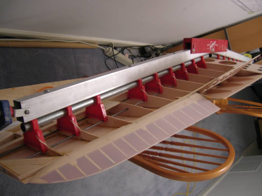

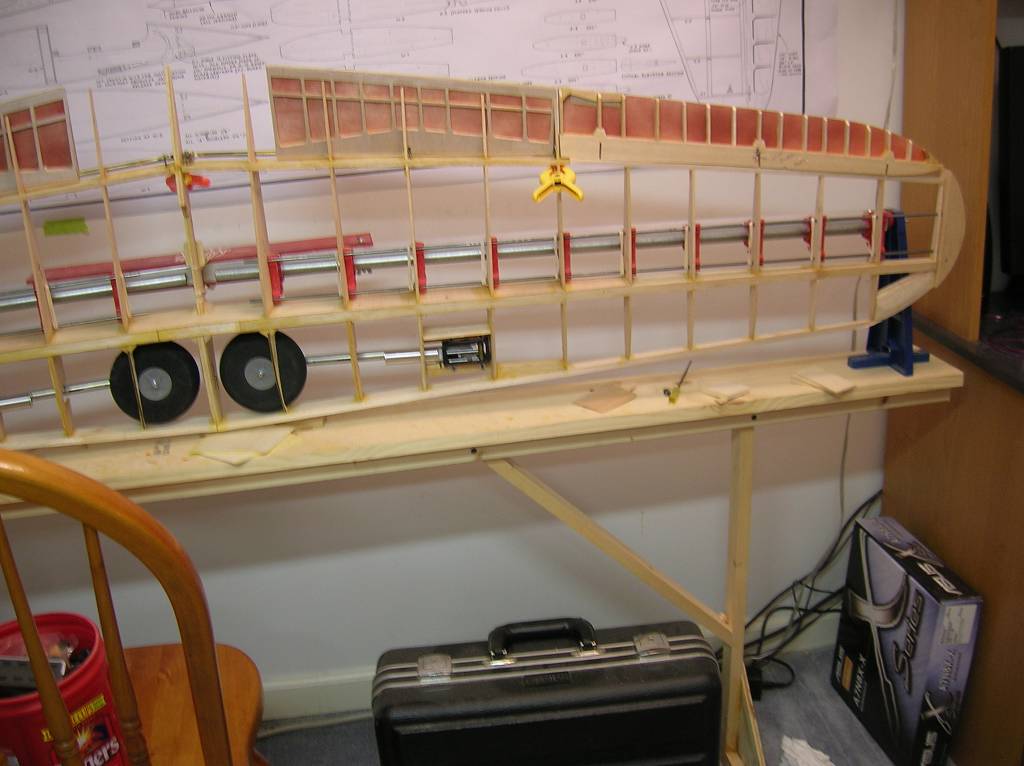

Old 02-20-2012 | 05:57 PM
Joined: Jun 2005
Posts: 90
From: Bradenton, FL VA
Default RE: Building Boards
I really liked building my last two wings on my a-justo-jig. Everything is as straight as I can measure.
My wing was one rib too big for the jig, so I extended the rods out past the end. The risk of the last rib not being perfectly in-line was very minor.
I also had to be able to remove one rib brace from each wing when the aileron ball-crank was installed. I cut two of the jig rib braces in half, and rejoined them with a backing plate. Next time, I'll use those two braces in the place where I'll need to remove a brace.

ORIGINAL: tomfiorentino
Is that how you would do it?
As long as the table is RELATIVELY flat (less than 1/32 over 36 inches) it's really not going to hurt the dihedral over a 73" wingspan

Is there a way to build a long flat fuse on an Ajusto Jig?

Hey Skip,
I am assuming you used the rib alignment template of the Adjusto Jig to make the holes in the ribs...any issues with using that part of the system? Any "if I did it over again" tidbits?
I recently picked up an Adjusto on ebay and plan on using it on a large bi-plane; but just don't want to become proficient with the jig by the 3rd wing half!
I plan on using my slate table, and magnets to lay up the fuse, tail etc. I have done a lot of reading here on RCU as well as the Airfield Models site and I am very intrigued by the magnet system and the fixtures that are used to get something all together, lined up and double checked before glue! Plus that system caters nicely, in my opinion, to building with CA adhesives. I can understand the joint being properly fitted, tight and secure while the thin CA wicks into the balsa to hold everything together....nice!
