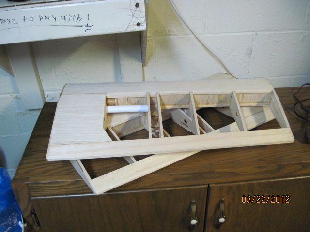

Question 1,2: I am building my second Sig Somethin' Extra kit. I bought 3 of them. The first turned out very nice (I think) for my fourth building attempt, except for the weight. The manufacturer says they should be 4.25-4.75 lbs. Mine first came out at 5lbs 12 oz. I changed some pieces (maingear and tires no wheelpants) and got it down to 5lbs 9 oz. I am using a 55 ax which adds maybe 4 oz over a 40 size engine. I use 4.8v futaba battery-standard servos and mini receiver (6ex package) 8oz dubro tank, regular monocoat. I used paint for fuel proof and for looks inside the cowl which may have added to the weight problem. I use tristock on leading edge of control surfaces. Other than these things, it was built per instructions. My first question is what kind of weights are you guys seeing with this model? I have built other Sig kits and usually the same way -steel rods, tristock and biggest powerplant and fueltank recommended. I usually end up around 4oz. over what they say and think that is reasonable. This model seems to be way out of spec though. Should I be sanding more wood to get closer to weight?
Question 3: I have the wing panels and basic fuse completed on second kit. I was standing around looking at it and deciding on whether to deviate from the plans and put a fuel hatch on it. Then I thought some more and remembering my porky first kit thought I could build a "Nothin Extra" by putting a flat hatch over the fuel tank, a flat light weight hatch over the wing/radio access area and while I was at it, leave the turtle deck off and just make the whole top of the plane flat like an Ugly stick and save a bunch of weight. Has anyone tried this and if so, how did it work, how much does it weighand how does it look?
Question 4: When I crunch some numbers comparing pieces from my 2 kits, it looks like I could save around 9 ounces. I admit that is significant, but I am still suprised to see that even if I were to go the "Nothin Extra" route, I will still have a plane that will be closer to 5lbs than 4-1/4 lbs like you would think a stripped version should be. So I guess my fourth question is could you guys please answer questions 1&2??????
Photos show fuse fuelproofed (epoxy) lightly sanded (10.3oz). Wing panels lightly sanded no jhooks, sevosor placement dowels (15.2 oz) Hatch from first build and turtle deck material (5oz)

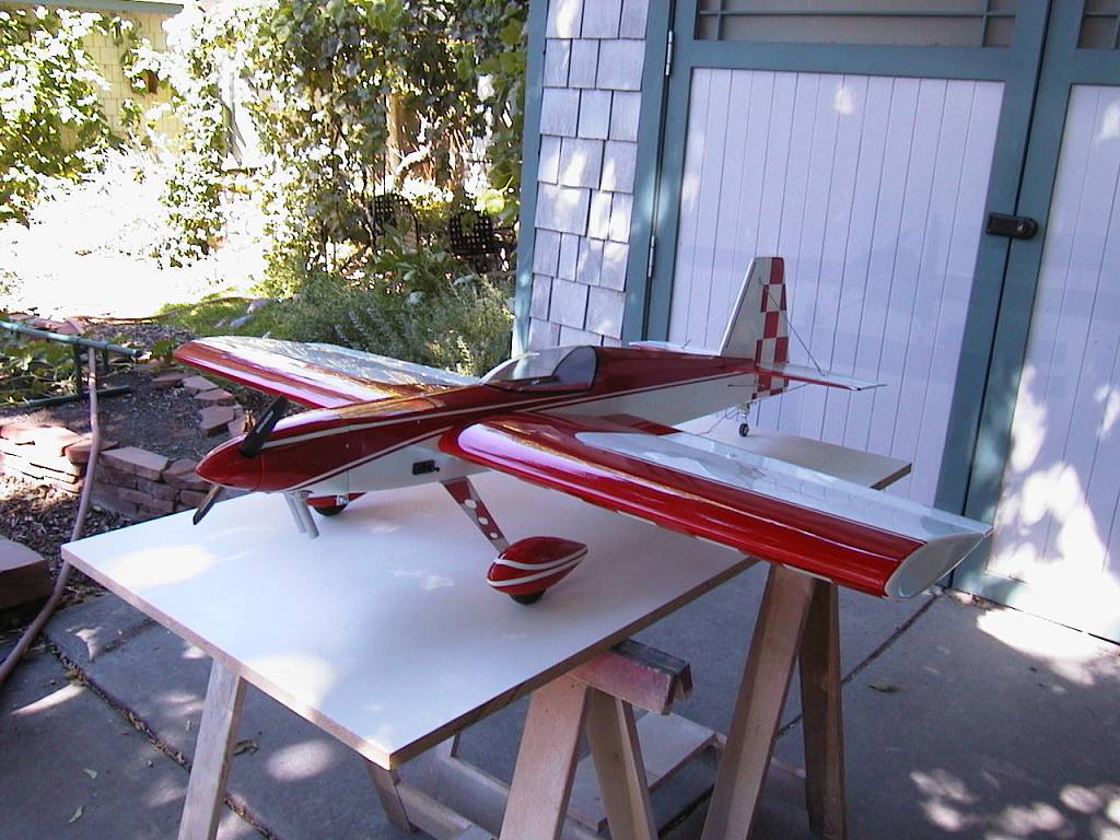

Nice plane collection Mike. You've been very busy! I'm not quite sure what you're looking for in performance. More acrobatic? More speed? I admit to building heavy myself, but my modified Somethin" Extra was noticably faster than other SSEs I've seen, which I attribute to the FG cowl. The plane only had an ST .45 on it, so not too overpowered and a blast to fly. Mods included a fuel hatch, enlarged rudder and the cowl. Sadly, lost to an over rotated aileron linkage. May she rest in peace[]

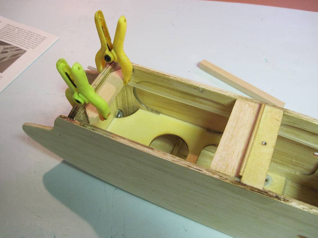

I made some decisions about this project. I am going to put a flat hatch over the fuel tank and use crossbraces for strength and for a place to bolt it down. I am sticking with the stock turtledeck as they look nice and blend into the canopy so nicely. I am going to make my own canopy hatch setup to blend into the fuel tank hatch. Hopefully I can save enough weight with the canopy hatch to compensate for the extra weight added by the fuel access hatch. Will post some photos soon.

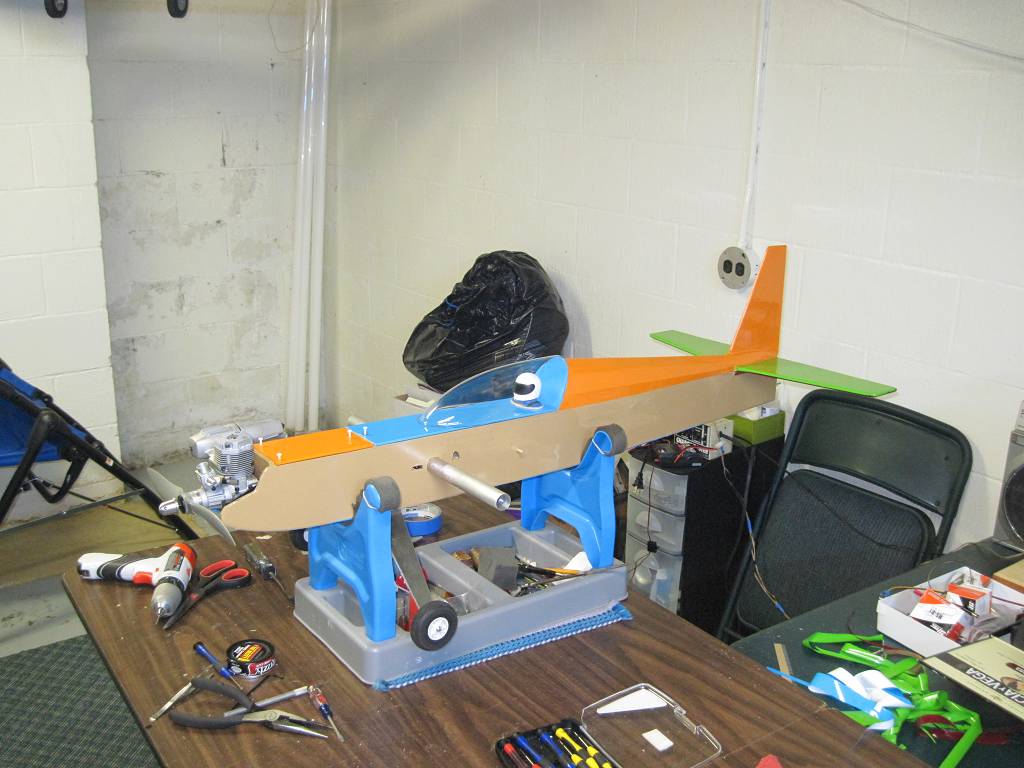

Here are some photos that I took of what I decided to do with the project. I am keeping the turtledeck. I added a flat hatch over fuel tank. Sig recommends against this because the glued down hatch adds stability to the structure. So I added two crossbraces for strength and to give me a good place to mount blind nuts and 4/40 nylon screws. Since I made the hatch flat instead of rounded, I also made the canopy flat and reduced the amount of pieces and weight considerably. New canopy setup is half the weight of first kit 2.5oz vs. 4.7.

More pics further progress, needing pintripes, stickers and some more assembly setup
