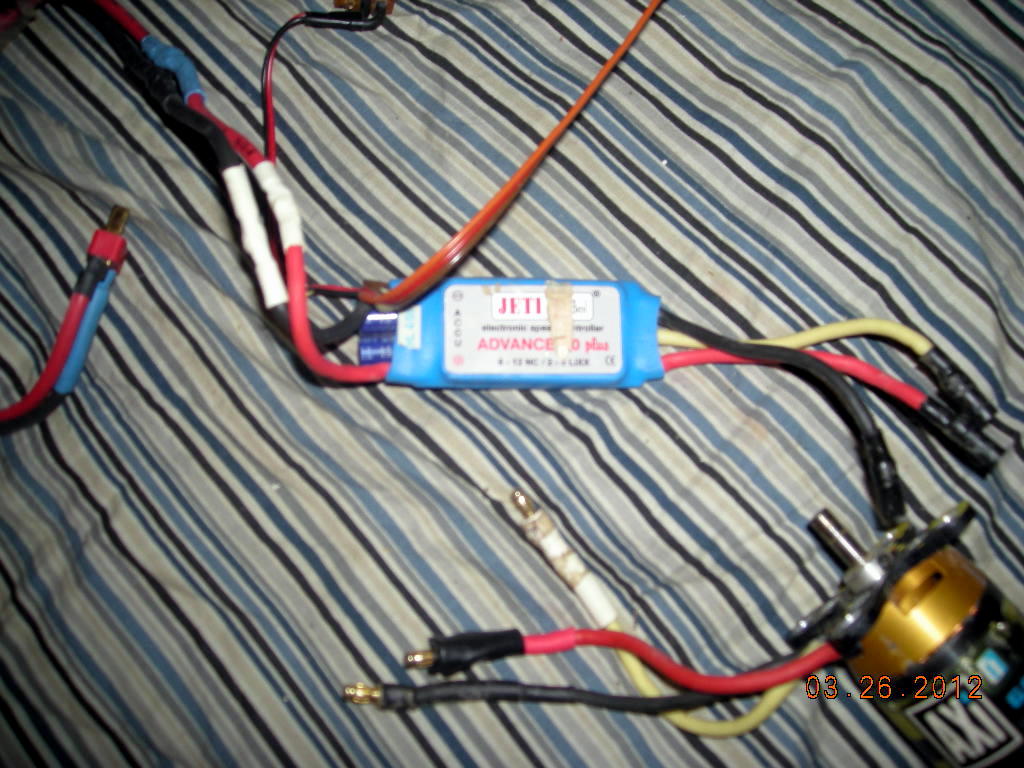

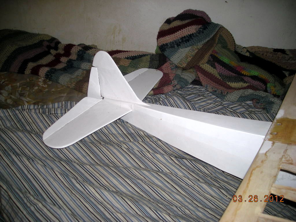

I was given a semi-completed plane that I would like to finish as an electric. I am not sure who the maker is but I do know it is an Air Scout, purchased by this guy in early 2000 I believe. I can not find any info on it as it has since been out of production for many years.
I have an Axi Gold Line 2826/12 motor, Jeti Advance 40 plus (40amp) speed controller, and E1280 prop I would like to use.
#1 Could someone confirm the model for me and possibly find a site or preferably a manual download?
#2 Please tell me that the motor and speed controller are not too big for it as I do not want to spend the $100-$200 for a new power package.
Thank you

Additional details: Wingspan 54", fuselage length 36 1/2", bolt-on wing, taildragger. Kit built, not an ARF.

Yes, it's an Air Scout from Ace R/C designed by Owen Kempen. Ace R/C sold them in the early 90's and I believe another company sold them even earlier than that. They were designed for 2-3 channels, .15-.25 2 stroke glow engines, with no mention of electric power. I bought a complete unbuilt kit off Ebay about 6 yrs ago and kit bashed it into a semi scale Piper Super Cruiser with 4 channel, less diehedral, cub style clear side windows, MDS .40 power (had to lenghten the nose to fit it in), wing struts, dural landing gear, bulsa cowl, and on and on with the mods.... It's a nice flying little plane that in it's stock form was sold as a trainer. I still have mine and fly it from time to time. The one you have looks like the builder changed the cabin windows into solid wood with window decals, instead of the all clear windows that the plans call for. I can't help you with electric power information but I can help you with other airframe information and specs. I still have my plans and building manual, what do you want to know ? One thing I would say is that IMHO you should base your electric power conversion on a .35-.40 glow engine not the .15-.25 the specs call for. A weak MDS .40 glow flys it well.

Thank you for that info. From what it says [link=http://www.hobby-lobby.com/brushless_axi2826.htm]HERE[/link] the Axi Gold Line 2826/12 motor is a good replacement for a glow .40-.46, so will it be ok?

Default RE: What kit is this???
