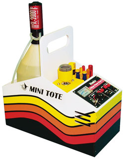

Default RE: Field Box
The SIG boxes are here http://www.sigmfg.com/IndexCatalog0903.html
Our box that always comes out of the truck is a discontinued Goldberg Mini Tote. No plans available but the design is simple enough a person could make something similar by looking at the picture. It holds fuel, pump, starter, battery, glow driver and a small screwdriver.
We have a plastic tool box, about 18 inches long, for props. A battery and field charger are in this box. It only comes out if we break a prop or need the charger.
We have huge Plano tackle box that has lots of compartments and drawers for tools and parts. It is very heavy so We always hope it stays in the truck.

I really really like your Mini Tote! If you have a chance will you take some measurements and close ups? Then share if RCU is up to it. [:@]
Fuel + battery +starter + "startup bench engine tuning tools" = nice-n-easy basic field box.
What is the gizmo on top of the glow fuel bottle?

I'll get some measurements. The thing on the bottle is a fuel pump. This pic is from the CG web site; my pump is screwed to the center upright.

Fuel pump.
That is a goldberg mini tote. Here's some specs. using these specs I built my own. Using your field items (battery, starter, power panel) you can TLAR it) http://www.philshobbyshop.com/catalo...sku?sku=GBG101

The box is at my brother's so I can't take pictures. I asked him to take a couple of measurements.
Bottom plate is 1/4 aircraft ply, 8 x 18
Center upright is 1/4 aircraft ply, 8 x 16
The rest of the panels are 3/32 or 1/8 lite ply
The sides are 8 inches at the center upright and 6 inches at the end.
The end where the fuel bottle goes has triangle stock in the corners for strength. The kit stuff is made of particle board, and I used it, but balsa would be my first choice.
The other end has an upright about halfway between the center and end, and a divider for the tool and starter compartments. Just be sure the starter will drop into its compartment. The tool compartment has 1/4 square sticks in the corners, about 6 inches long. The plate with holes for glow driver and other tools glues on top of the sticks. I might lower this by an inch if I was building another.

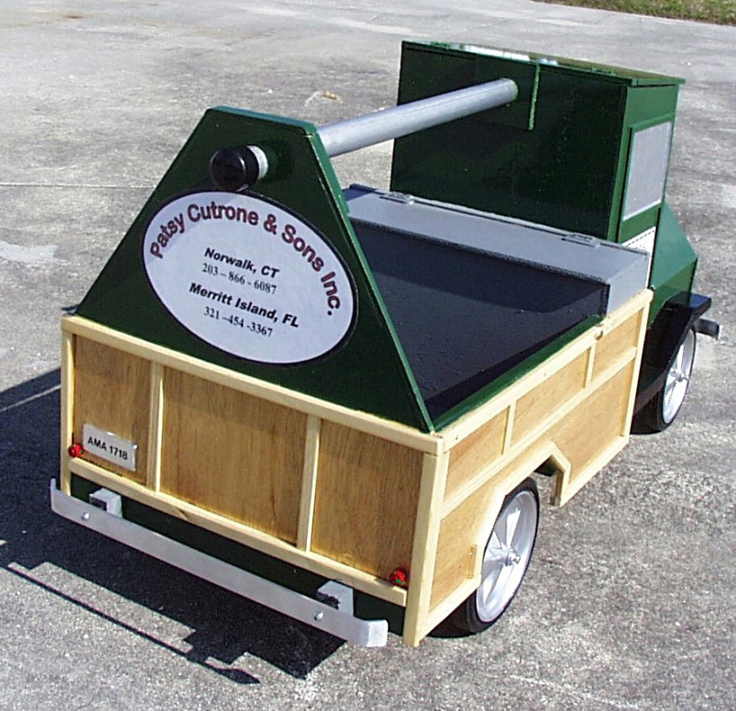

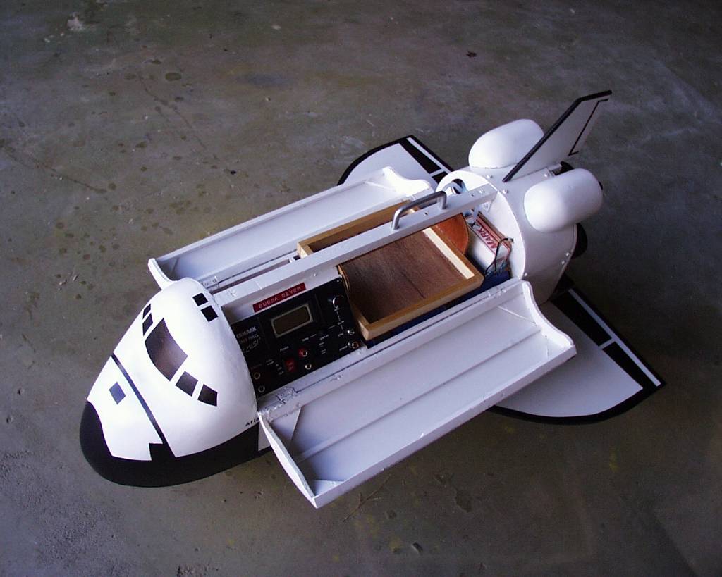

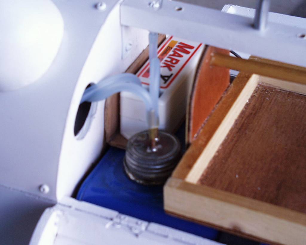

My field box ideas
Old 05-01-2012 | 04:16 AM
Posts: 387
From: Cocoa, FL
having problems with uploading pix

Those are great Tom, very original... You need to put a drive motor on them and use a radio to drive it to the flight line, with it pulling your planes.. That would sure turn some heads...lol

ORIGINAL: tom czenthe
Tom,
Those field vehicle cannot be called field boxes.
They are beautiful and so imaginative.
Yes they need self propulsion and pull your model to the pit area.
Congratulations for a super achievement.
