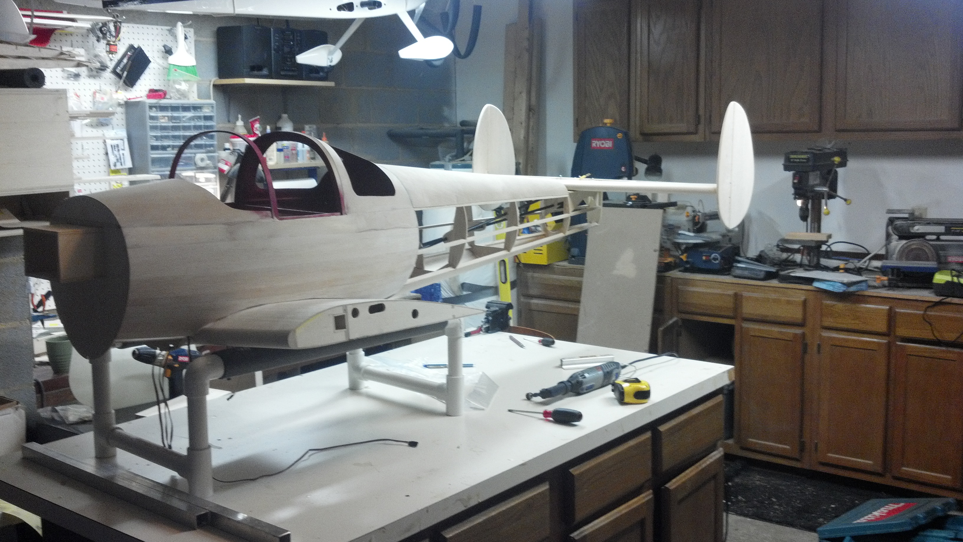

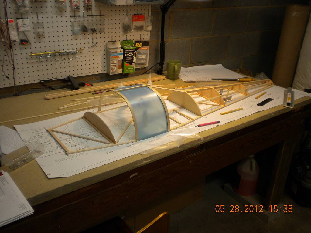

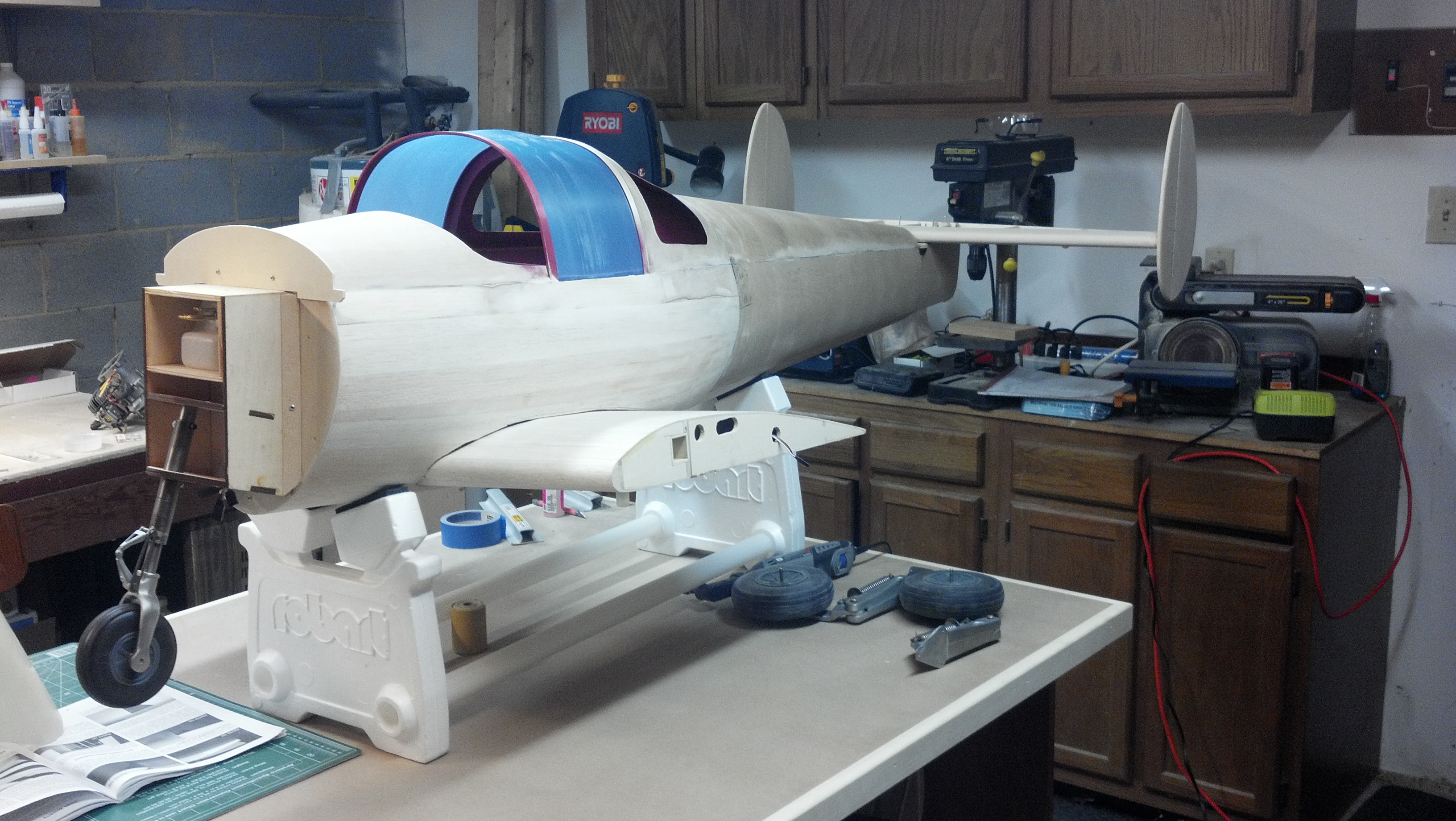

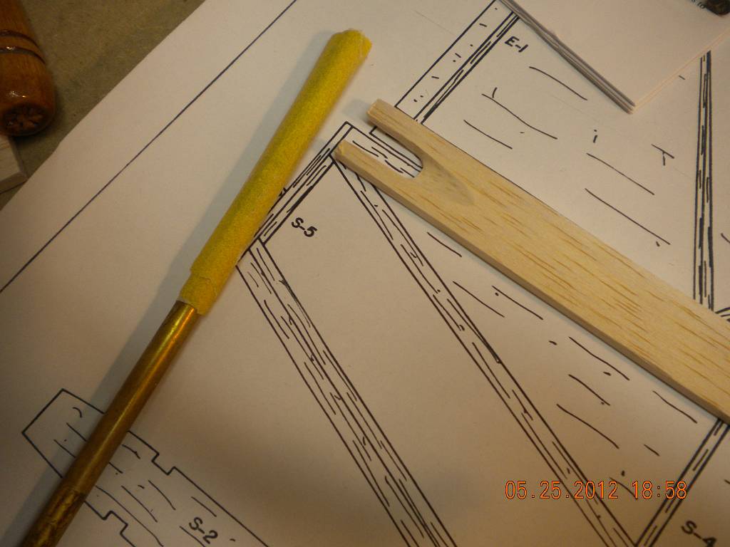

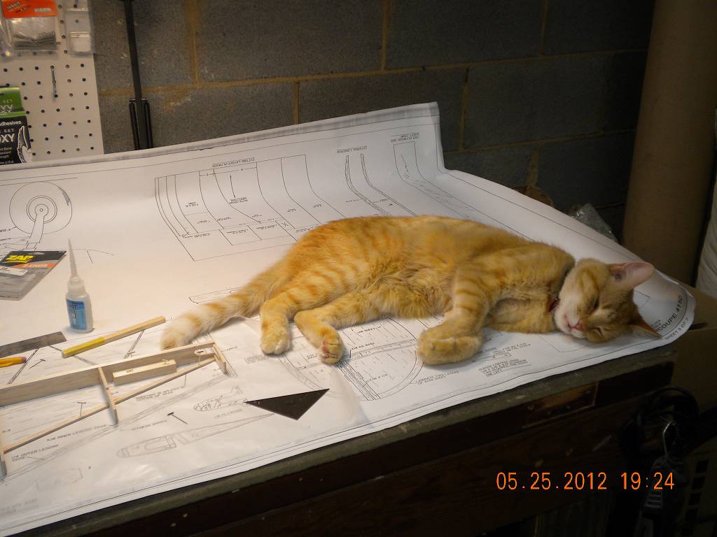

I started with building the wing tube receiver boxes. Then I moved on the main center section spar. I went as far as I could go without the gear legs.
I changed plan sheets and began building the horizontal stabilizer and elevator. As you can see, my assistant fell asleep on the job again.

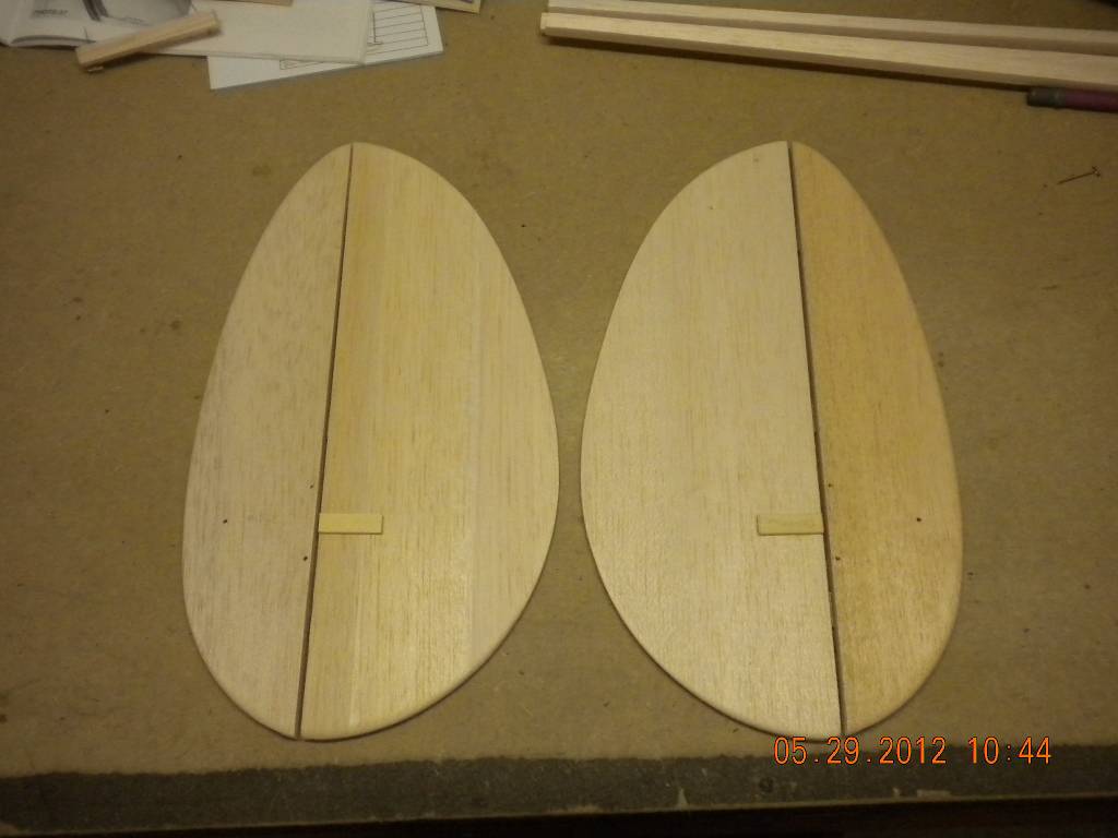

After those were done I started on the vertical fins and rudders. That’s where I ran into another problem. The skins for the rudders were there, but I spent 30 minutes looking for the skins for the fins. Finally I figured out that the fin skins in my kit were not already cut. They were supposed to be. The wood matching the right size was there but no fin skins. Not a big deal though, I just used the plans and cut them out myself. Once they were built and hinged I moved on the fuse.

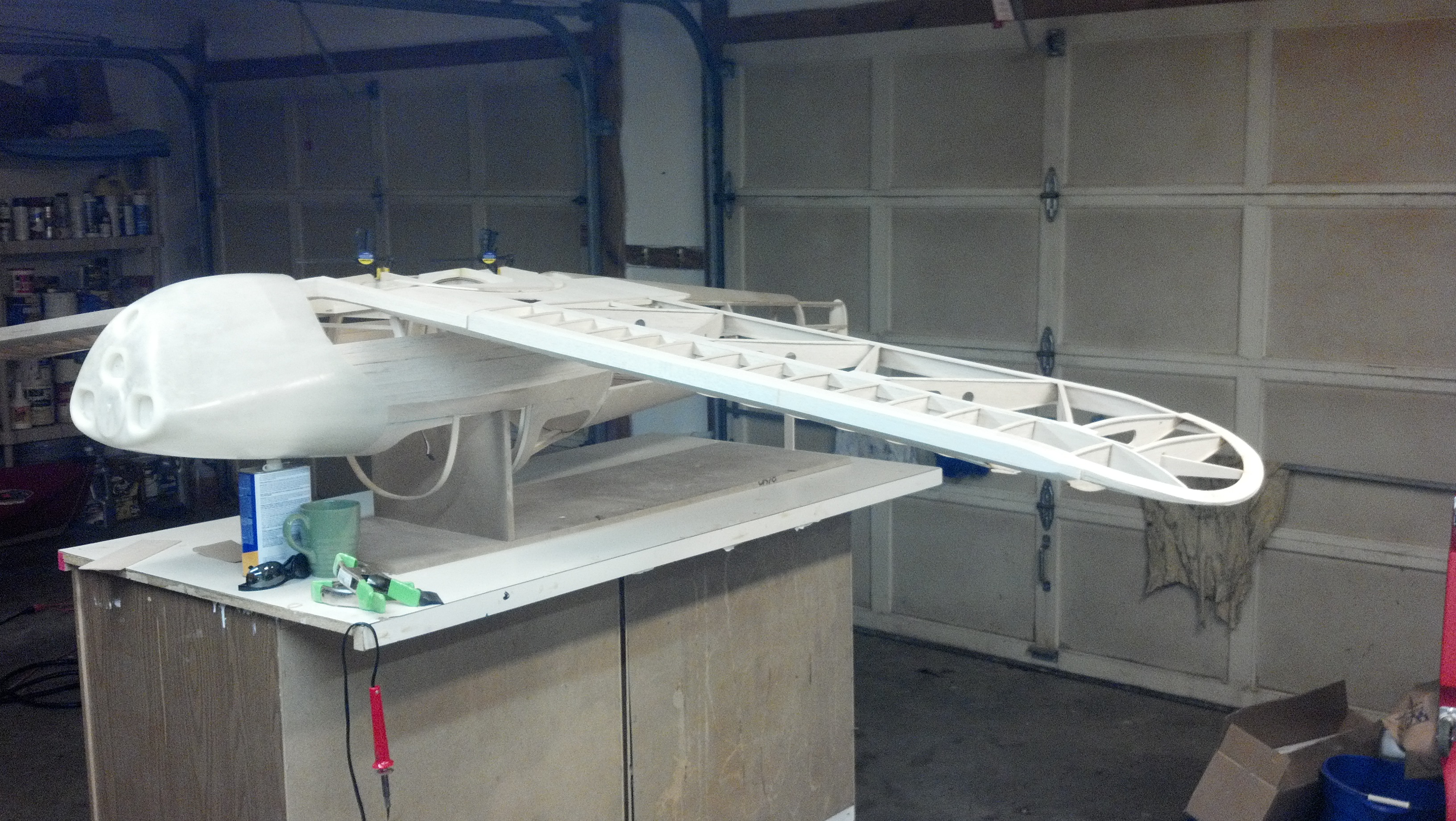

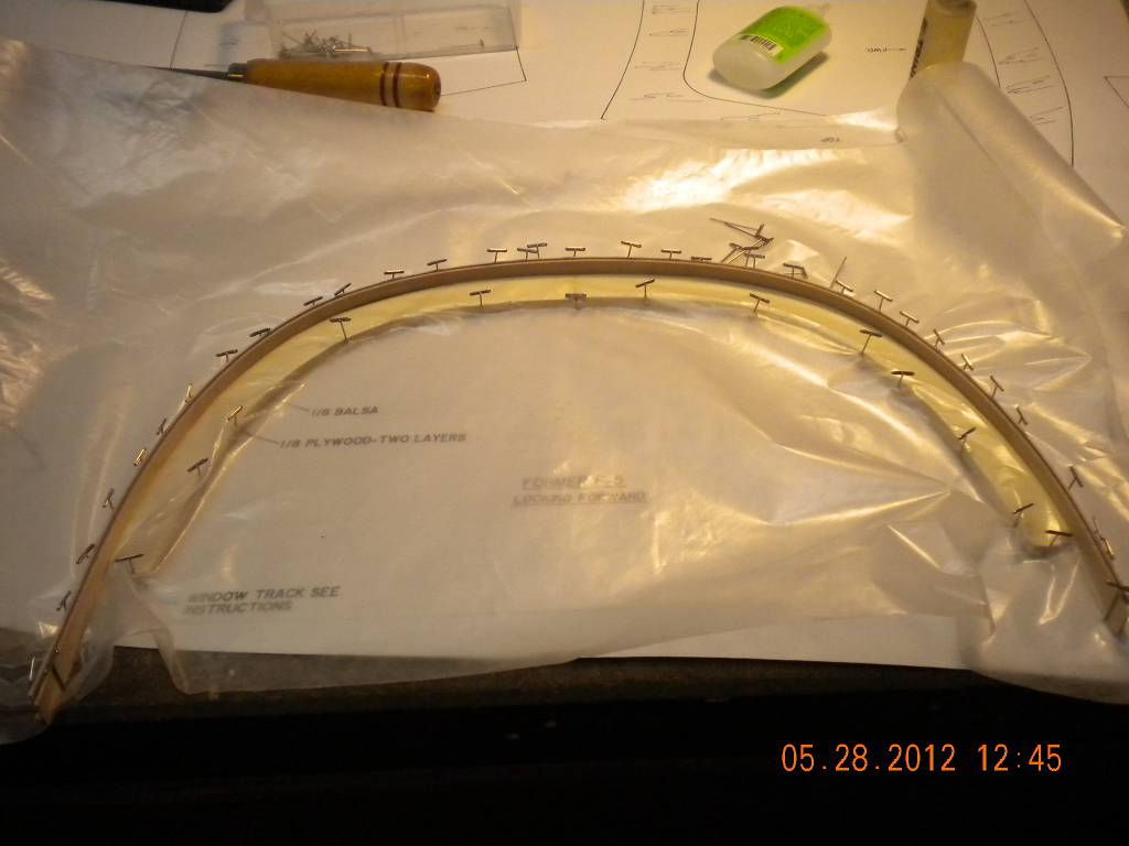

I laid out the main crutch, added the cross members and cross bracing. I built the window tracks and installed the formers. I used the actual window to make sure they would slide up and down smoothly by keeping the correct distance. I made sure all of the formers were 90 degrees to the table and added the stringers. I sheeted he turtle deck with the special .025 plywood. I have not sheeted the forward section yet, because I’m planning a few things on and behind the instrument panel. I will make a special brace to hold that section square and straight when I start to add the bottom formers.

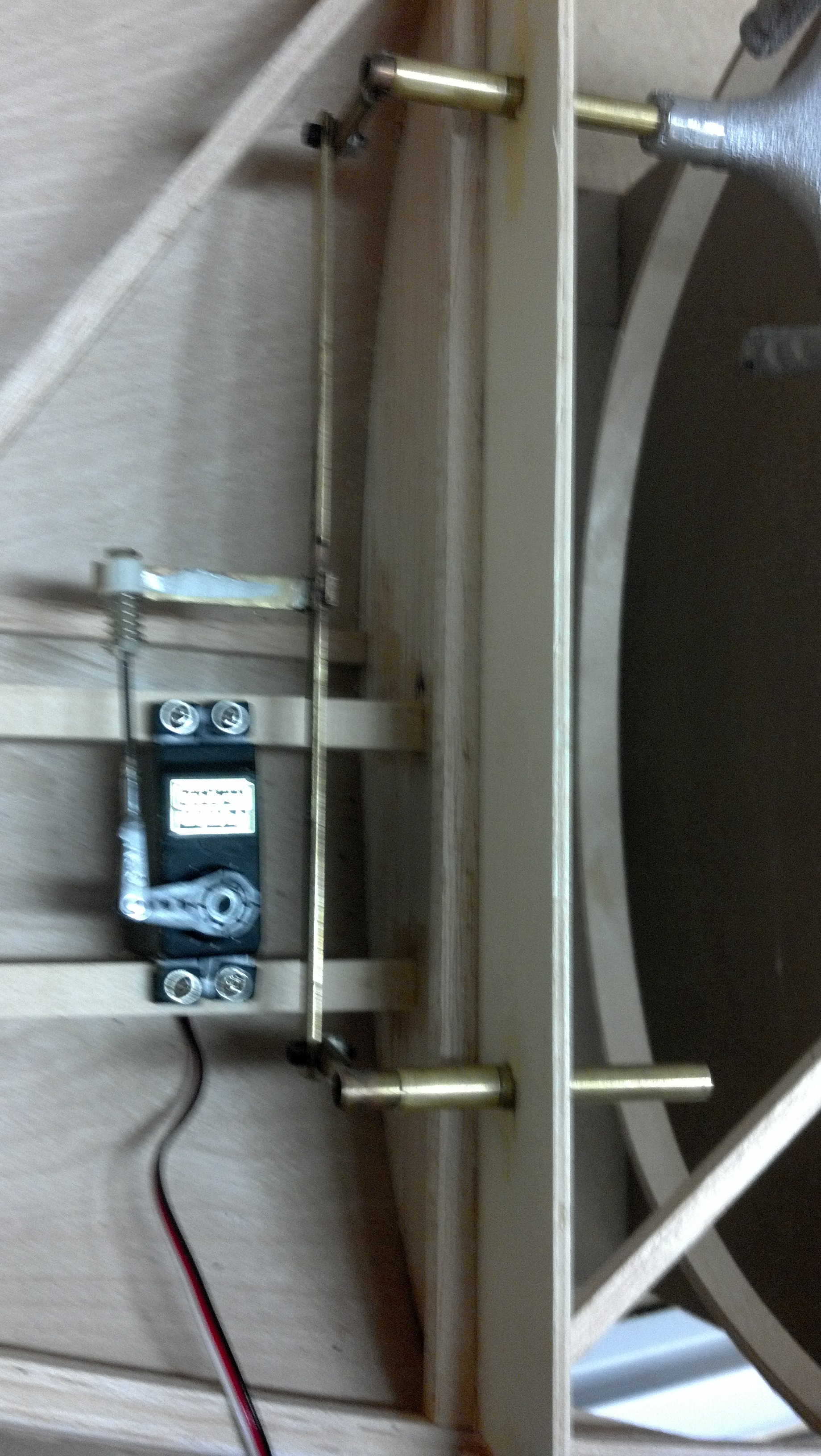

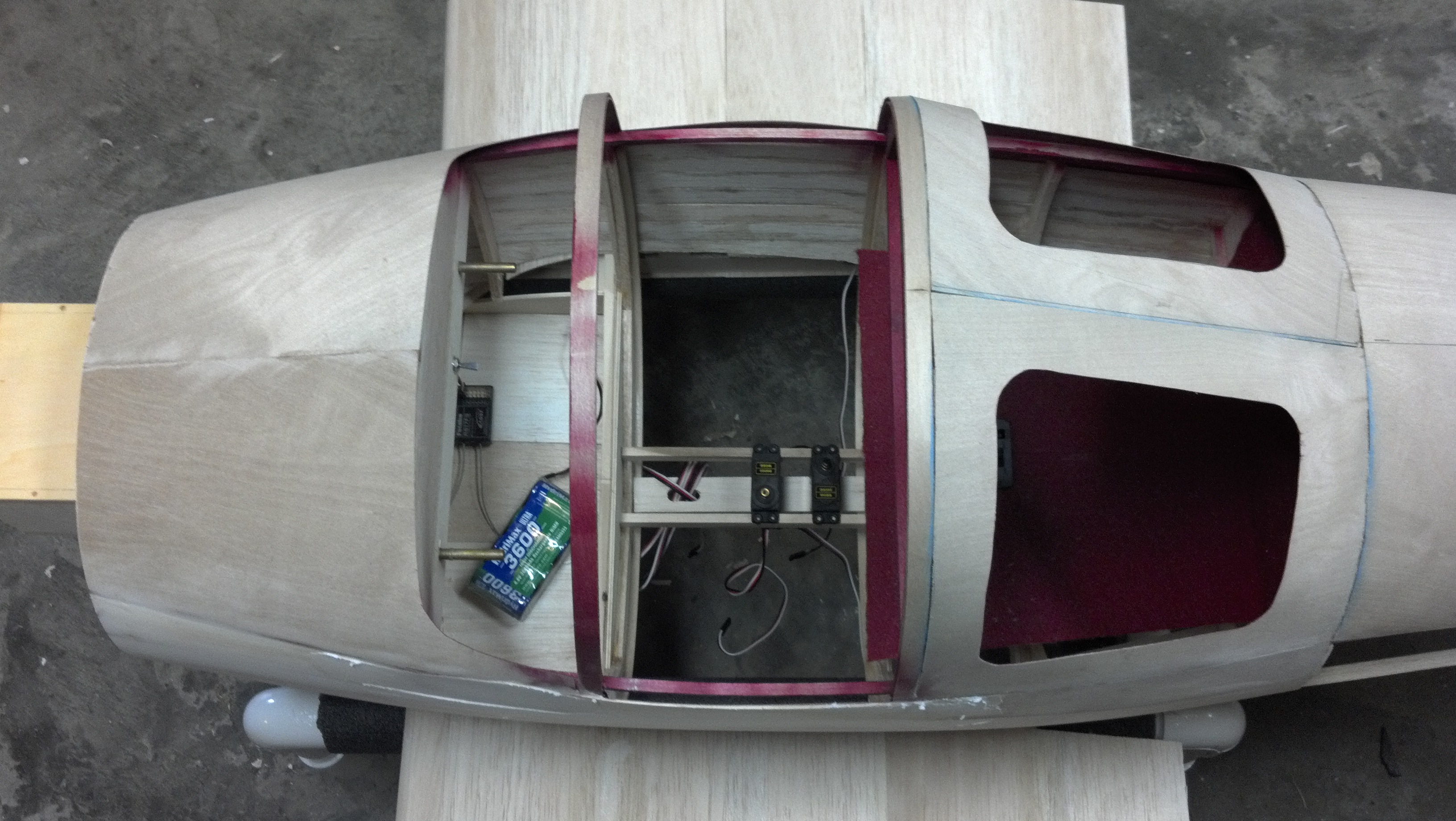

Alright Guys,
I'll post some more pictures over the weekend.. If I can manage the time to get my stuff together. I have a few I can post now.
And the Full Scale I'm modeling...

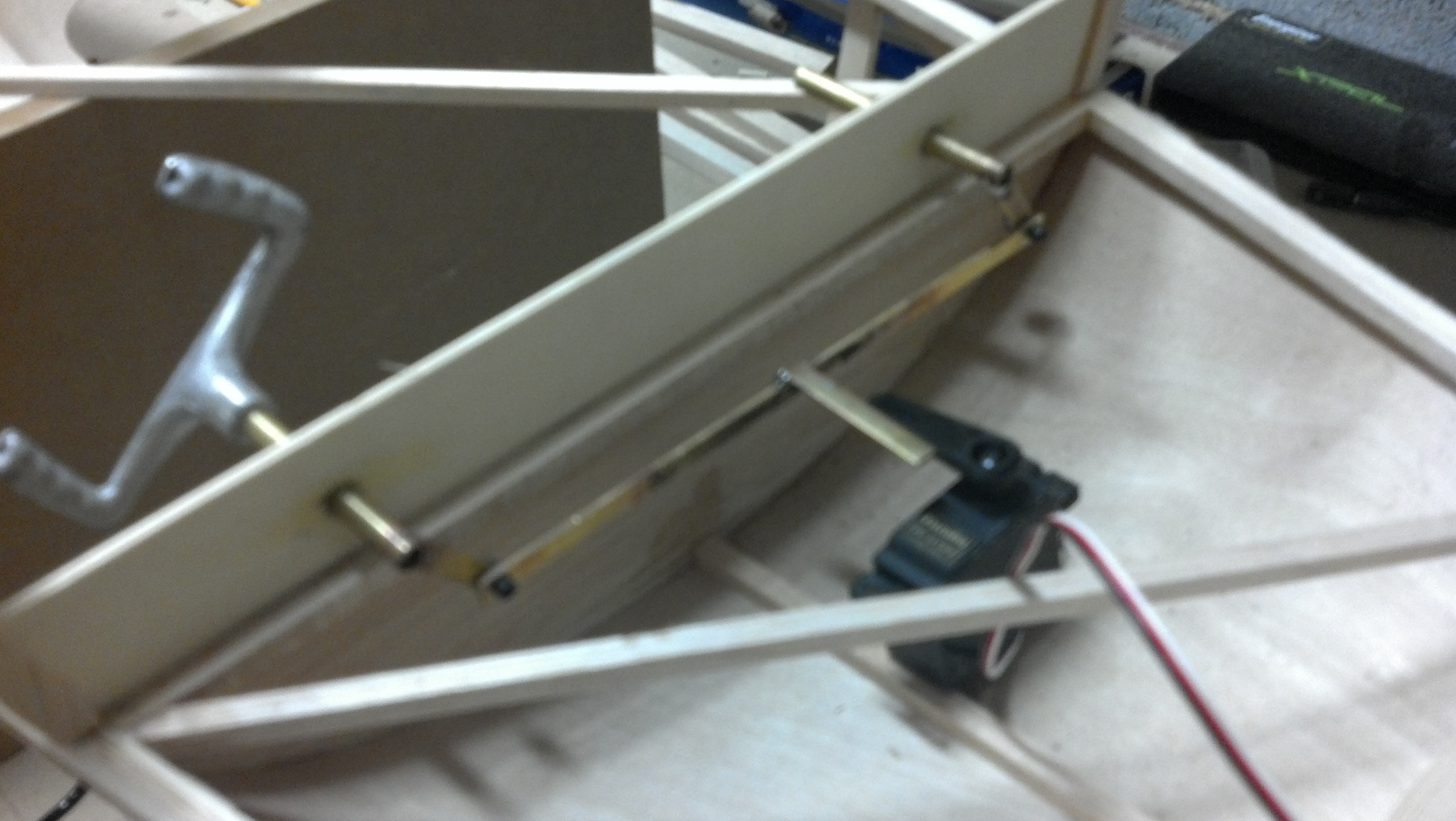

Oh Yeah, I forgot.. I connected the control yolks to a servo to turn with the ailerons.
Mike

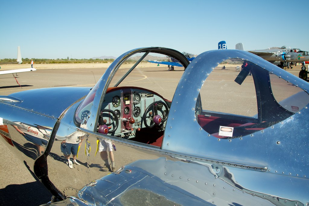

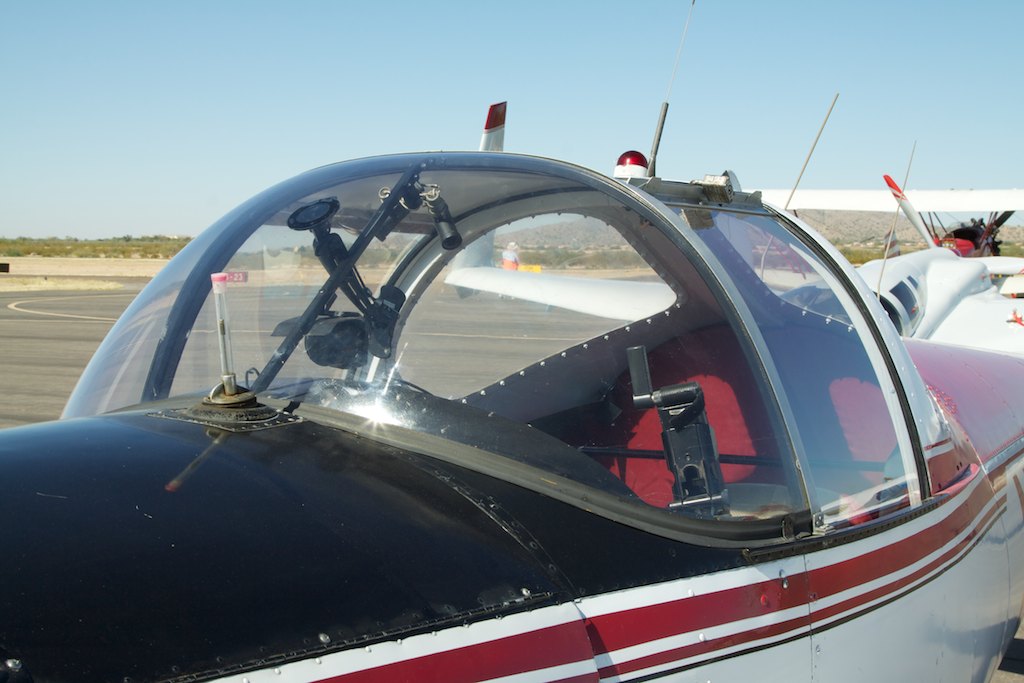

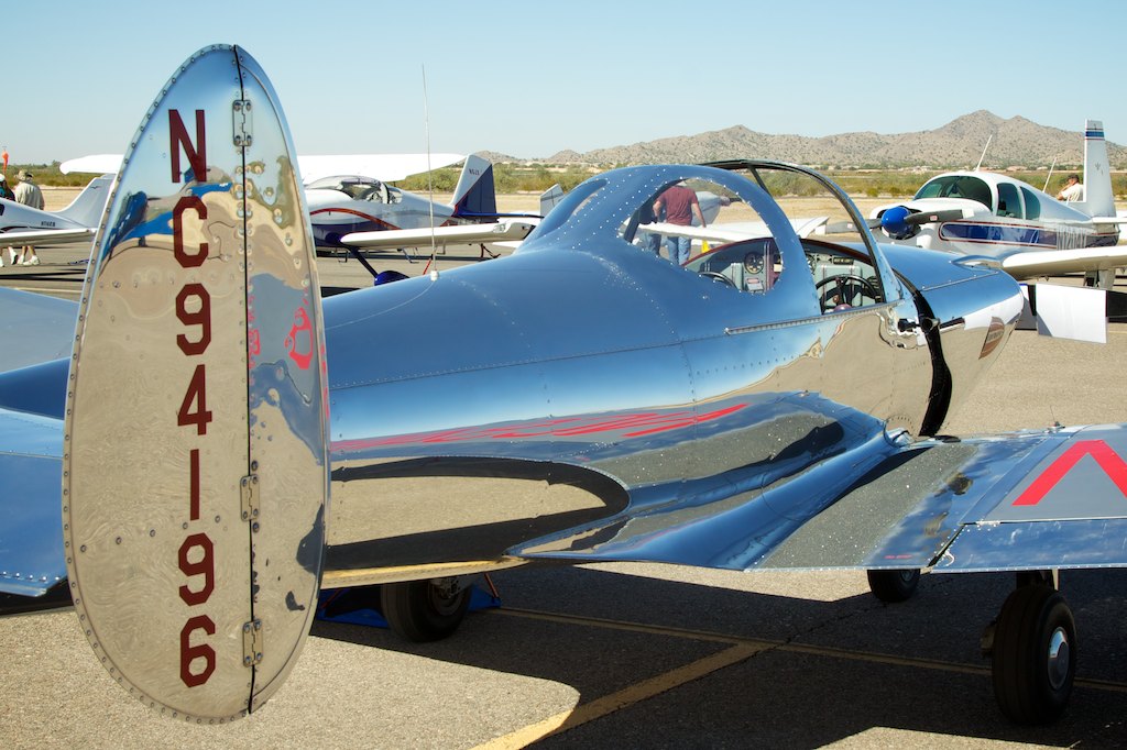

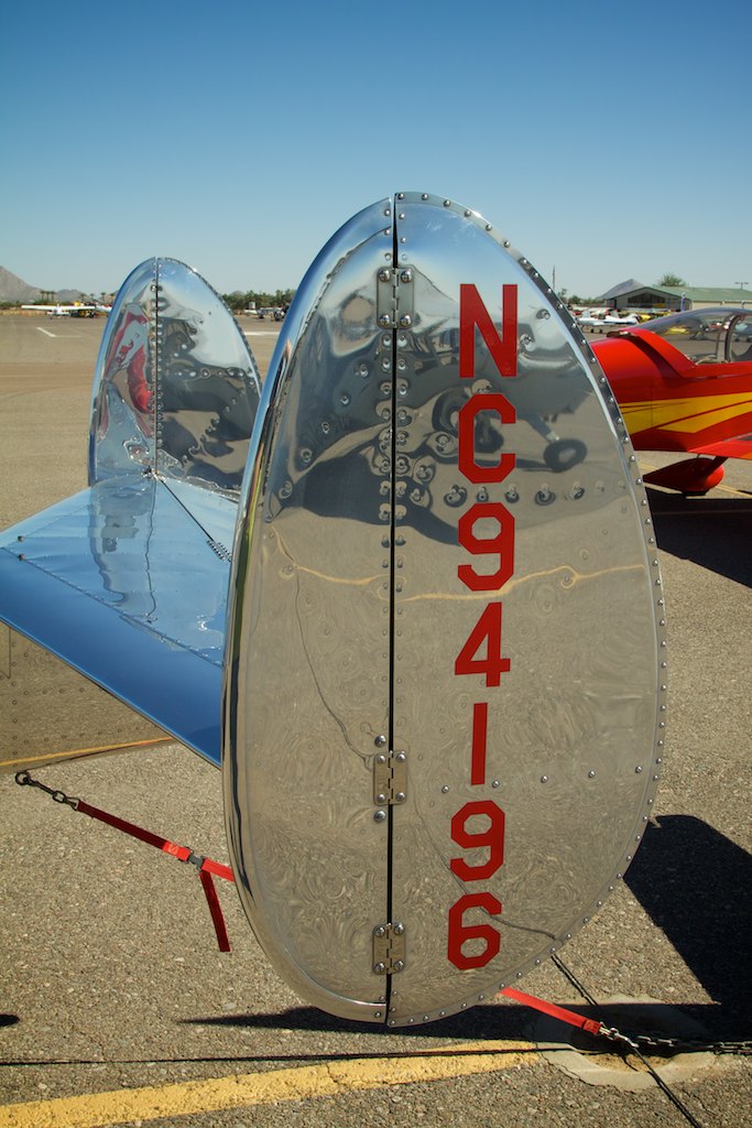

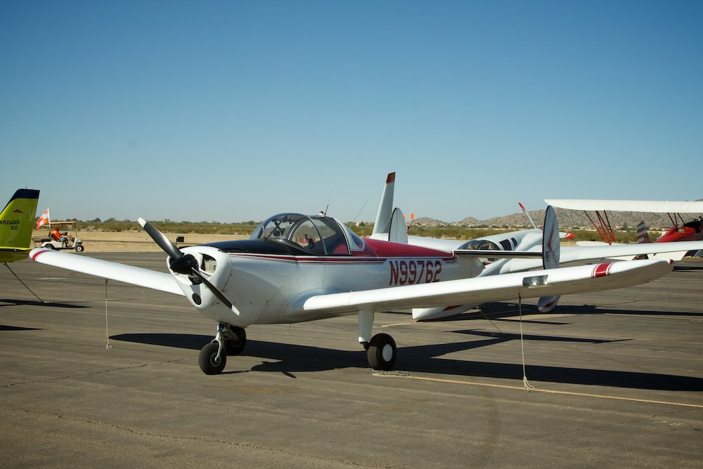

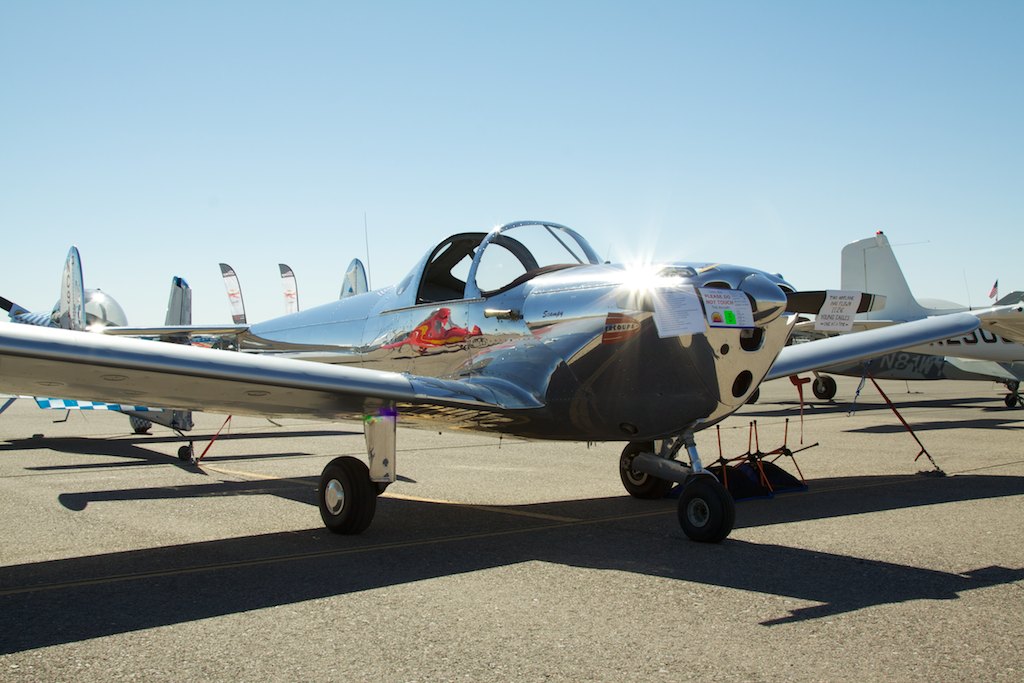

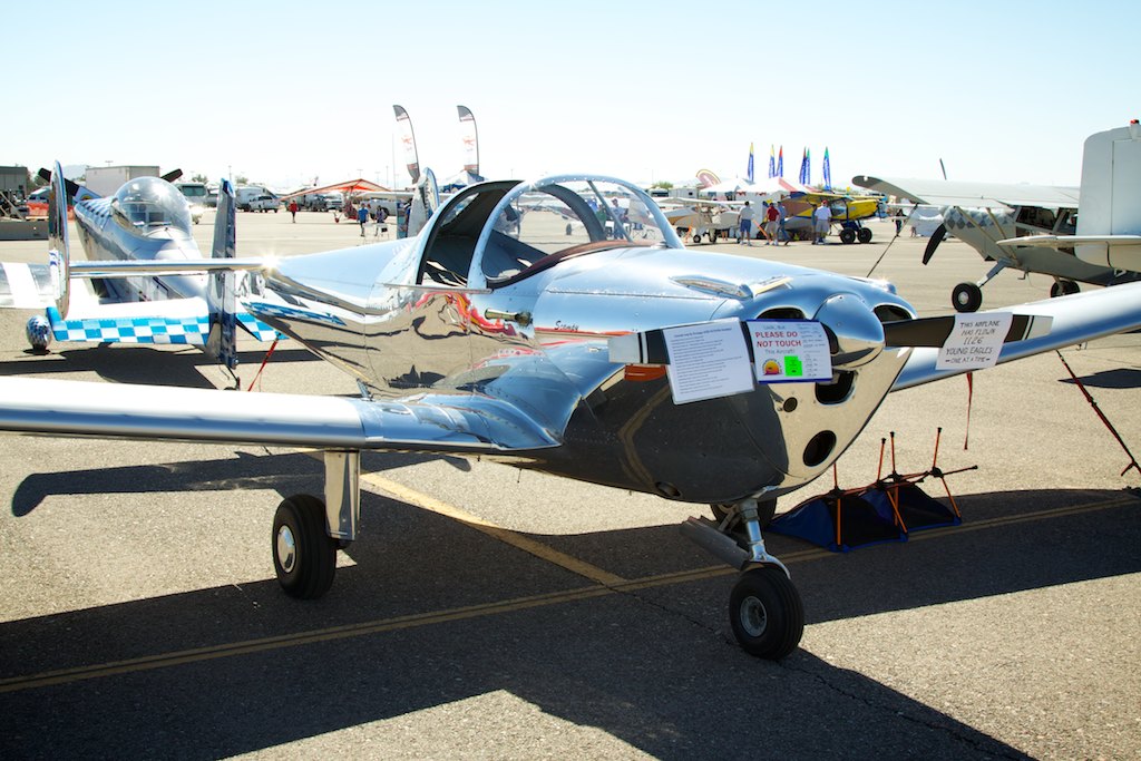

I went to a local fly-in yesterday and there were two Ercoupes there. One was simply amazing, all polished up.
I member at our club has the Balsa USA Ercoupe, really nice flyer. You'll really enjoy it.
