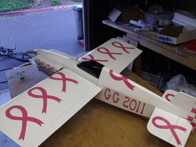

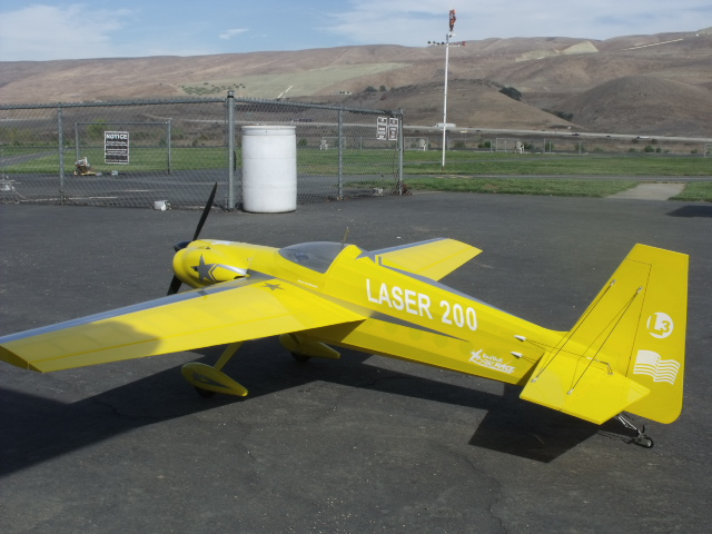

The wings I sheeted with GG were done in a vacuum bag. The bagging process removes much of the humitity so it foams much less. Here are the two airplanes that were sheeted with GG.
