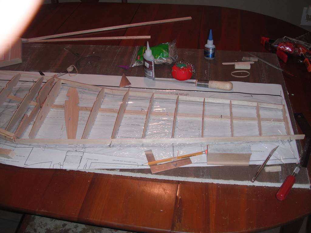

Are you talking about the P-51A kit?
It goes under at the last rib. I split the difference, and put half under each wing tip. Just the way I do it.
Pat

Old 08-09-2012 | 03:23 AM
Joined: Feb 2012
Posts: 8
From: Lehighton, PA
Default RE: Top Flite Redbox P-51
Yeah the A kit and thanks I kinda thought I had to cut them now i can cut them apart and do it again LOL
Oh well Its all good.

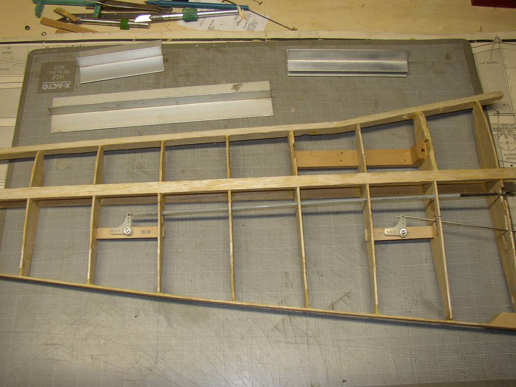

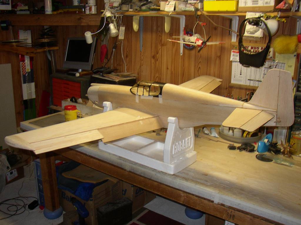

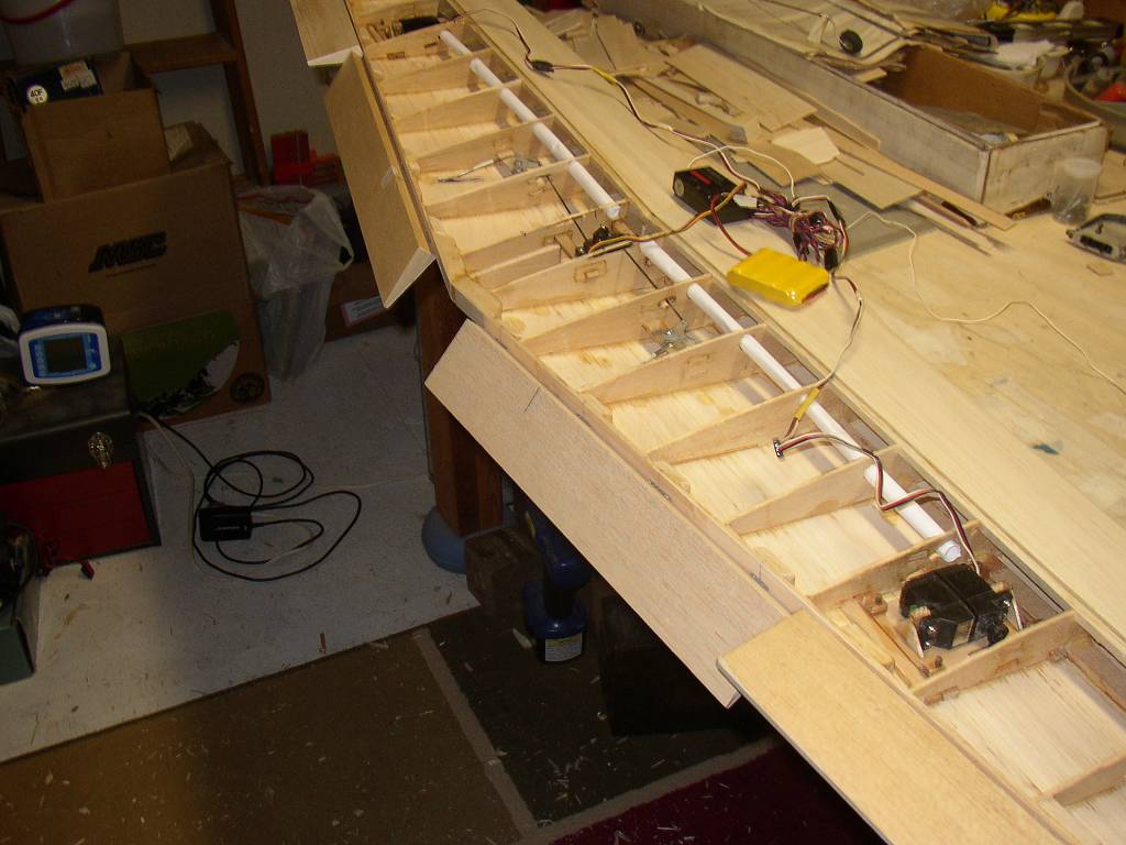

Do yourself a favor and don't use the belcranks on the ailerons. I almost did, and I'm glad I was talked out of it.( after I had the wings halves glued together, and all sheeting on, except the top back half.)I've never had a problem with belcranks, but if you do or they wear and get loose, you'll have to cut open the wing to fix them. Plus their more positive, and no slop. I still use the belcranks on the flaps, which work good, butwould have been better with servos there also.
Pat

Old 08-10-2012 | 05:21 PM
Joined: Feb 2012
Posts: 8
From: Lehighton, PA

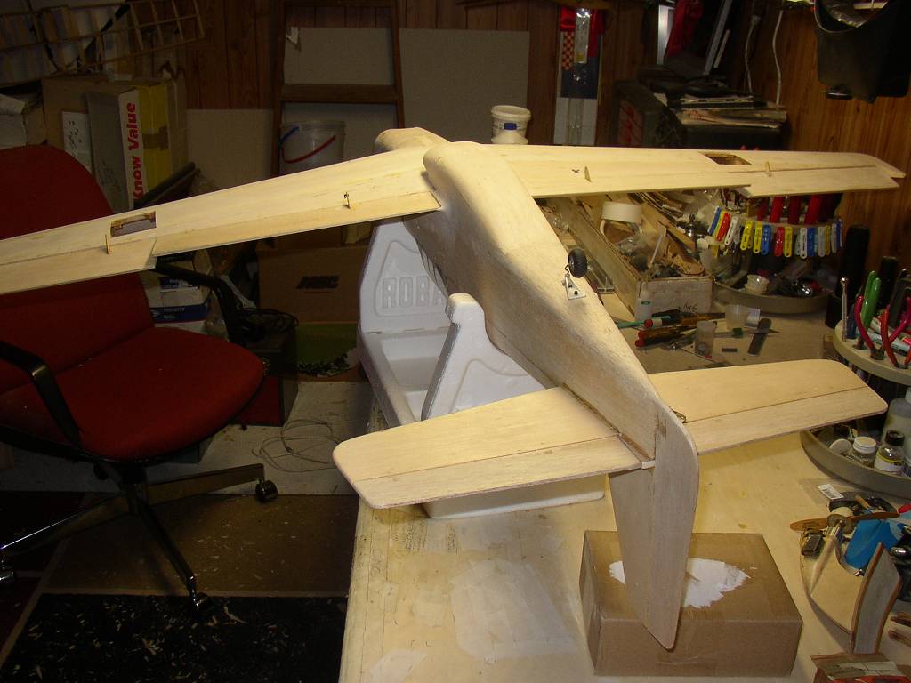

Thanks for that tip. I was thinking about doing the servo trick in the wing for both flaps and ailerons. Just something about sealing a belcrank in the wing just doesn't sit well with me plus it will give me room for my retract servo and valving in the wing.
Old 08-11-2012 | 02:19 AM
Joined: May 2010
Posts: 241
From: Deer Lodge, TN

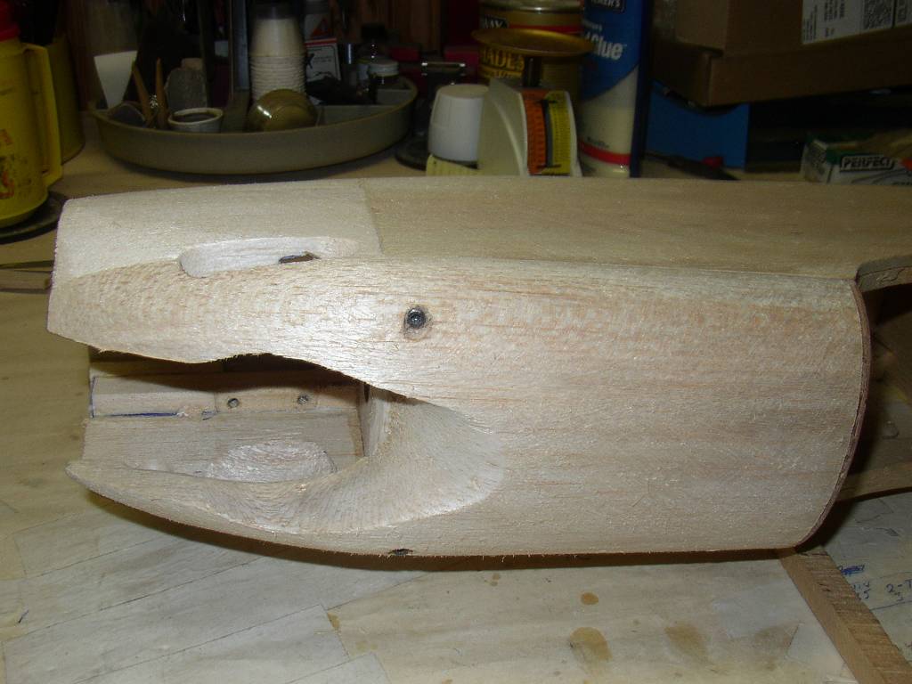

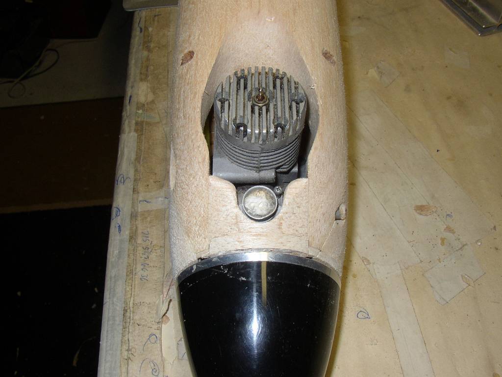

I wish I had put retracts in this one, but I was just rebuilding one I bought at a auction, that was basically destroyed by the builder on the bench! I have a build thread on this plane, if you search for "TF P-51" you'll find it. If I decide to keep it and not sell it, I'll open everything back up and install them....Maybe. It's no big deal for me to do, I enjoy building &amp; rebuilding.
What motor are you going to use in it? Ialso made the bottom of the front of the fuse removeable, to remove the engine, and to get at the tank any time.
I also moved the tail wheel, and it's steerable.
Keep posting pictures of your build while you do it.
Pat

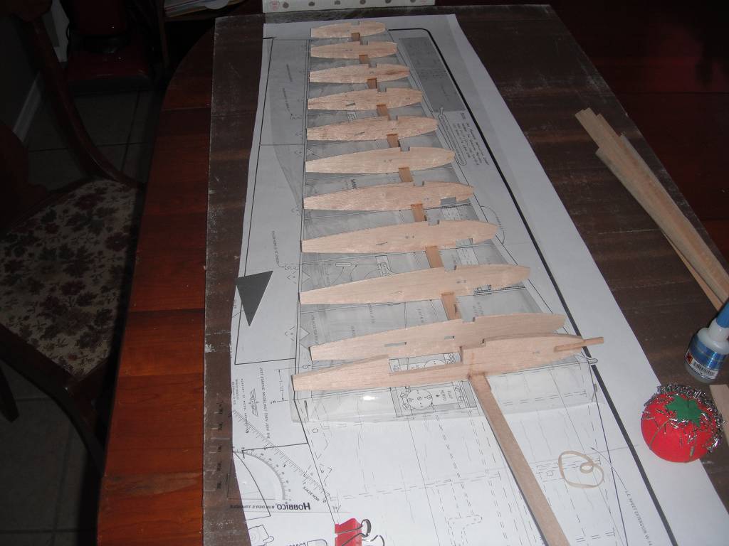

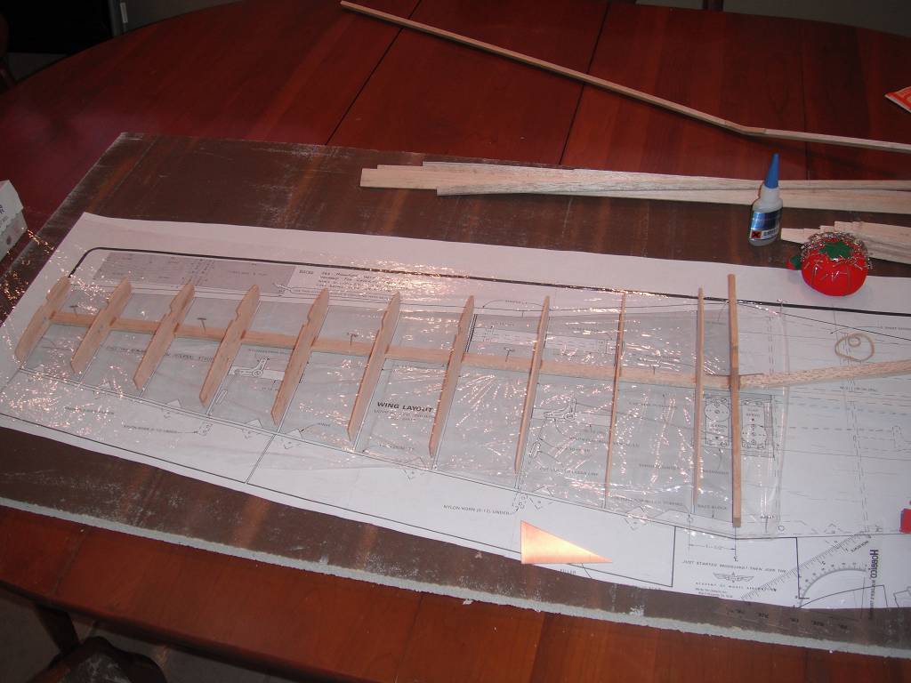

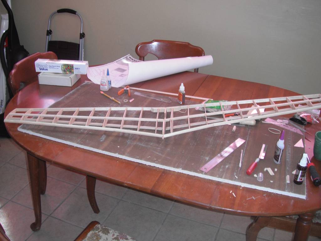

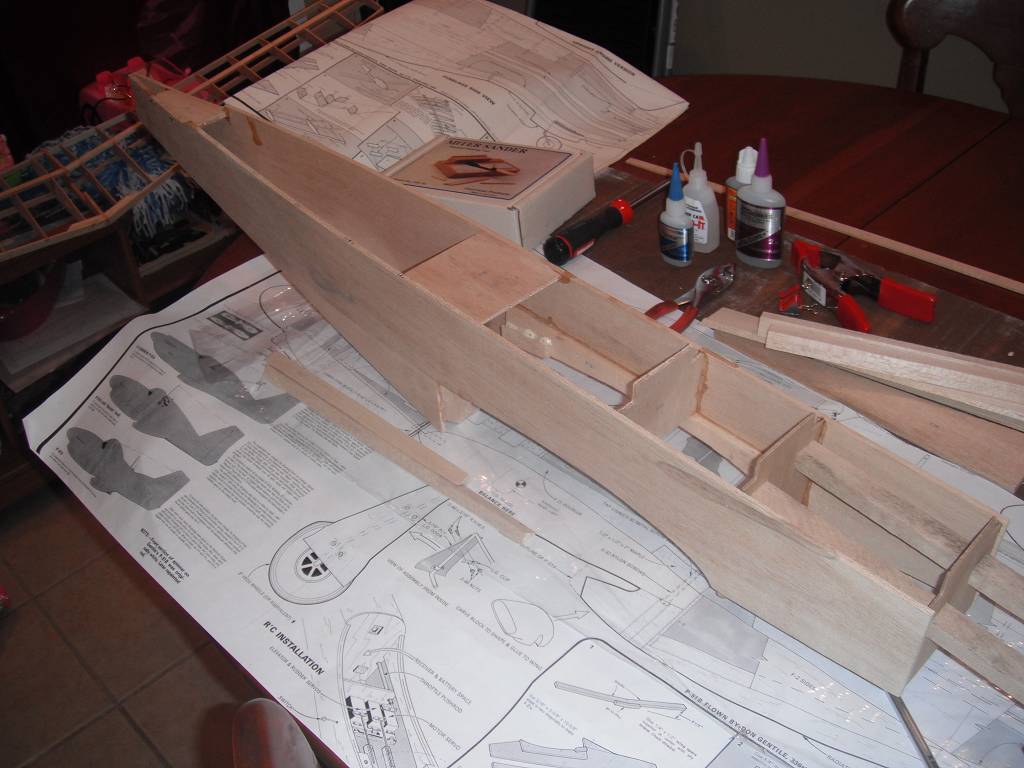

Old 09-08-2012 | 05:37 AM
Joined: Feb 2012
Posts: 8
From: Lehighton, PA

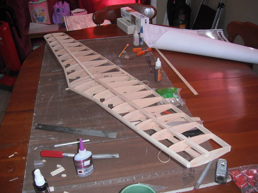

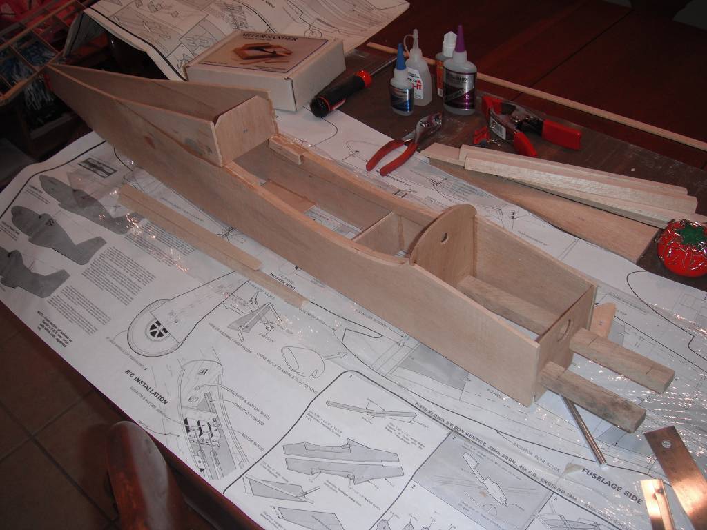

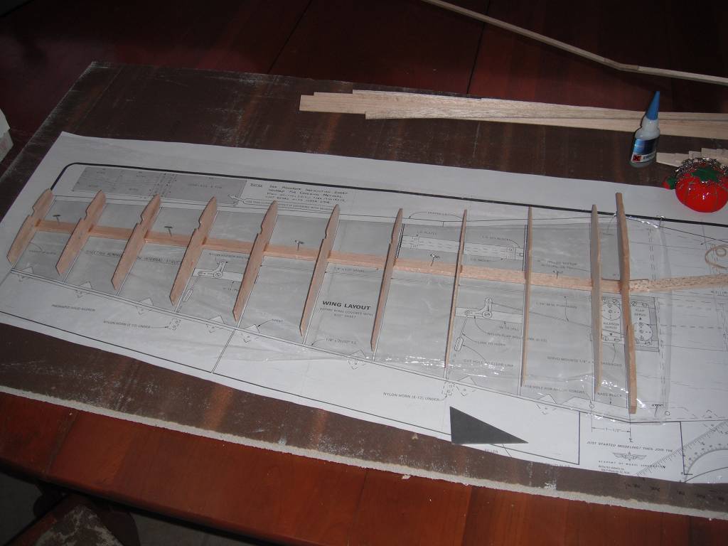

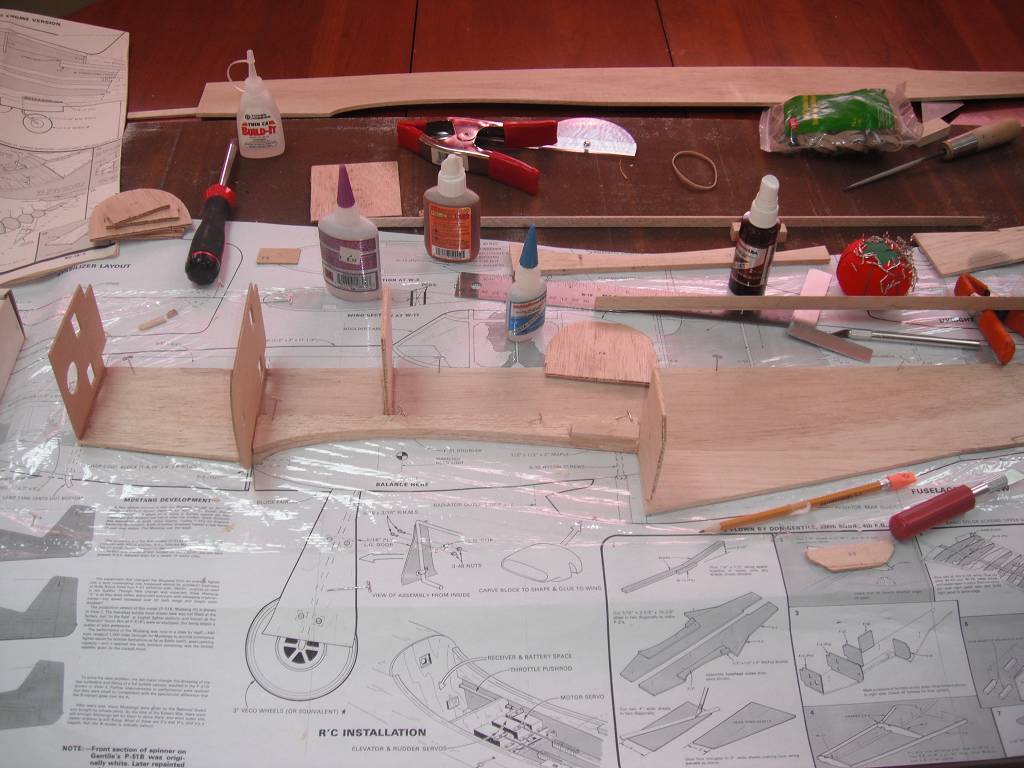

Hi Pat
Been slowly working on the kit and here are the pictures so far.
I picked up an ASP .61 off Ebay for twenty bucks that is very lightly used so I'm going to use that. Also i am going to fit the robart retractable tailwheel in to this beast (large crowbar) lol.
Bob

Old 09-12-2012 | 04:08 AM
Joined: May 2010
Posts: 241
Bob,
Looking good! No need to rush it. I have a Magnum .61 in mine. I didn't put retracks in mine, I should have. But I didn't know if I was going to keep it or not, and I was rebuilding it (put it back into a kit) at the time, to keep me buzy while I take of care my wife in the next room. But now I like it, and wish I did use retracks. Thats the only thing I would change.
When I was movingthe tailwheel forward, I tacked glued the bottom onand then formed the fuse to it's shape, and then popped the bottom off and then mounted it.
Keep posting pictures of your work!
Any questions, just ask, mabe I can help on a problem spot.
Pat
