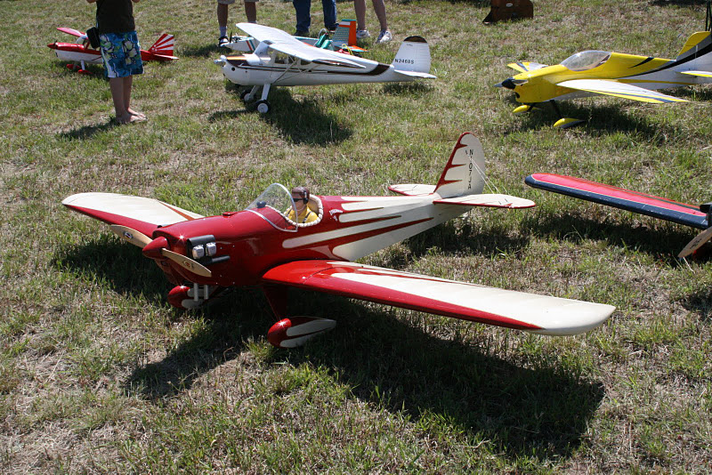

Paint will crack, chip, whatever, if the substrate is improperly prepared, or if it is flexing, itself. The paint isn't the problem, the preperation is. Stress cracks come from the substrate, not the paint.
As far as fuel resistance goes, I have better luck with Rustoleum, but Krylon does a reasonable job.
A good finsh can be produced when using rattle cans. Surface prep is the key, as it is in any paint job.
In these pics, both models were painted in Rustoleum.
The Cessna was painted using an HVLP gun, from paint available in quart cans.
The glow powered Cub, was painted from spray cans.
On both models, the fiberglass parts were primed. No open bay areas were sprayed with primer, as they flex, and the primer would crack. Rustoleum, Krylon, etc, are all flexible enough to spray over open bays without future problems.

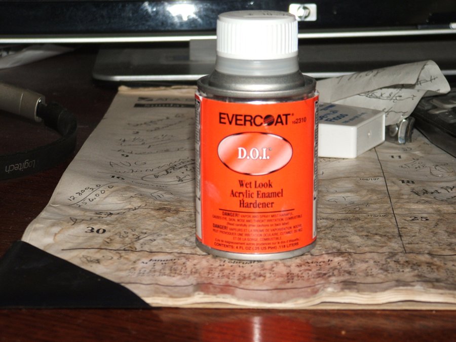

I use an automotive hardener, with my Rustoleum. It improves gloss and decreases the dry time.

Two differant animals, surprised it works. Acrylic hardener is meant for acrylic enamel. Unless Rustoleum has changed over the years it is alkyd based would require an alkyd hardener.
The guys at the auto paint store said the same thing. They were interested, though, when they found out that it does work.
I'm a paint guy, having been in the manufacturing end for over 30 years. I'm not big into adding unknown additives in to my paint. I was hesitant to try it, but a couple friends had success with it. I tried it only after their success.
Rustoleum says that their paint can be thinned with acetone or mineral spirits.
The mineral spirits is not strong enough to cut the hardener. The resulting paint job is terrible.
The acetone cuts the hardener well, but the paint flashes off a bit faster.
I've painted three models in this manner. I'm quite pleased with the outcome.

Tom,
Is that an Isocyanate type hardener? Just curious now how it works. Used to be in the paint buisness a few years ago also. There are a lot of things you can do, but would never tell people because people tend to push the limits, and would never want to be responsible for some ones bad judgement or going against a manufacturers guide lines.
If acetone works it actually opens the door for other thinners also.

Interesting. Tom, what ratio are you using, paint to hardener to acetone?

I really don't know, Andy. I just know that it works.
I agree with people pushing the limits. That's why I try to thoroughly explain what I do, and show the products that I use. I am aware that any deviation can cause problems.
The Evercoat product does not have that distinct odor that many automotive hardeners produce. You know, that stink that permeates the air for weeks, in enclosed spaces.

What is the mixing ratio you use with the paint and hardner?

Steve, the can says 1 can to a quart. That's what I do, although I usually mix a pint of paint and a half can of hardener.
I don't mix it to the acetone, but to the paint.
I add the hardener to the paint, and then thin with acetone.
No set ratio of paint to acetone. I thin to the consistancy of milk. I probably start at 2 parts paint, and one acetone. I test spray, and add more solvent,if necessary. It could easily end up as a 1:1 mix.
