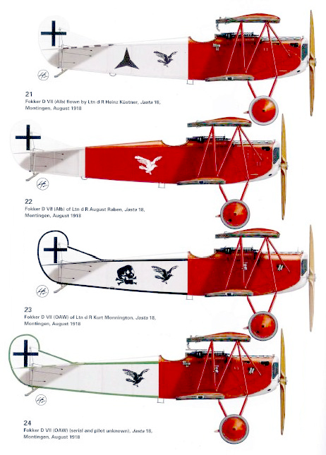

And Jeff, that is one beautiful bird. I am still undecided on what scheme I want to use. I was thinking of one from the Jasta 18 group. I just need to find some documentation on that group so I can make a final choice.
Any ideas which book would be best to use??

For Jasta 18 planes I would go with Osprey Publishing "Jasta 18–The Red Noses " by Greg Van Wyngarden. It is full of great information on the Jasta 18 fighter group. Plus lots of photos and color profile and plan forms for excellent documentation. This book is number 40 in the Osprey “Aviation Elite Unit†series and it provides combat history for pilots such as Rudolf Berthold, Josef Veltjens and Paul Strahle and August Raben to name a few. I have not looked to see if its still in print. Nice thing about the Balsa USA DVII is that so many of us have built one, there is a lot of help out in RCU land.

For Jasta 18 planes I would go with Osprey Publishing "Jasta 18&ndash;The Red Noses " by Greg Van Wyngarden. It is full of great information on the Jasta 18 fighter group. Plus lots of photos and color profile and plan forms for excellent documentation. This book is number 40 in the Osprey &ldquo;Aviation Elite Unit&rdquo; series and it provides combat history for pilots such as Rudolf Berthold, Josef Veltjens and Paul Strahle and August Raben to name a few. I have not looked to see if its still in print. Nice thing about the Balsa USA DVII is that so many of us have built one, there is a lot of help out in RCU land.
Do you know if there are any that give more data on Ernst Udet and the planes he's used?? I've looked a little, but haven't found much yet.

If you want to read about Ernst Udet, two books are indispensable. Udet wrote his own episodic biography entitled Mein Fliegerleben, published in 1935. It has been twice translated into English. In 1937 a British edition, translated by Kenneth Kirkness, came out as Ace of the Black Cross. You may be able to find this old book via used book outlets or websites. However, in 1970 a new translation by Richard K. Riehn was published in the US entitled Ace of the Iron Cross. This came out in several paperback editions and should be easy to find on ebay or from used book outlets. I think the translation is very good.
Udet wrote (or perhaps dictated) a rather short and propagandistic wartime paperback memoir entitled Keuz wider Kokarde, published in 1918. It is very hard to come by and is rather expensive on the used book market.
The best biography of Udet was written by Armand van Ishoven, entitled The Fall of an Eagle; The Life of Fighter Ace Ernst Udet, (William Kimber, London 1979,ISBN 0 7183 0067 X). It really is a superb biography, well researched and nicely illustrated.
And of course the debate goes on about the DVII. Was it red or not?
