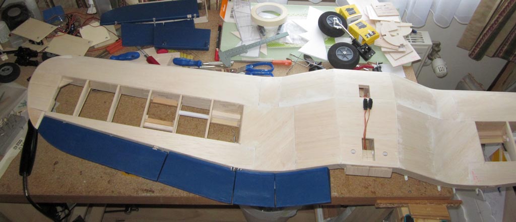

I didn't follow the plan when Ibuilt mine, on a 60-size plane Iused 1.5mm sheeting (instead of 2.5 or even 3mm ... can't remember what the plan suggested).
As can be seen, Ileft the part of the wing unsheeted.
Had a few mishaps during landings (even cartwheeled once), but the wing is still one piece.

Sheeting and glassing does add to the strength but on the Corsair I do feel it adds too much weight. {Who Said That??} I'm not usually a weight watcher but I have had the 60 size corsair that was sheeted and glassed for racing. I didn't build it but after flying one with open bays I decided the weight added much too much to the wing loading. The lighter plane was a lot easier to land.

There's no reason to add full sheeting to a structure already designed to be open bay. It will add strength, definitely....strength that is not required.And it will add weight which on a smaller model willreduce it's flight envelope much too much.
It won't help much to reduce damage in a crash. Quite the contrary, the sheeting extra weight may exacerbatethe damageand it will make the rebuild that much more difficult. You will likely have broken ribs in places that you can't see.
You say you are not concerned about the extra weight. You may want to learn to always be concerned. Let me try to explain something about model flight envelope. Lighter always flies better, handles better, lands better than heavier. Lighter and heavier are relative terms...what is meant is, lighter wing loading versus heavier wing loading. It matters none whether you are dealing with a trainer, scale, aerobatic or racer.
If possible, shoot for a wing loading of less than 30 ounces per square foot....24 will fly better than 30 and 20 better than 24,,,,
