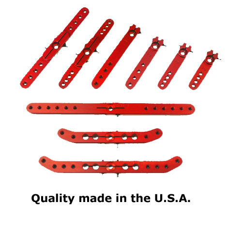

If crossed, the exposed part of the wire is significantly smaller & the exit hole in the fuse looks better (better angle for drilling) it just looks better IMO
Cheers, V.
P.S. if lines are metal, I use a piece of tubing where they cross. Even better, if possible attach the wires this way to the servo horn : one on the top, the other on the bottom. Of course that depends on the attach point type used. I use the ball link type that screws onto the s. arm so I can put one on top & one on the bottom, wires never touch
This begs the question Why doesn't somebody produce dual sided servo arms that are offset? Although (and this assumes perfect alignment and angles of hinges and horns, which is NOT going to happen in my builds anyway except by accident, HA HA) that setup would induce binding, albeit a very small amount, geometrically...

You mean like these... They make them for JR, Futaba and Hitec.
Bob
Bob
No I meant one side higher than center, the other side lower than center - so that if you crossed lines they wouldn't touch. Actually I have a couple of those and will be getting more. Way worth the extra cha-ching for the metal arms, IMHO.
